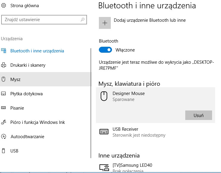

    Good day. Yesterday I disconnected the laptop from the power supply to transfer it and connect via USB to the printer. After this action, the mouse sections ceased.
    - I tested several wireless and wired mice, including bluetooth - none of them works.
    - the device manager shows mice as "other devices" (screen below), after clicking the details it shows the message: "drivers for this device are not installed. (Code 28)", this applies to all types of connected mice
    - Unfortunately, I could not find any mouse drivers for my Lenovo and Windows 10 models
    - USB ports are working properly, all other devices are recognized and working, except that the fact that the bluetooth mouse is not working also suggests that the problem is not USB
    - the touchpad works correctly
    Screen from device manager:
    Lenovo T430 - Mouse not working after USB printer connection, Windows 10, Code 28 - All types
    Please help.

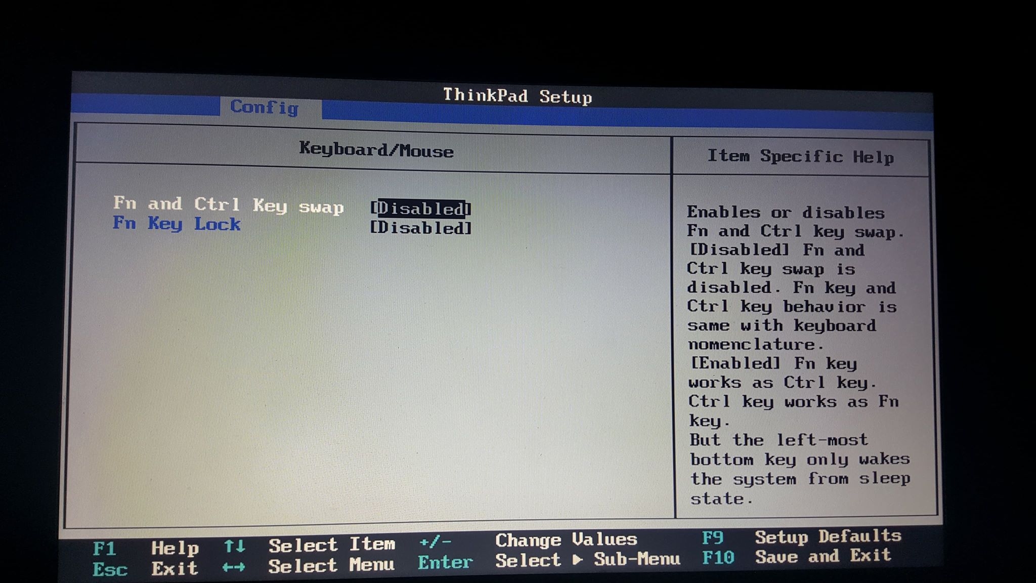

    There is no USB mouse option in the BIOS?
  • #5 17051461
    luk483
    Posts: 8
    Disabling the touchpad does not help.
    In Bios I didn't find anything about mice, only the options in the Keyboard / Mouse tab concern the FN key:
    Lenovo T430 - Mouse not working after USB printer connection, Windows 10, Code 28 - All types [/ Img]

    If I understand everything correctly, the bluetooth mouse according to the system is installed correctly:
    Lenovo T430 - Mouse not working after USB printer connection, Windows 10, Code 28 - All types Lenovo T430 - Mouse not working after USB printer connection, Windows 10, Code 28 - All types
    Well, but it doesn't work ...
    However, when I connect a regular mouse under USB, it appears in the device manager in the "Other devices" position:
    Mouse IDs are:
    USB \ VID_046D & PID_C52F & MI_00
    USB \ VID_046D & PID_C52F & MI_01
    Unfortunately, I could not find drivers for this equipment under Windows 10.

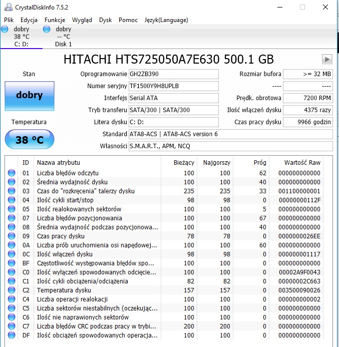

    Also show the SMART hard disk drive to see if it's the fault of data loss.
    The disk looks ok:
