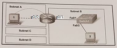

    Hi, I'm trying to learn about computer networks and it's hard for me to find the answer.
    I had the given network IP address, I had to divide the network into subnets A, B, C, D. I counted everything up.
    Now let's take a computer on the A subnetwork for a workshop.
    In it I listed the addresses for hosts 192.168.10.161-192.168.10.174 and the mask 255.255.255.240
    I have to enter in the configuration panel
    IP address: 192.168.10.174
    Mask: 255.255.255.240
    Default gateway: 192.168.10.161
    Did I choose the IP address and default gateway correctly? Is there a rule about which values to choose from?
    I understand that later when I configure the appropriate router interface in PUTTY (in this case g0 / 0) I use the same address that I set earlier in the default gateway?
    Please help :)

    Choosing Default Gateway & IP Address for Subnetwork A: 192.168.10.161-174, Mask 255.255.255.240
    So according to this scheme, how do I have:
    [previously calculated:]
    available addresses in network A 192.168.10.161 - 192.168.10.174
    available addresses in network B 192.168.10.1 - 192.168.10.126
    It is on computer A that I can configure:
    Gate address: 192.168.10.161
    On computer B, I can configure:
    IP address: 192.168.10.126
    Then configuring the interfaces on the router in PUTTY
    int g0 / 0
    description interface g0 / 0
    ip address 192.168.10.161
    no shut
    int g0 / 1
    description interface g0 / 1
    no shut
    And should it be ok? I'm sorry to ask you that, it's probably clichéd but I just want to be sure

    I am not a networker but you set the computers' IP address to the broadcast address.

    Straightening, my first and last. The first and last are taken, omitting the network address and broadcast address. So for 192.168.0.0/24 you will not send 192.168.0.0 because it is a network address and you will not send 192.168.0.255 because it is a broadcast address. So if you broadcast somewhere it is a mistake.

    In the B .127 network it is broadcast, it gives one lower - .126. And similarly in A. There the whole subnet has 16 addresses from .160 to .175, he gave the first available (.161) to the router's address, and the last available (.174) to the host address. Of course, addresses from .162 to .173 are available all the time, and the host could be assigned even .162 or e.g. .170.
