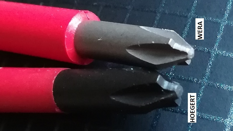

    I advise against using a Hogert insulated combination type screwdriver, designated by the manufacturer as PH1 / SL5x100 (this is the so-called PH plus-minus screwdriver).
    So what if the price is attractive, as it does not fit the notches in the PH1 / SL screws. Compared to the more branded screwdriver, it turned out that the "fins" of the Hogert tip are clearly thicker than they should be. This screwdriver of the second brand is so precisely made (tip) that after inserting into the screw head it holds itself in it (even if the screwdriver is in horizontal position it does not fall out). Hogert on the contrary.
    In addition to this "small" fact the rest is OK - aesthetic performance, solid appearance, grip handle, two-component, tip insulation nicely tapered, materials do not smell "chemistry".
    I have no where to check, but maybe Hogert described as PH1 / SL will fit at least with larger head screws (PH2), I hope so.
