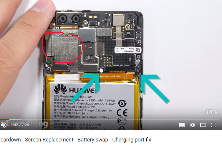

    I have the following problem:
    The displays from Krzymark work perfectly. However, there must be something wrong with the motherboard. I have two P9s:
    in one of them, the phone turns on after pressing power on and vibrates, but no image appears on the display.
    I thought it was a display problem, but I connected this LCD to a second one and the image is displayed very correctly.
    The part of the motherboard that I marked in red in the attachment becomes very warm after 5 seconds, and even hot after a minute. I cleaned the entire Cleanser motherboard with print (isopropanol), applied a new thermal grease and the symptom is the same - the phone turns on, but there is no picture.
    I also cleaned the contacts on the motherboard from the connector to which the IPA display plugs.
    What could it be ? Thanks in advance...

  • #12 17311238
    mst16222
    Posts: 48
    SECOND PROBLEM
    I am begging you for help what's going on .... This is a catastrophe and total hopelessness. First, I was taking Allegro displays from GSM_Parts and the problem was the same as in the first post. Then came the arts from aliexpress - the same.
    Eventually, for the third time, I took the LCD from Krzymark and the problem IS THE SAME.
    I don't understand it at all what this is about ? Do I have any crooked fingers / my skin has degenerated that such circuses are happening?
    When I hold the phone with my right hand and scroll from right to left (i.e. the display scrolls to the right) - no problem. When I scroll with the same right hand from left to right (ie I want the menu windows to move to the left - the display / touch does not respond, but when I change my hand to the LEFT hand, the problem is the opposite.
    MIRACLES ON KIEJ.
    What this is about?!?!?!?!!?! I feel like I'm banging my head against the wall, $$ are flying, and the problem is not solved ... I wasted a lot of time on it ....
    Video: :
    https://www.youtube.com/watch?v=4VyxQqf_8vQ&feature=youtu.be
    Please help me VERY MUCH - I lost two months of time and a lot of money trying to solve this .... three different salespeople and the same problem ... Whatt the fu .... ## ck ...?
  • #13 17311317
    plustek
    Posts: 1427
    Help: 176
    Rate: 200
    Look at the glue-drenched parts above the LCD connector, the extreme ones in the upper right corner are responsible for the touch. Watch it under a microscope, it can be easily damaged by improper disassembly.
  • #14 17311448
    mst16222
    Posts: 48
    Are you talking about the motherboard?
  • #15 17311914
    plustek
    Posts: 1427
    Help: 176
    Rate: 200
    Yes, there are elements responsible for e.g. for the touch.
  • #16 17311931
    mst16222
    Posts: 48
    But there is immediately a large metal plate / cover above the display connector
    Ps. The problem is the same on the second motherboard ...
  • #17 17317757
    mst16222
    Posts: 48
    Sorry plustek, but you're wrong. There is a metal casing above the LCD connector. It is very difficult to damage it, especially since I operate with spudgers and I do not force anything.
    The original compact display is like a dream. The problem was with Chinese substitutes. Three different sellers, yet each acted the same.
    The touch works great on the original ...
