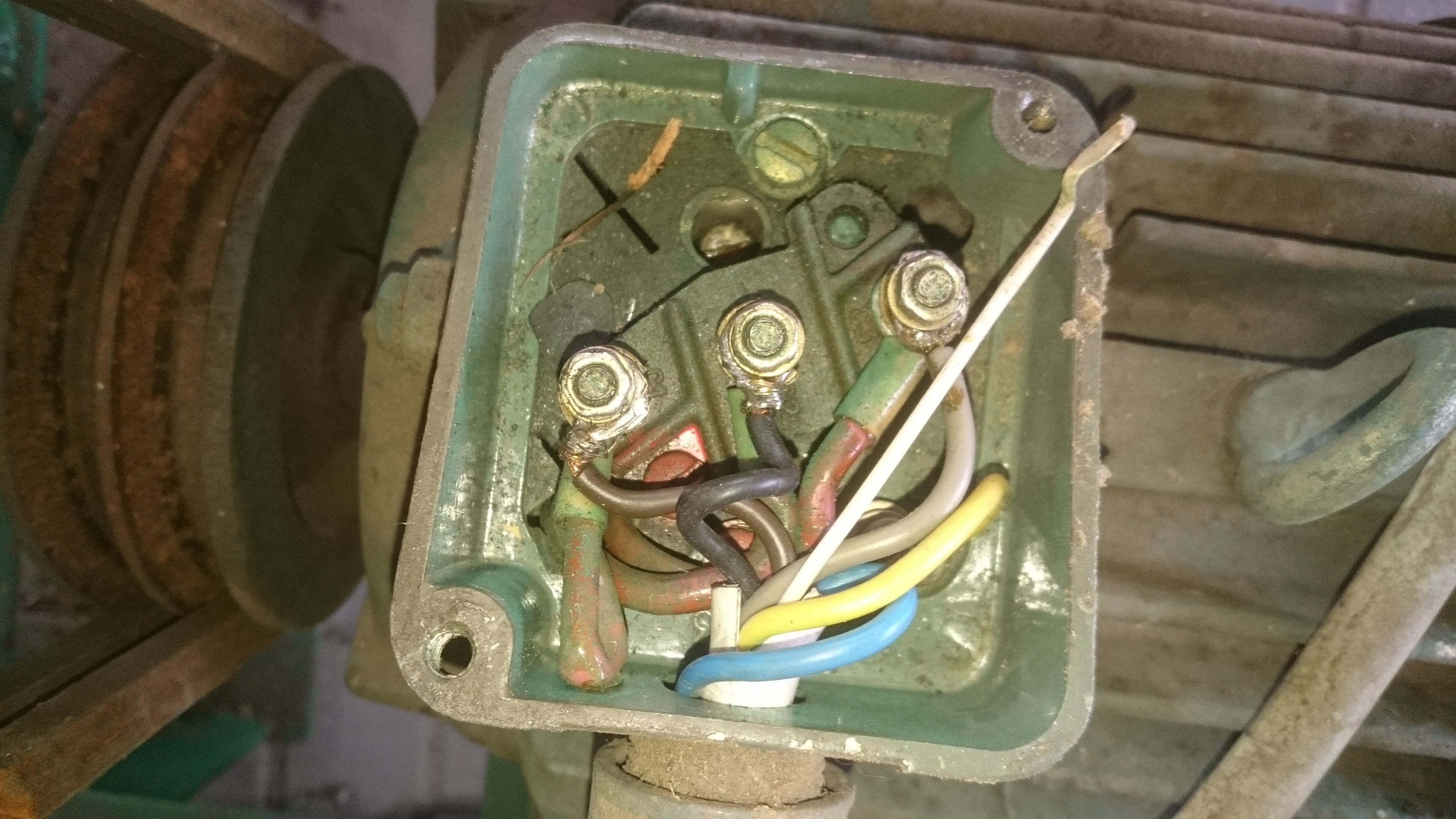

    I have a problem with connecting a 3 phase motor. The nameplate says star connection. There are only 4 contacts to connect (phase I know how) while the fourth contact is connected to the motor housing. The whole device is metal, moreover, a yellow-green cable connected to the structure. What should go under the 4th PE or N contact so that the differential works correctly?
    In the attachments, the motor's contacts are grounded on the bottom right, and the motor's nameplate

    You need to connect PE. If you connect N, the RCD will work. The three-phase motor does not need N. However, it must be grounded, therefore PE to the housing. The situation changes when there is no differential, then we connect N.

    This motor does not need a N wire to operate.
    You connect the PE wire to the motor housing.
    No, nothing changes, we still connect PE to the housing despite the lack of a residual current device.
    Never connect the N wire to the housing, or you can connect the PEN or neutral wire, if there is one in the installation.

    Badly. Then we also connect PE.

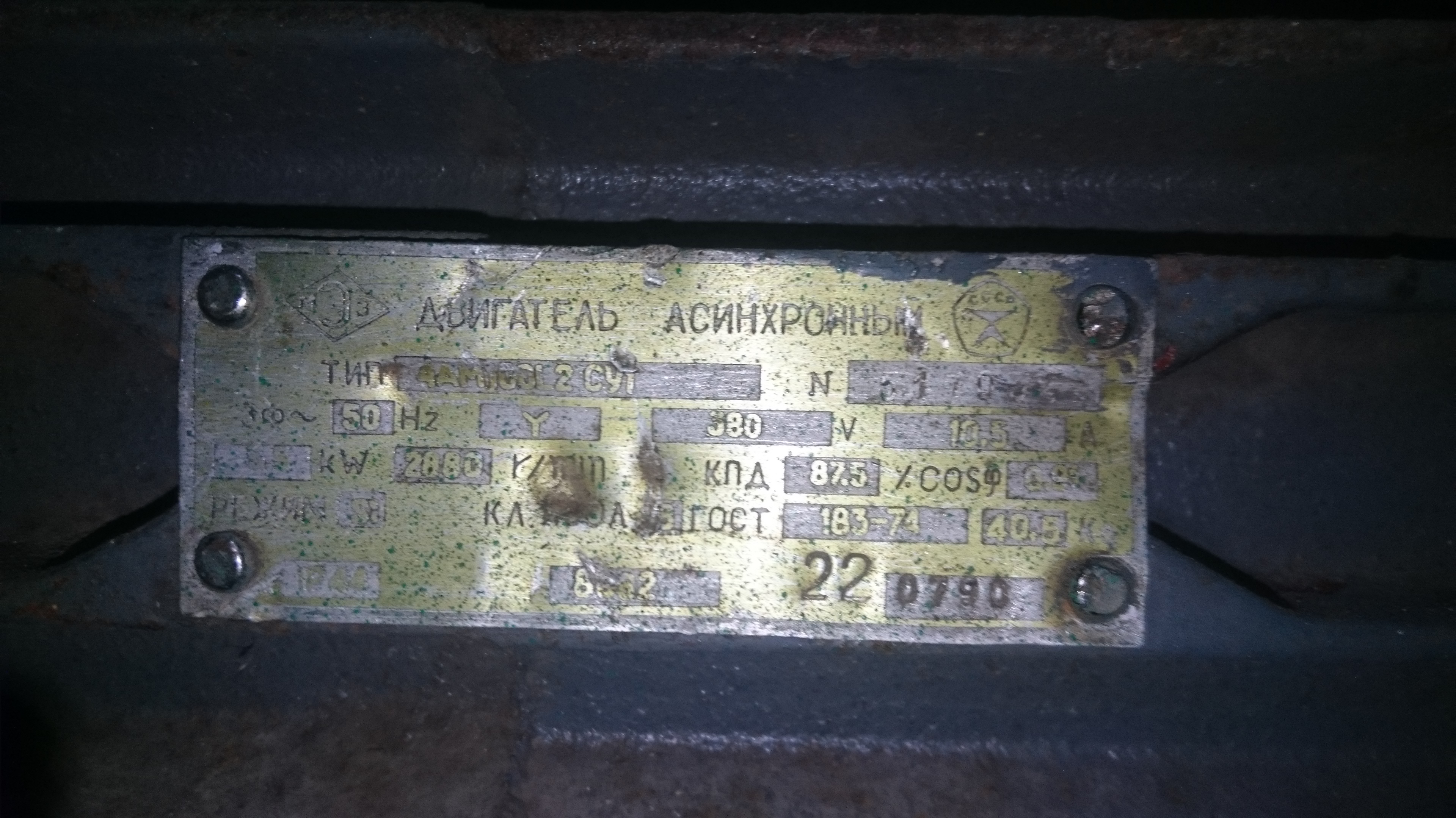

    The engine is Soviet and probably "age".
    It has a drawing of a star.
    On 3 wires in a star system - think a bit.

    It is an asynchronous motor (asynchronous propeller) ;) for the voltage of 380 V with the connection of the windings inside the motor in a star system, therefore 3 wires are led out.
    Connect the protective conductor under the housing terminal.

    In both cases, we connect the PE conductor to the housing.
