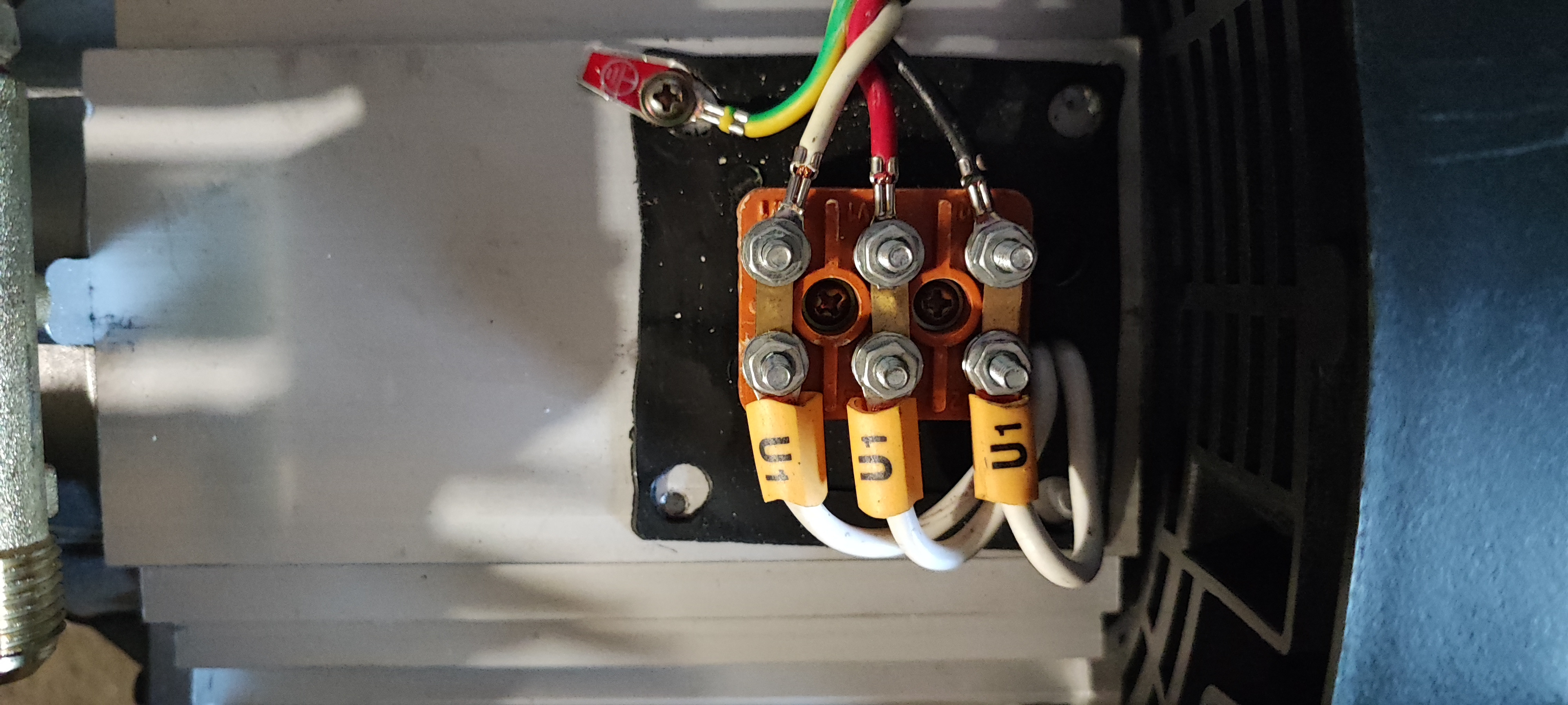

    and such connections, without N
    • Connecting 400V Wheel Balancer: Color-Coded 4-Wire Cable, P1 P2 P3 & Pe Phases, Safe Setup 1689789541656.jpg (1.19 MB) You must be logged in to download this attachment.
