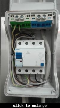

    Mikhaił
    Posts: 320
    Rate: 22
    Hello, I will stick to the topic ...
    Today I encountered something like this, PE is plugged in instead of N, is it correctly connected? The RCD protects the winch, there is no neutral wire.
    Connecting 3-Phase RCD: L1 L2 L3 PEN & L1 L2 L3 PN Wiring Diagrams (with Diagram Link)
    • Connecting 3-Phase RCD: L1 L2 L3 PEN & L1 L2 L3 PN Wiring Diagrams (with Diagram Link) IMG_20170410_153158.jpg (2.02 MB) You must be logged in to download this attachment.
  • #21 16404693
    Brivido
    Posts: 2861
    Help: 226
    Rate: 430
    If it is indeed PE then it needs to be disconnected from the RCD and joined together.
  • #22 16404754
    Mikhaił
    Posts: 320
    Rate: 22
    Ok, if the PE is only connected to the rail, then the residual current circuit breaker will still fulfill its function?
  • #23 16404815
    kkas12
    Posts: 17400
    Help: 1076
    Rate: 4312
    The absence of a neutral wire is unacceptable as it makes it impossible to perform the test in this apparatus.
    This switch should be replaced with one that has the test circuit connected between the two phases.
    Then everything will be ok.
