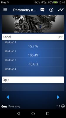

    Hi everyone,
    There are many similar topics, but I have not found one that specifically matches my symptoms.
    Namely, when accelerating above 1800 rpm, the car loses power and starts to jerk that it is impossible to drive.
    Even at a standstill, when I try to gasp, you can feel these uneven revolutions and with the gas pedal fully depressed, the revolutions do not exceed 2500.
    In addition, after connecting to the computer, error p0299, i.e. too low boost pressure, and in fact when pressing the gas pedal to the floor, it should be 2.5 bar, and the pressure does not exceed 1.5 bar.
    The turbine bar works in full range, which means that the pear and the stuck vanes fall off. But in my opinion, if they were toasted, it would be rather overloading. Yes?
    I changed the N75 valve from another car and you can't see any difference.
    The cables are also rather inspected and there is no hole anywhere.
    The pipe does not smoke because there is DPF, and it should not. Right?
    DPF checked with the computer and also does not indicate that there is something wrong with it.
    The injectors also work correctly according to the computer.
    Does this mean that the turbine is dead? And if the turbine, what could have fallen there that I have such symptoms? Can he check anything else? What do you advise?
    I removed the turbine inlet pipe and the impeller has no noticeable play and turns slightly.

    Does he pull the barbell on the turbine at the Stop at all? Did you check it? And dpf is not a magic creation, just an ordinary filter that collects I guess. If it is dry and cold, it will let out smoke when the turbine collapses. If it is clogged, nothing will be missed and you should look for a problem here. You can unscrew it at the turbo or skip it and try how the car drives.
  • #8 17295328
    wasill20
    Posts: 34
    Rate: 31
    When I stop, the barbell goes up and down in the range of ~ 1cm.
    Komp shows that the DPF was burned out some 40 km ago and its filling value is 38%.
    I'll try to unscrew it again then.
    And how can egr be associated with these symptoms?

    I cleaned the EGR and throttle, but it didn't change anything.
    I was so wondering about this DPF, it looks like it's jammed heavily
    VW passat B6 2.0 tdi - jerking above 1800 rpm, no power and error p0299
    From what I read, the maximum amount of ash is 60g, here it shows me 105.
    And if I disconnect the DPF from the turbine, nothing will happen except that it will work louder?

    Clogged DPF for cleaning
