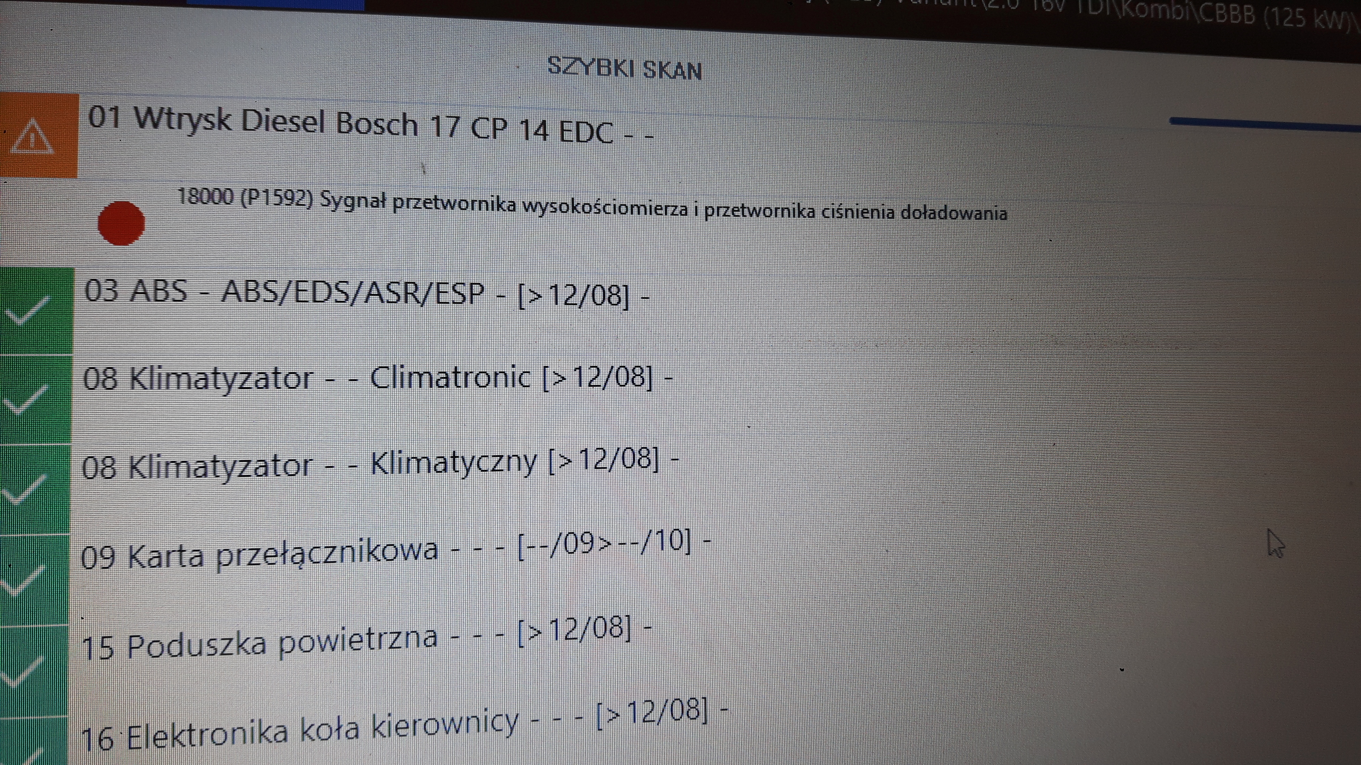

    Hello, I have a problem with VW passat B6 2009 2.0 140km. In texta came to me error 1800 (P1592) signal of altimeter transducer and boost pressure transducer. Yesterday I changed the gear shifting cables and then the error jumped out and the car lost power .... of course the egr was attached but everything I checked is connected ... I am afraid of any failure after I had to regenerate with Siemens injection ....
    If toshiba has an idea, please advise. greetings

    Check the plugs do not bend or any of the pins do not come out.

    Strange thing this morning. The power returned only the error remained on the board but probably only to be deleted. Thanks

    Hello, I still have the same problem .... I checked the plug ... the car has power once and disappears once ... more smokes in the absence of power ...

    To be checked: harness from control room to turbine control valve with variable geometry. They often rain too.
    Also check what pressure the turbine generates while driving.

    But why check it out:
    and this:
    since the error concerns the correlation of signals from two independent pressure sensors?
    Not only that, this particular error will not occur while driving, only before starting the engine.

    In the logs you can see how G31 shows because it is about him, possibly "wires" coming to him. Usually shows more than it is.

    Watch group 010, the second and third values are to be very similar, even identical.
