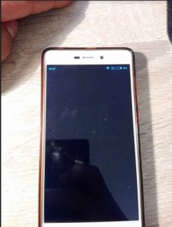

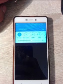

    Hello! I have a problem with my girlfriend's phone because it just stopped working well. The point is that after turning on the phone immediately jams and only what you can move the bar from above and sometimes enter the options:
    Xiaomi redmi 3 - Black screen right after turning on the phone Xiaomi redmi 3 - Black screen right after turning on the phone
    Unfortunately, now even the phone does not turn on, I have no idea what to do and I am looking for help here
    Regards!

    You need to check the battery voltage. Then perform a hard reset or upload a new firmware. If the phone is under warranty, use it.

    The battery seems to be okay to me because it is charging normally, there was no problem with it before. The problem is that the phone detects in the computer for a while and then loses itself, is it possible to do a hard reset without connecting to the computer?

    You can hard reset from recovery.
    To do this, you turn off the phone, then hold Vol + and press power while holding Vol +. As you enter recovery
    you are looking for something like wipe data or factory reset. You select it with the volume keys, and that's it ;)

    I would also check the USB socket.

    Thank you for your help, rebooting the system by flashboot helped!
    Added after 4 [minutes]:
    Reloading the software helped
