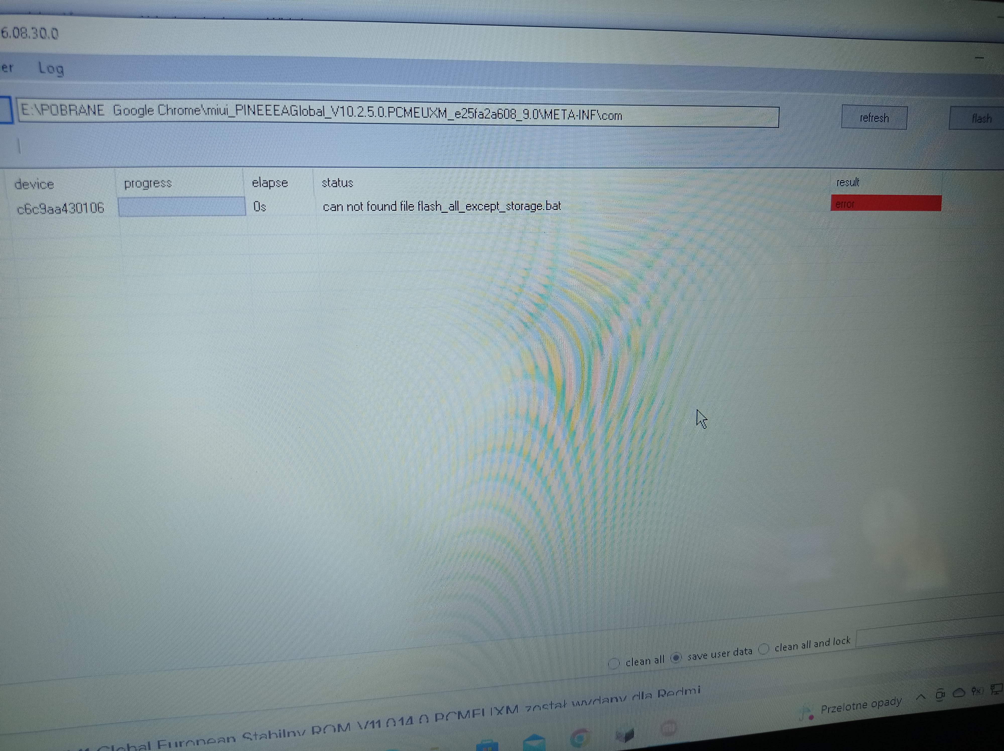

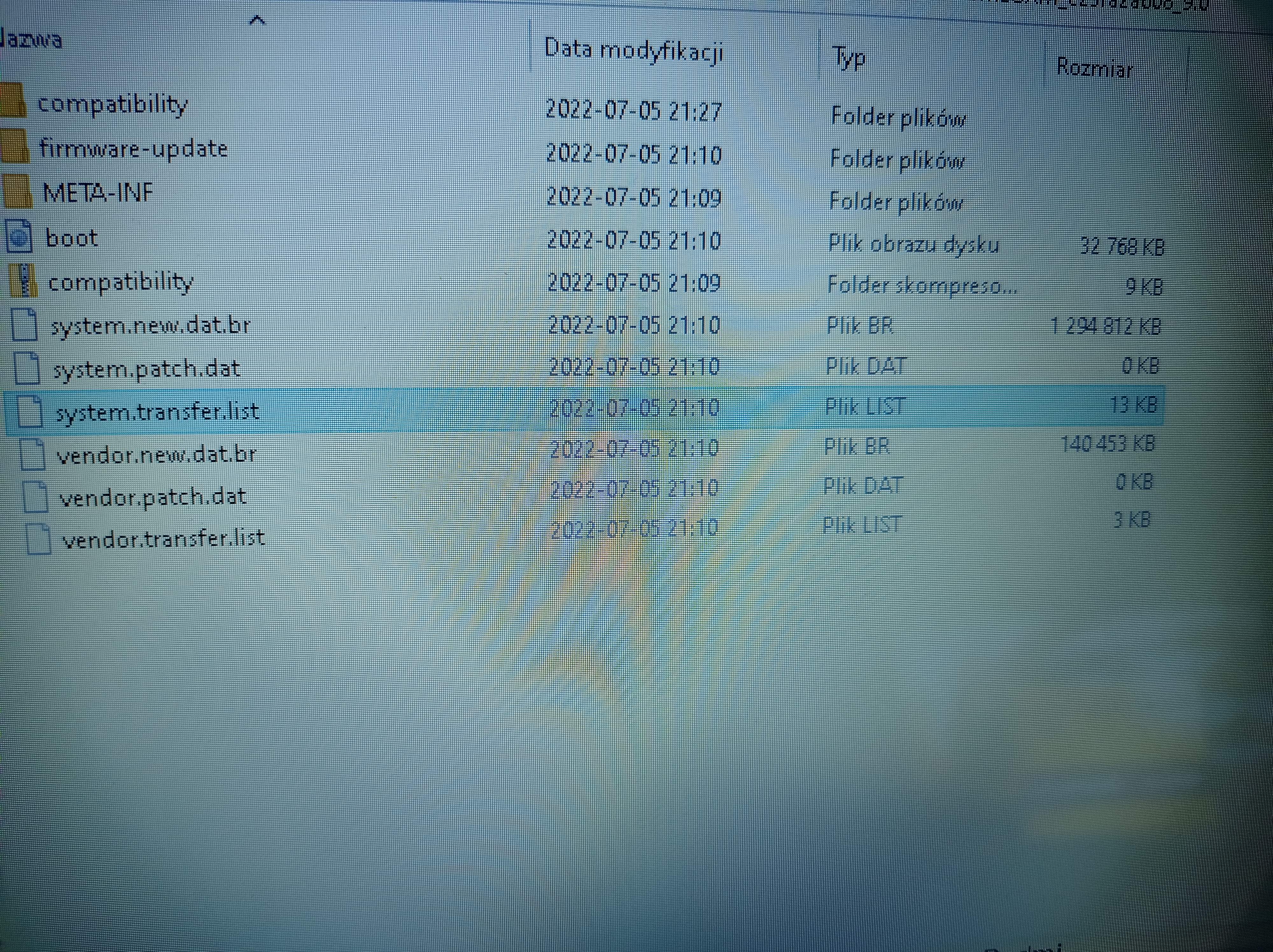

    #8 20080154
    adamskippl70
    Posts: 17
    Rate: 7
    I used the Miflash program, downloaded a few ROMs, unzipped. When I want to upload a system, an error pops up in Miflash - can not find file flash_all_except_storage_bat. What to do with it next? I read that you still need to somehow unpack and process the compatibility folder, but I don't know how to bite it.
    What system to try, Europe, China, Russia, India? How to check which system is for my phone?

    #9 20129786
    adamskippl70
    Posts: 17
    Rate: 7
    winmap wrote:
    Possibly a battery but probably not. If you have nothing left to lose, try reloading the soft. If that doesn't help, it's most likely a faulty board.
    The new system cannot be uploaded because the phone asks for the Xiaomi account number. Unfortunately, I do not know it, and my son claims that he did not wear any.
    I sent an e-mail to Xiaomi's central service requesting deletion of my account. They asked for the IMEI number of the blocked phone and the number of the SIM card. I sent it and am waiting for a response.
