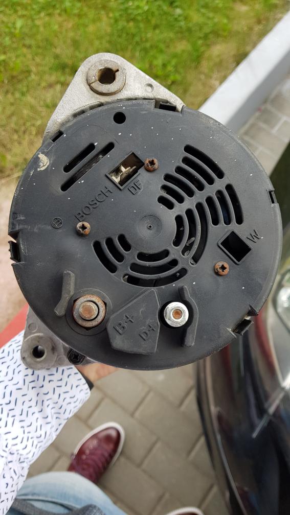

    Hello, I have a problem with the alternator in my a4 and I would like to replace it with 90 VALEO for 120 BOSCH and with the numbers 046 903 015 F, the problem is that I do not know if it will fit. The reason for the replacement is undercharging the battery and the desire to make a good car-audio, because the current ori speakers are ending their lives. I am adding an attachment altka 120 Bosch that I have the opportunity to buy.

    In this altk in the picture, the pulley has 6 ditches and a diameter of 65 mm, my current pulley has a diameter of 57 mm and has 5 ditches, which disqualifies this alternator because after changing the pulley it may not load properly. And the DF contact is the output contact to the ECU that does not need to be connected.

    SG12B018 is also suitable for Valeo.
  • #8 17374876
    OpenTheGates
    Only in this altek there is an input for the 2pin plug, in the current one I do not have such a thing, it fits mechanically but electrically not necessarily, unless you can do something about it

    Check if it fits mechanically (the fixings), the rest is a secondary matter
