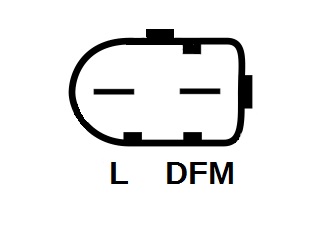

    AJQ 1.8t engine. Yes, the lamp is on and working. If we assume that the regulator is okay (I will take measurements tomorrow), if someone put a lamp in the board smaller than it should be or led, or can it be the reason? There are 3 wires connected to my alternator. One fat for starter. And a cube with two cables, what are they for? I assume one to excite and the other?

    1.8t AJQ engine and 90A Bosch alternator, according to the catalog one wire is Lamp the other is the load signal to the computer. So we are only interested in the lamp.
    You can take a second bulb, plus to the battery, minus to the L pin (diagram) in the controller and check if it goes off after firing

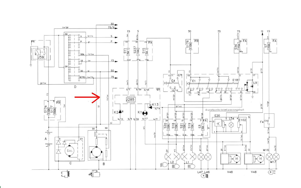

    The blue +12 cable after the ignition goes to the meter for the lamp, there is a resistor. then the blue cable runs to the alternator. I know this from an autopsy and just have a look at the diagram to find out. The alternator is not computer controlled.
    But if you know better how it is controlled then enlighten us ??
    In addition, you cut out of my statement a sentence that did not specifically apply to this audi.
  • #16 16269958
    abart64
    Posts: 1716
    Help: 271
    Rate: 633
    A resistor in the meter is probably not needed in this system. It seems to me that at the time of starting alt. gets full power from the ignition switch on L and since it is already turning, it is fully activated after firing. The marking on the ignition block is 50b and not 50a as I wrote earlier.

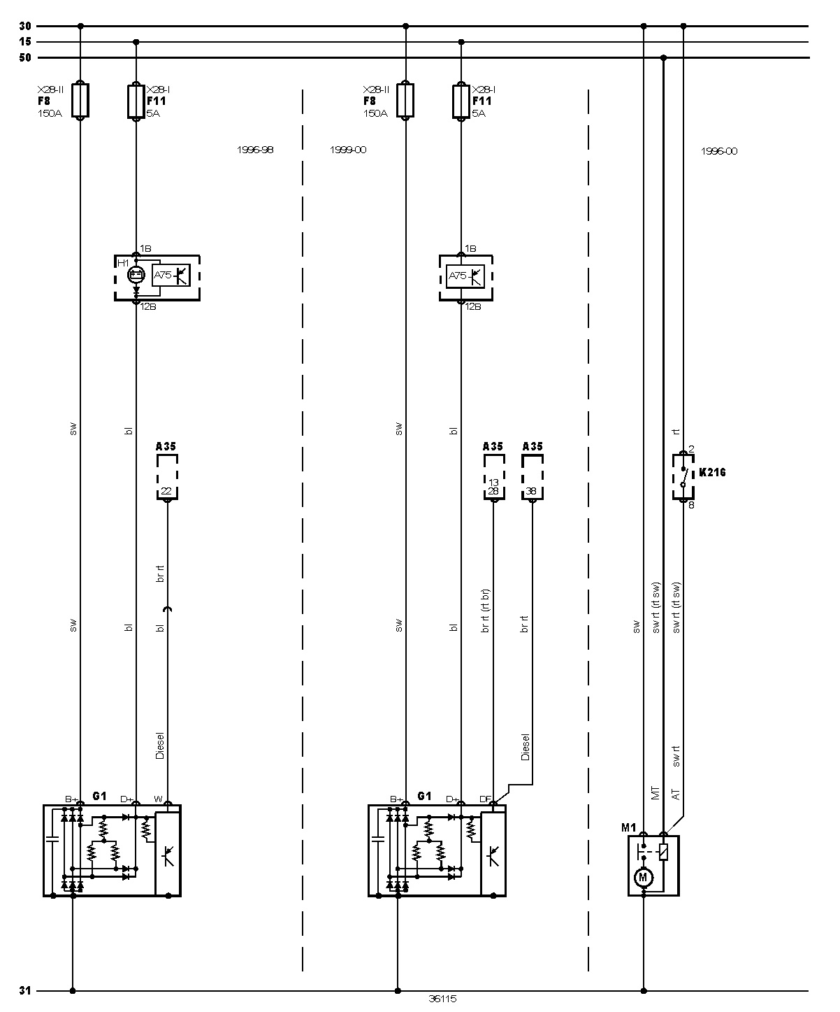

    Did your friend solve his problem because off top got scary. I enclose the diagram I have and end this without meaningful argument.
    I think we presented all the possibilities to a colleague and he can check it out.
    Audi A3 8L: Alternator Charging Issue - Indicator Light, Gas Revs, 14.3-14.4V, Bosch 90Asch.jpg (149.59 kB)You must be logged in to download this attachment.
