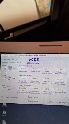

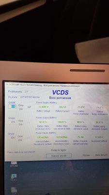

    I replaced the battery today.
    Before the exchange I had a 95Ah battery of some crappy Chinese company with German decals.
    I do not remember what encoding it had.
    Today I've installed the Varta 110Ah 920A battery.
    I coded it with VCDS 18 and introduced such coding: 000915105AK VA0 6104020923
    Others, unfortunately, do not want to enter. The program throws an error with an incorrect number of characters or an incorrect string of characters. I do not remember exactly.
    It pops out that it should have 26 characters in the hexadecimal system or something like that.
    Apparently he took this one code but in measuring blocks he shows something quite different. Shows that the battery has 66Ah.
    Is this the fault of coding or maybe something else?
    Can he sometimes go into emergency mode for this reason? I would like to add that this mode is most often used on the ignition itself.
    All I need to do is turn off the car. I will start and emergency mode disappears for some time, sometimes even a few days will not appear.
    That's how it looks. I apologize for somehow photos but I did them quickly.
    Is this Can Gateway module for exchange? Or maybe something else?

    I changed the coding to 8K0915105F and still the VCDS shows the battery charge in 91% and the capacity only 75Ah
    What could be the reason? I still try to look for some other coding?

    Is 110Ah predicted in this car at all?
  • #5 17443045

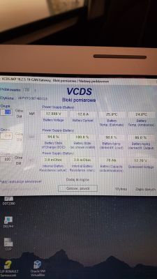

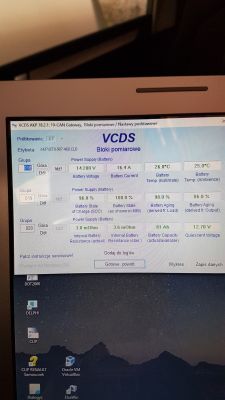

    spedero
    Posts: 17
    Rate: 11

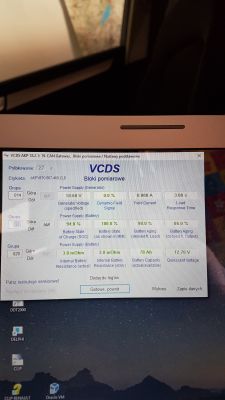

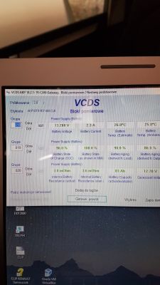

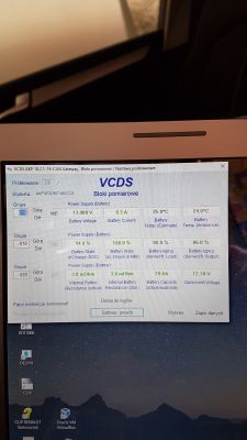

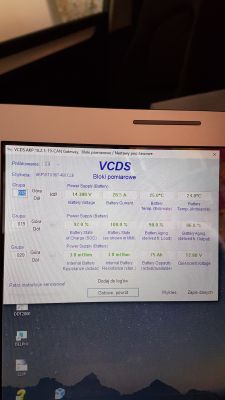

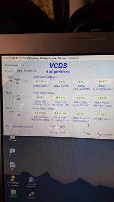

    You can mount it. I do not know why, however, it does not show 90Ah or 100Ah if the coding is from 110Ah.
    Please take a look at these pictures.
    I can not understand why the voltage is changing.
    I coded the battery like this - 8K0915105F for 110Ah.
    The last photo shows the parameters as soon as the car is out.
    Audi A4 B8 2.0TDI: VCDS Battery Coding Issues for Varta 110Ah 920A - Incorrect Ah Display Audi A4 B8 2.0TDI: VCDS Battery Coding Issues for Varta 110Ah 920A - Incorrect Ah Display Audi A4 B8 2.0TDI: VCDS Battery Coding Issues for Varta 110Ah 920A - Incorrect Ah Display Audi A4 B8 2.0TDI: VCDS Battery Coding Issues for Varta 110Ah 920A - Incorrect Ah Display Audi A4 B8 2.0TDI: VCDS Battery Coding Issues for Varta 110Ah 920A - Incorrect Ah Display Audi A4 B8 2.0TDI: VCDS Battery Coding Issues for Varta 110Ah 920A - Incorrect Ah Display Audi A4 B8 2.0TDI: VCDS Battery Coding Issues for Varta 110Ah 920A - Incorrect Ah Display Audi A4 B8 2.0TDI: VCDS Battery Coding Issues for Varta 110Ah 920A - Incorrect Ah Display

    Today on the alternator I had 14.2V and, for example, 12,8V or slightly over 13V yesterday. Is the regulator on the alternator for replacement?
  • #7 17449594
    szymitsu21
    Posts: 3702
    Help: 343
    Rate: 1300
    Check if the charging does not increase when the number of receivers is turned on.
    If so, it's normal.
