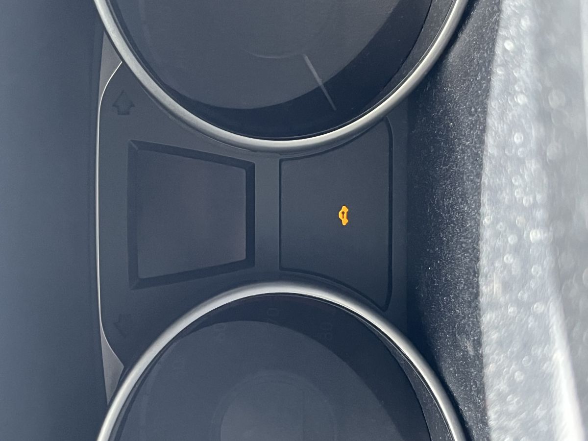

    Good morning,
    I have a problem with Hyundai ix35 in gas with automatic transmission.
    The following controls are displayed:
    Hyundai ix35 Gas Model with Automatic Transmission Won't Start - Control Display Issues
    Does anyone know what to do?
    greetings

    He does not see the key like this on mine, but what is the reason will be known only after the diagnosis.

    The key was :) Just then the control light came on and went out after a while.
    The starter beeps when the start is activated.
    This is not a battery, because we checked.
    Could it be any fuses?

    This "pyk" is the end of the brushes or the machine or the rusted "plus" connection, or the lack of mass on the rear housing of the starter.
    In the Korean, this yellow light with the key goes out only after starting, so leave it alone.

    Description of what I do:
    I get in the car
    souls brake and start button
    electric works: radio, air blowers
    and I hear the mentioned "pyk"
    the lights in the picture are on and the car does not start
    I wonder if this is a matter of a blown fuse?

    Fault:
    -Auto does not start when the button is pressed. It smoked at all
    -The timer does not allow you to set SET and sometimes it simply cannot be turned on.
    -I saw a red error from the downhill assistant (then it caught fire when I rode a bit)
    Diagnosis:
    -2 clutch position sensors. With the meter checking the short circuit after pressing and squeezing.
    Bingo.
    Unplugging the plug from the upper helped start the car (the upper button is pressed when the clutch is loose, so that 2 wires have a closed circuit) unplugging the ankle has opened the circuit and the computer thinks that the clutch is pressed, so it starts.

    Oh, and I will add that the ground cable underneath is worth checking such a copper ribbon on the right under the engine at the wheel arch - I had it broken.
