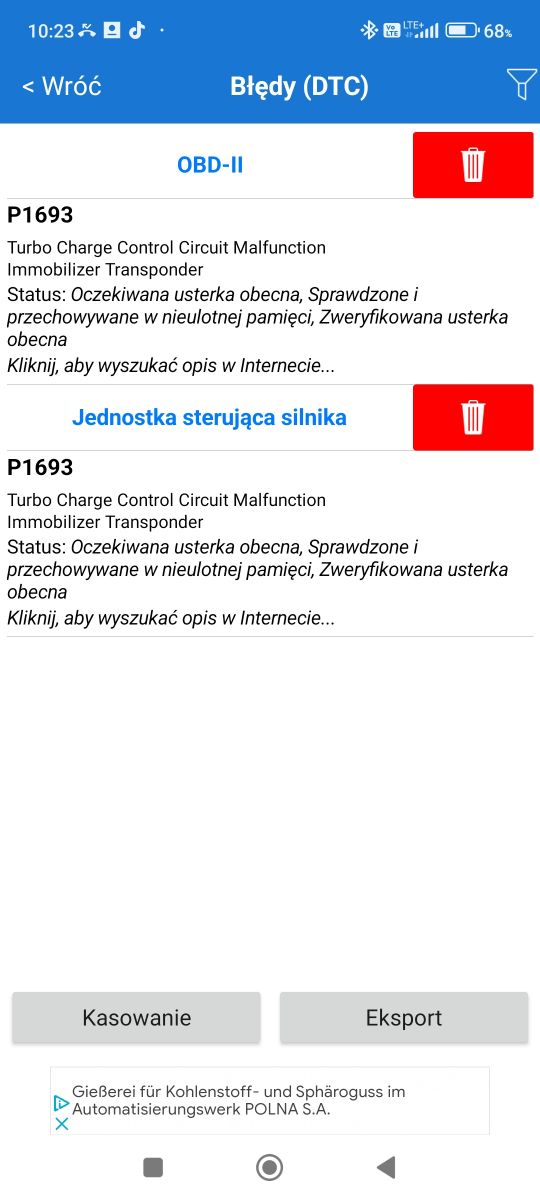

  • #8 20764017
    fenix35
    Posts: 7
    Hi buddy managed to solve the problem with these error codes I have the same thing and don't know where to start for now I swapped keys we'll see

  • #10 20764614
    CameR
    Moderator of Vehicle Security
    Posts: 7706
    Help: 1139
    Rate: 3266
    You need a transponder tester and an immobilizer loop (antenna) tester.
    fenix35 wrote:
    for now I swapped the keys let's see
    If after swapping the keys the problem disappears, then to replace the transponder in the key.
    BenA3 wrote:
    Immo off and you're done with the problem
    Don't cripple the car. It can be repaired without any problem.
