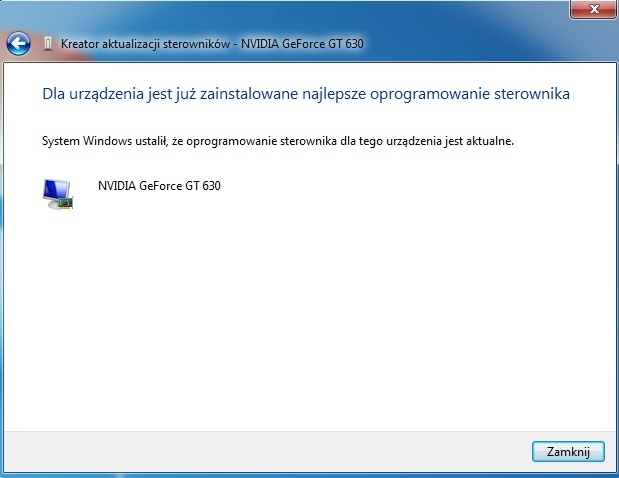

  • #14 17355444
    Kolobos
    IT specialist
    Posts: 85178
    Help: 17171
    Rate: 10455
    When manually updating the driver, select manually what you want to install and then the system will not display the message that you have already installed a newer one.

  • #16 17355462
    Kolobos
    IT specialist
    Posts: 85178
    Help: 17171
    Rate: 10455
    Ie? Is an error displayed? Do you still choose the wrong options?
    You have to choose Browse my computer ... -> Let me choose from ... and then you click on Disk

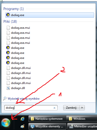

    By the way, by the way, the author also showed a direct error.
    I haven't played with it for a long time, but type in menu Start> dxdiag, maybe someone will see something more up-to-date?
    This graphics driver could not find compatible graphics hardware
    I have no problems there.

  • #20 17355646
    byyrty
    Posts: 10
    @ g107r
    In the first post in this topic with an error Photos attached installation DirectX. DXDiag is unfortunately impossible to uruchomienia.
    As to the drivers - fact, do not mind the old version as najbardziej. but before had with it any problemów. install the latest drivers without problemów.
    Installation of Direct was successful. It's probably because there are rudders installed for the card, right?
