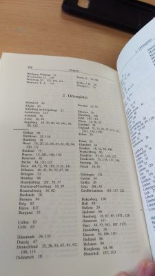

    I tried unsuccessfully to recover photos from the sectoral copy with several programs. As suggested, the photos were damaged by bad sectors. During the scan, bad sectors appeared gradually over the entire volume of the memory card, not in larger groups. It was reflected in all photos. An example is attached below. I don't think there's anything else you can do about it. If no one has ideas, the topic is closed.
    • No Access to Samsung Galaxy S8, SanDisk Extreme Pro 32GB Micro SD Card Contents for Photos IMAG1920.jpg (3.14 MB) You must be logged in to download this attachment.

    You can read unread sectors.

    This is probably the only option, otherwise it is fun in photo processing programs. 6 bad sectors.

    How (with what software) can this be done? This fixed picture looks great, I didn't think you could get this effect. Let me add that I would like to work with the copy in the bin file that I managed to make. The card is no longer visible even in DMDE, I think it "died" completely.

    That's how I improved in 5 minutes, because in total, it will be faster to add / correct the missing MCU in the graphics program. Without a correction in graphics programs (also quickly), after just 2 minutes in JRS it looks more or less - these "holes" are the result of lack of data. You can see exactly 3 sectors of damage (3 times 2 sectors). JRS is enough for quick repair of "shifted photos" and color correction. In this case, I had to edit a few more bits in the third failure, because the program did not want to restore the "third part of the file":

    The photos were recovered using DMDE. To repair damage caused by bad sectors, the JPEG Repair Shop indicated in the post above was enough.
