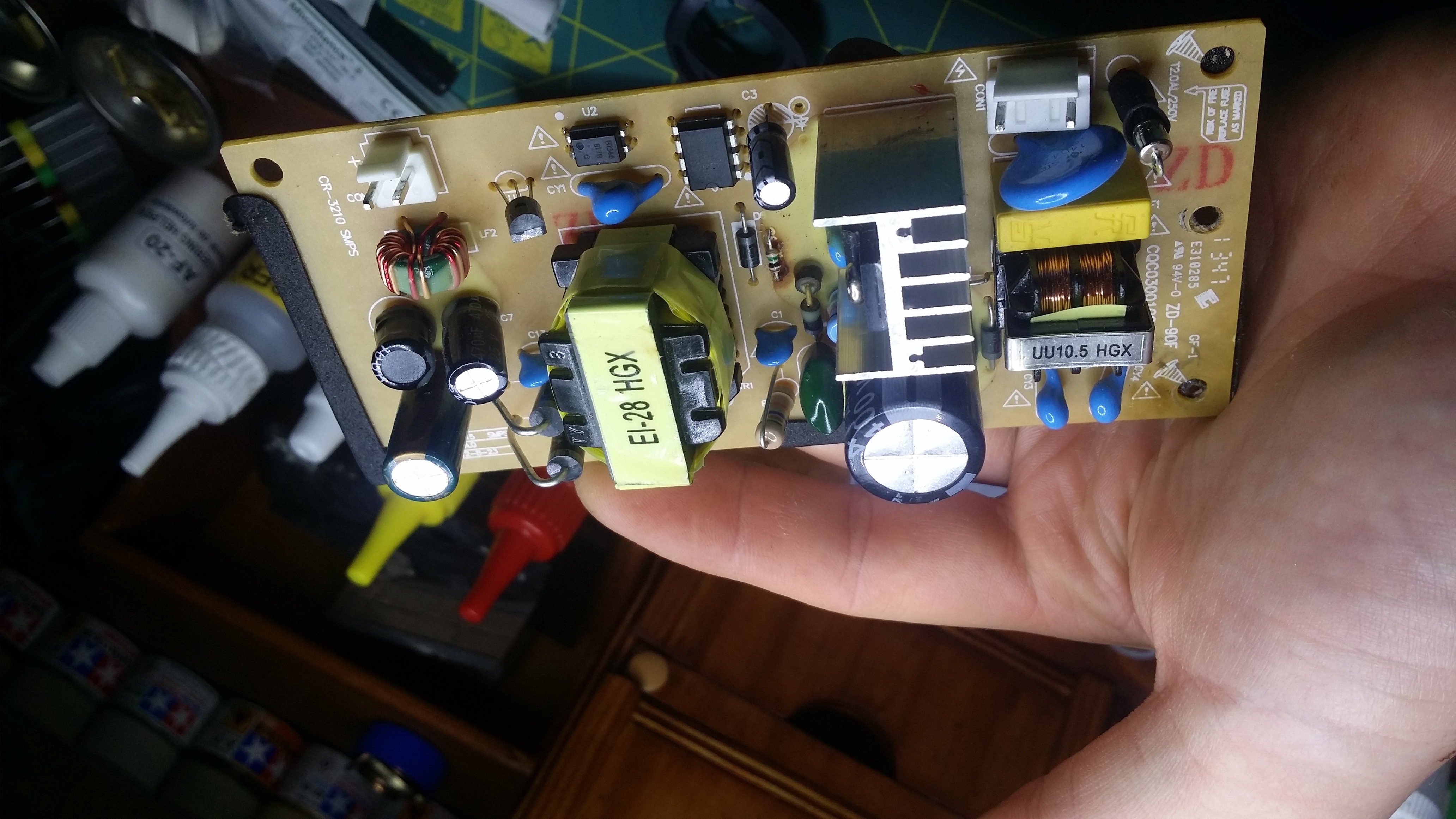

    Hello, as in the name of the topic, I have a problem with the Creative T3300 speakers - I turned everything up to zero - I got to the PCB with the transformer:
    Creative T3300 Speakers: Hissing EI-28 HGX Transformer Issue - Repair/Replacement Advice Creative T3300 Speakers: Hissing EI-28 HGX Transformer Issue - Repair/Replacement Advice Creative T3300 Speakers: Hissing EI-28 HGX Transformer Issue - Repair/Replacement Advice Creative T3300 Speakers: Hissing EI-28 HGX Transformer Issue - Repair/Replacement Advice
    The hissing sound occurs all the time whether the music is playing or not - is there any chance of repairing or replacing this? If so, how to go about it or what transformer to buy?

    Buy the same one to replace - only together with the whole set of speakers ... (i.e. alle ...)
    You can try to fix it - the hissing is probably nothing else than the vibration of the core - and the contact of both halves. You can try to stick it with a "drop".

    https://www.elektroda.pl/rtvforum/topic3182027.html
    He hisses because this type has it. It is a high frequency transformer, it works in a converter.
    It may be loaded by some element such as a capacitor.

    So, possibly changing one / of the capacitors can remedy it?
    To get to the cores, it is enough to disassemble the entire yellow tape?
