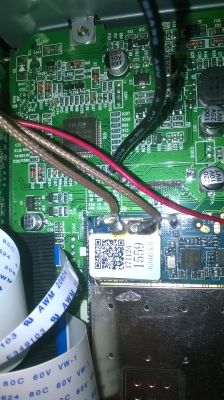

How can I fix the problem where the treble/equalizer settings on a Blow AVH-9900 Android 2DIN radio reset after each restart of the Radio app?
The issue was fixed by installing an MCU update file provided by the Blow distributor/service, after which the radio and its other functions worked properly again [#17558757] [#17560065] The update was done by copying the file to a USB stick, opening Car settings, choosing MCU update, and waiting about a minute [#17558757] If the unit is under warranty, contacting the distributor/service for the update is the recommended path [#17523981]

    Problem with equalizer settings after turning on the radio. The point is that after starting the radio (application), each time there is a lack of high tones (treble slider set to MAX) and behaves as if it were in the minimum position and all you need to do is move it gently and the high tones return (according to the slider setting treble) and so until I turn off the radio (radio application) or the radio itself, after restarting the radio (application), then again I have to enter the equalizer settings, gently change the position of the treble slider, or choose one of the ready equalizer settings and everything works as it should be. The problem does not occur when listening to music via bluetooth and external media.
    I guess the problem will be in the RADIO application itself, the treble slider position is not refreshed and information about its setting is not sent to the sound processor (CSC37534). The question of whether anyone has an idea how to eliminate this problem and how to possibly go about it, probably involves burying in the software.

    Regarding my topic, I tried to root the station but without success, thanks to which I wanted to "pull out" the radio application and subject it to modification (although I have no idea about writing an android application), it would be a step forward, unfortunately not yet available for me If anyone has any experience in this type of matters, a hint would be appreciated.
    The next step was to download a similar software to the station and "remove" the radio application and eqalizer and install them on my station. While the eqalizer was able to install (it does not change parameters), the radio application could not be installed.
    The next thing I did was connect the I2c analyzer to the radio and view what was happening on the bus. Here are the logs received after starting the station and starting the radio application (at the bottom of the topic).
    I added short comments in the logs. Then I wrote a short program (Bascom) and programmed AVR (promini with atmega 328p on board), I joined the radio and managed to get the change i.e. the treble parameter was set to max, and you could end the topic because after each start of the station and turning on the radio on the blue wire from the radio appears a voltage of 12V that starts my attached system and sends after a countdown (e.g. 4sec) the sequence on I2c and changes the treble to max, the problem is that if I start, e.g. playback from external media and restart the radio, then treble = 0 returns. I do not have experience in i2c, but if someone has an idea how to read using AVR what is sent from the master to the slave (sound processor) and when e.g. we detect that the address 0x80 and 0x57 (treble functions)
    the value 142 will be sent (this corresponds to the treble setting to min) then our attached AVR will send the value = 12 to this address (it corresponds to the treble setting to max).
    Maybe this is not the most beautiful solution but for me it would be enough).
    The last idea would be that the android application would be able to send to i2c just like my attached AVR the appropriate sequence and change this unfortunate treble parameter to max.
    Here are the details of the pdf-a bd37534f or sound processor on this radio.

    The topic of the radio is still valid, the distributor's service asked if the described fault occurred before or after opening the radio and is now silent about it.
    I put a short film presenting the problem of the lack of high tones after each launch of the radio application and the need to run the equalizer and adjust the position of the treble slider to play correctly:
    https://filmy.elektroda.pl/28_1541340913.mp4
    [Film: a33c1e8b65] https://filmy.elektroda.pl/28_1541340913.mp4 [/ film: a33c1e8b65]
    I also place some photos:
    Blow AVH-9900 - Eqalizer does not work properly on Chinese 2 din radio Blow AVH-9900 - Eqalizer does not work properly on Chinese 2 din radio Blow AVH-9900 - Eqalizer does not work properly on Chinese 2 din radio Blow AVH-9900 - Eqalizer does not work properly on Chinese 2 din radio Blow AVH-9900 - Eqalizer does not work properly on Chinese 2 din radio Blow AVH-9900 - Eqalizer does not work properly on Chinese 2 din radio Blow AVH-9900 - Eqalizer does not work properly on Chinese 2 din radio Blow AVH-9900 - Eqalizer does not work properly on Chinese 2 din radio Blow AVH-9900 - Eqalizer does not work properly on Chinese 2 din radio Blow AVH-9900 - Eqalizer does not work properly on Chinese 2 din radio
    1. Does anyone know how to backup system / romu / MCU?
    2. How to do root on this radio (kingroot, kingoroot not overwhelmed by this)?
    3. Where to get files for the update and how to carry it out (access to the bootloader is)
    4. Will having the backup be able to restore the equipment to its original state in the event of failure?
    5. USB debugging is enabled in the options, does it give any possibility to get started with this problem?

    Hello. I had the same problem. After contacting the website, I received a file that needs to be installed in the radio according to the attached instructions:
    Please extract the file from the attachment directly to a USB stick, enter the car setting, mcu update options, and wait about a minute.
    The file I received is placed in the attachment.

    I confirm the statement of my colleague hugo9, after updating the MCU, the above mentioned radio file and its other functions work properly.
