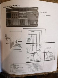

    Hi, I hooked up the amplifier to the android radio today. But I don't know how to enable the sound settings for the amplifier, the settings are there but it says "no amplifier". Anyone know anything?

    You did not provide data on the radio but maybe it will be as in my case grab your finger from the top edge and swipe down on the screen will slide out the menu and there should be unless in this model this option is in a different place. Turning on AMP Power sometimes signed AMP_Control is applying 12V to this cable. Under the amplifier you connect the AUX RCA output .

    Yes, here it was to turn on the voltage on the cable to excite the amplifier. But the eq options for the amplifier further is "no amplifier". Unless you need to plug in the rca because the other outputs from the radio, I plugged in audio R and audio L ;) .

    It is likely that you need to connect the rca because other outputs from the radio, I plugged in the audio R and audio L
    This radio probably already has an amplifier in it if you want to plug in an external amplifier, it is more likely that the amplifier is connected to the unamplified signal because why amplify the already amplified signal. If you have a photo of the pinout instructions, the Chinese probably gave such a manual or it is glued on the radio. And also go into the information about the radio and there is more specifically written what this contraption .

    If the equalizer control is done, for example, via AVC-LAN based on IE Bus. Anyway how do you currently have your amplifier hooked up with this radio ? under RCA ?
