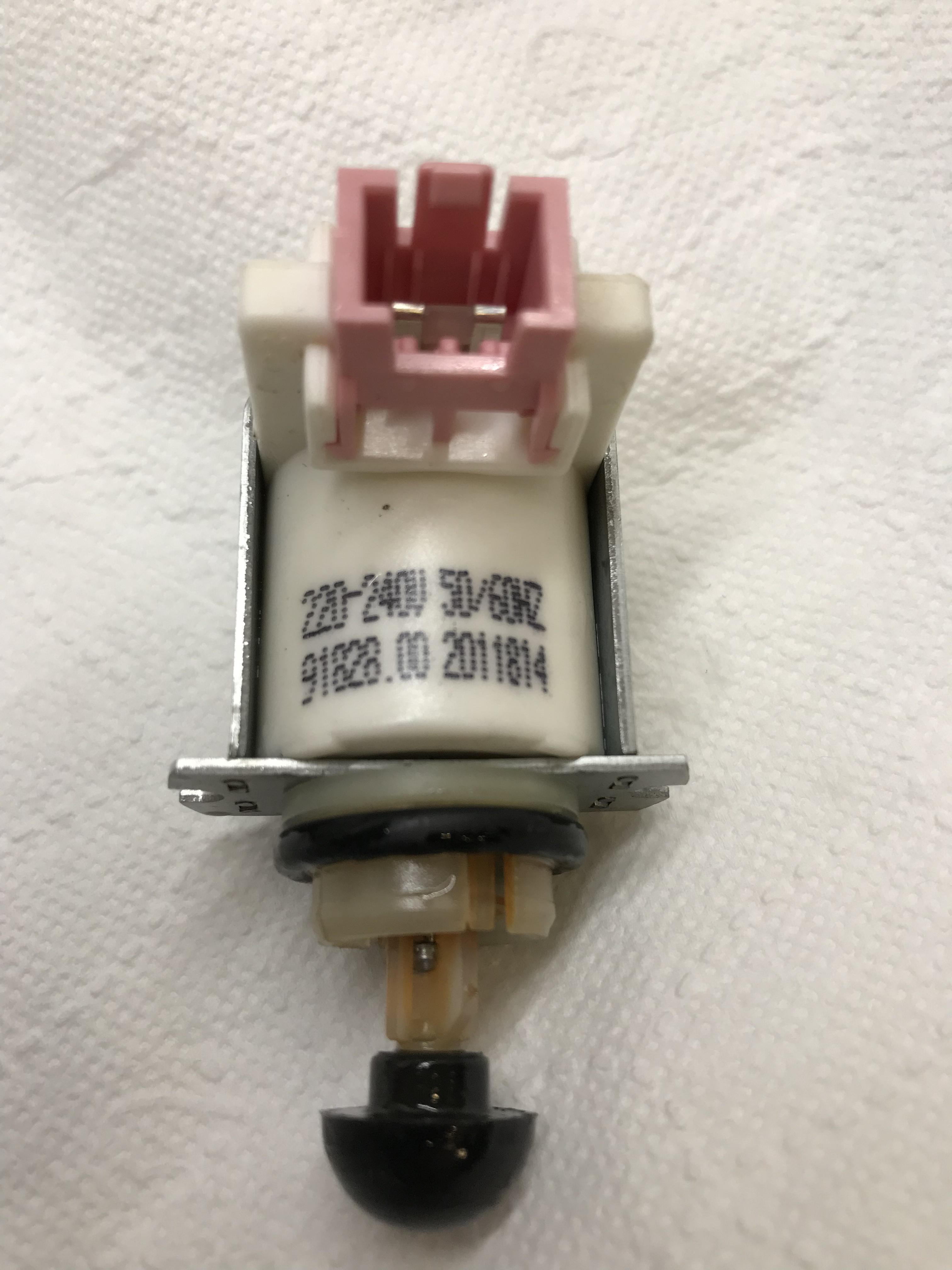

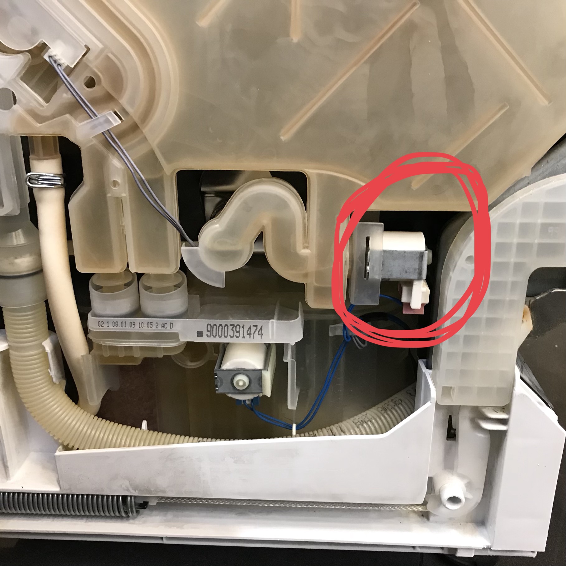

    Piotr2608, yesterday after removing the photo module and reconnecting the cubes, I released 2 cycles 45-55st and 65st and both passed without errors.
    The only thing that puzzles me is about halfway through each cycle, the water jacket on the left side of the dishwasher filled up and emptied several times (over and over again). The dishwasher then did the rest of the cycle and finished without error. But the water jacket was empty, and should it have been filled at the end of the cycle?
    I checked the solenoid valve at the bottom of this coat and it is operational (valve in the pictures).
    m.

    Let's leave the water coat alone - you're paying too much attention to detail right now.
    When you bought a dishwasher, was there water after the first wash or was it not in the water jacket?
    We are interested in the actual state of affairs. There are no errors yet, so wash calmly and watch the dishwasher, pay attention to which specific program the error code will appear on.

    Hmmm, I have no idea because I didn't take it apart :) but when about half a year ago after washing there was water at the bottom, I dismantled the dishwasher and it turned out that this valve was jammed and did not retain the water from the last rinse in the water jacket. After cleaning the valve, the water remained in the jacket after washing. Anyway, this is an element of water saving - it is used for the first rinsing - but ok, never mind, because it does not cause the e-01 error, it is the result of yesterday's observations.
