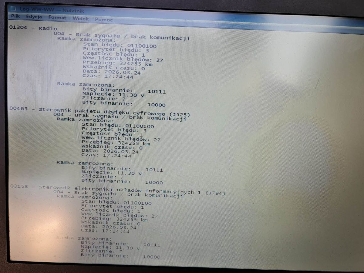

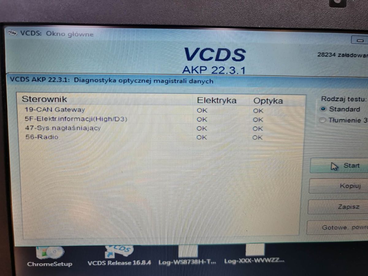

    I have a problem with the MMI. It is not working completely. It's black, nothing illuminates, nothing flashes.
    I did a fibre optic loop test and everything OK
    In gateway 3 errors
    No communication with radio 01304
    No communication with sound controller J525 00463
    No communication with information circuit controller J793 03158
    VCDS AKP 22.3.1 window showing optical data bus diagnostics results on a computer screen
    Laptop screen showing Notepad with MMI error log: no communication with radio, J525, and J793/J794 controllers.
    3d1953fb8
    Where to look for the problem? Greetings

    In my case, the module into which the memory card is inserted was defective. Mail order repair at a company that repairs navi and car audio equipment.
  • #20 21869574
    ROGU
    Posts: 45
    Rate: 30
    I saw that in your loop test there were EROR marks on the modules. At my place it is OK everywhere, yet it does not work. VCDS does not connect to the modules, in the gateway also communication errors with 3 modules. Could it be a gateway issue ?
  • #21 21869577
    kubas10
    Level 25  
    Posts: 2815
    Help: 42
    Rate: 1544
    Do a full readout of the gateway of all modules installed in the car and you will know. Gateway rather ok because you probably have communication with the rest of the vehicle ? Remember that you have several types of data bus in the car.

    The errors from the gateway are pictured

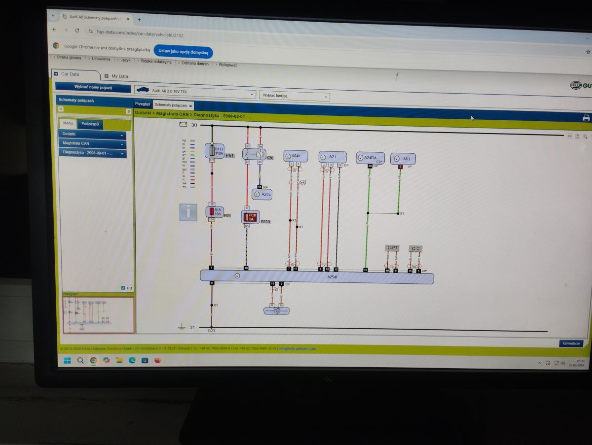

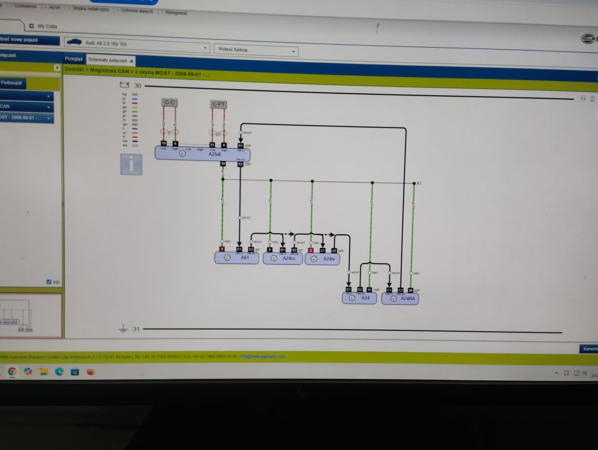

    Write the exact details of the car
  • #24 21869719
    ROGU
    Posts: 45
    Rate: 30
    A6 c6 2.0 tdi 2010r avant
  • #25 21869733
    kubas10
    Level 25  
    Posts: 2815
    Help: 42
    Rate: 1544
    Computer screen showing a CAN/MOST wiring diagram for an Audi, with modules labeled A25di and A61 Computer monitor showing a CAN bus and diagnostics wiring diagram for an Audi A6 in a web browser.
    Added after 1 [minute]:
    A25di is the gateway and A61 is the infotainment controller. Check that there is a connection between the two modules.
    As far as I hit with the schematics because there are several types of hi-fi systems in this car.
