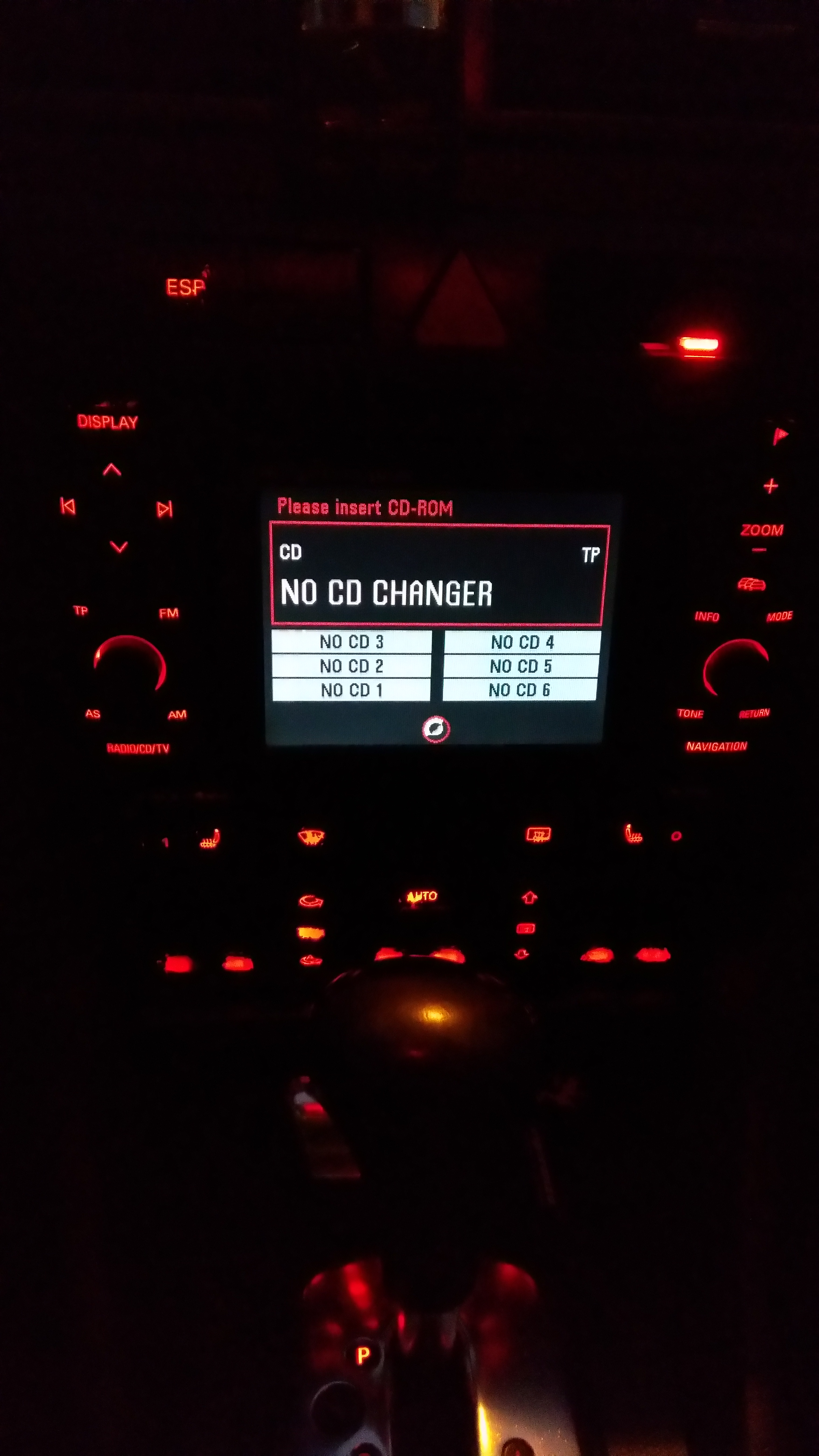

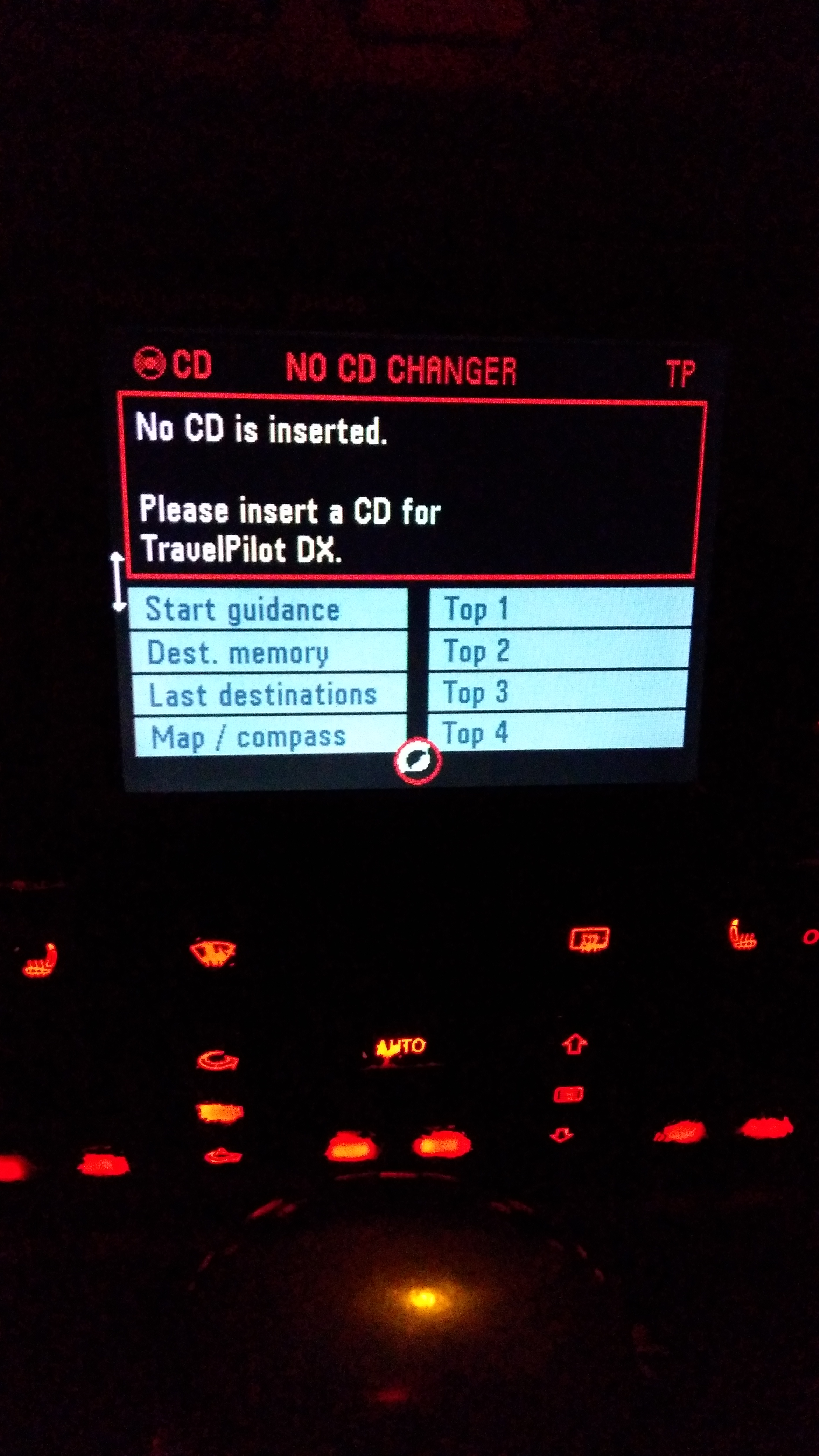

    Hello, I have an Audi A6 C5 2003. I bought it recently but the radio doesn't work
    Does not read CDs, navigation and TV also do not work.
    Can anyone tell me what could be the cause and how to fix it?
    • Audi Navigation plus CD - Navigation error plus CD reading error IMG_20180209_171801.jpg (1.46 MB) You must be logged in to download this attachment.
    • Audi Navigation plus CD - Navigation error plus CD reading error IMG_20180209_171834.jpg (1.77 MB) You must be logged in to download this attachment.

    From what you can see in the photos, you have the CD function running, and you do not have a CD changer connected. The built-in internal player is for navigation CDs only and does not read music CDs. The TV also requires an external receiver module to be connected. Analog TV modules were dedicated to this model, so you don't need anything after it.
    Switch the device to radio and check if it is receiving radio stations.

    I switched the device to the radio, it receives the stations but it is weak, often loses the signal.
    I still have a question, can I connect AUX to this device for now? Until I buy a changer?

  • #5 17410141
    Luan87
    Problem solved
    The radio itself does not read CDs, but CDs with navigation. I bought a CD changer and now everything works.
