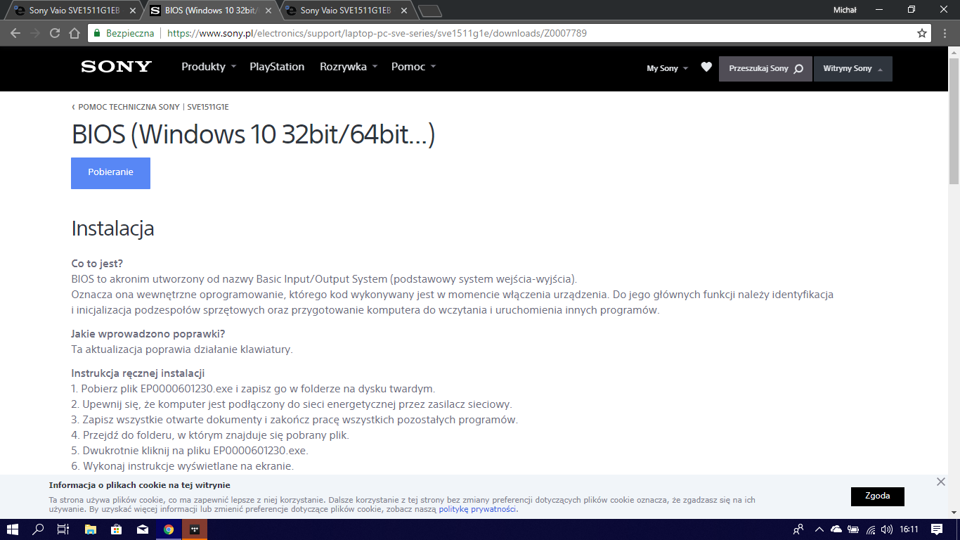

    I have a laptop sony vaio sve1511g1eb.
    My problem is that I can't access Boot Menu or even Bios.
    By default, this laptop should be entered by pressing the "ASSIST" button. But a few months ago I changed the drive to ssd myself and installed windows 10 with a pendrive. Since then, the "ASSIST" button mentioned above does not work. So my question is how to enter Boot Menu in a different way? :P
    I will add that with the key: Esc, Delete, F11, F12 does not work.

    mmichal25415
    Board Language: polish
    mistrzszymon1 wrote:
    Hold F2 and turn on the laptop :)
    Thread :/
    Added after 8 [minutes]:
    Maybe how would I update the BIOS?

    Okay, I'm closing the topic, because I managed to enter Bios so I can also get to the Boot Menu :P
    Solution (borrowed from another forum):
    (Translated by Google Translate :P ) "The procedure for entering the BIOS on a Sony S laptop with Windows 10 is not easy. You must perform the following sequence from Windows 10.
    Settings> Update and security> Recovery> Advanced startup: Restart now
    The system will prepare for restarting and select the following options.
    Troubleshooting> Advanced options> Startup settings: Restart
    The normal startup options are displayed at this stage and the restart button is at the bottom. Press the restart button and immediately press and hold F2. You will be taken to the BIOS screen.
    Note that the F2 key must be pressed before the first VAIO welcome screen appears on the monitor. If your laptop is too fast, you have no option but to log in to Windows 10 and start all over again. "
