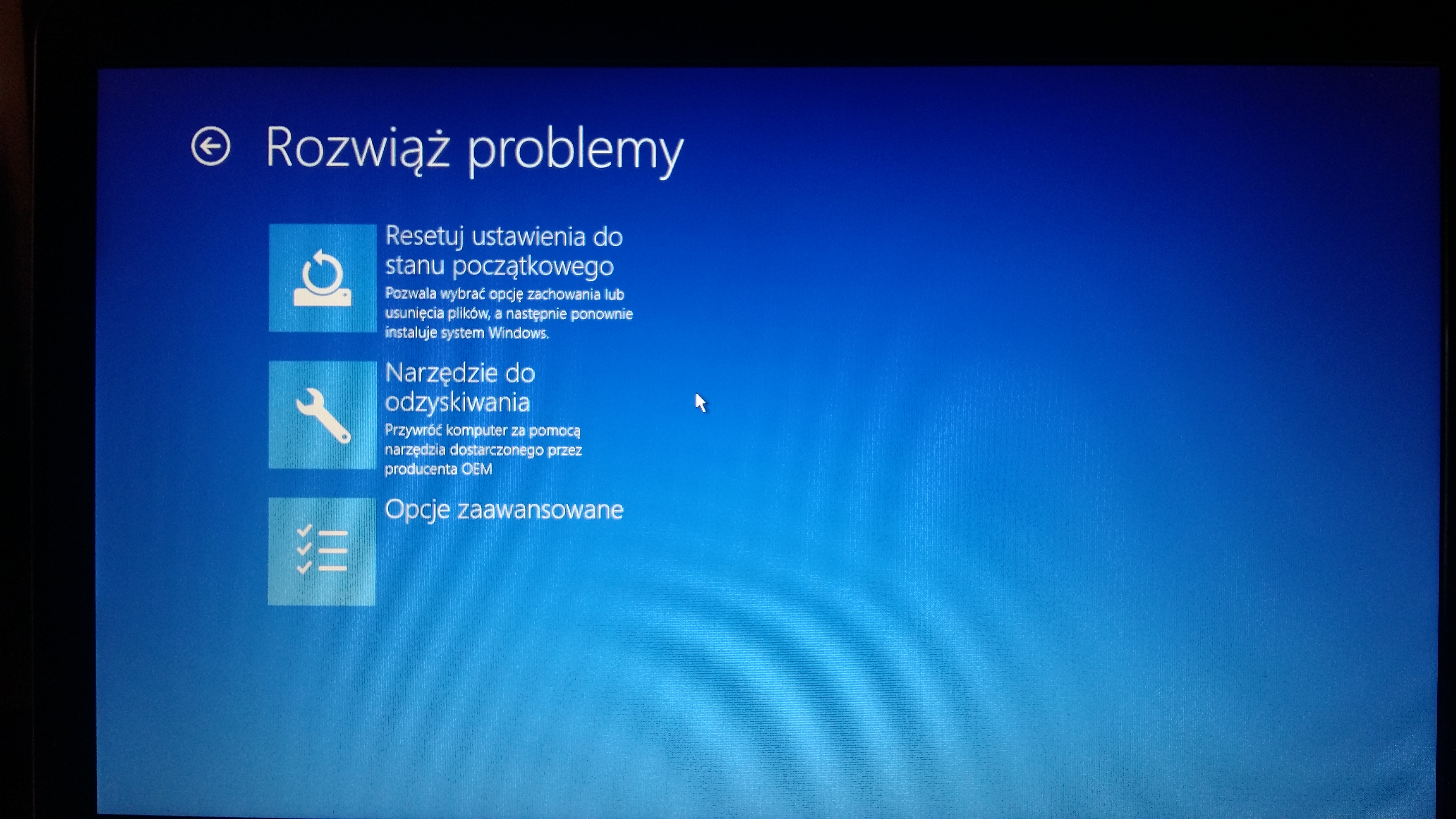

    The girl has a problem with her Vaio (model as in the topic). By default, when something happened to the system or the computer was silted up and not working anymore, she used the "Assist" button according to the instructions and the system was reset / installed again and that's it. Easy even for the less tech savvy - the equipment does everything for you.
    Unfortunately, after the last attempt to restore the system to its initial state, the computer did not wake up. On startup, a blue screen pops up as below, followed by a series of successive restore options (i.e. diagnosis and repair attempt) that end identically ...
    Sony Vaio SVF152A29M: System Installer Fails After Attempted Reset - Possible Fixes?

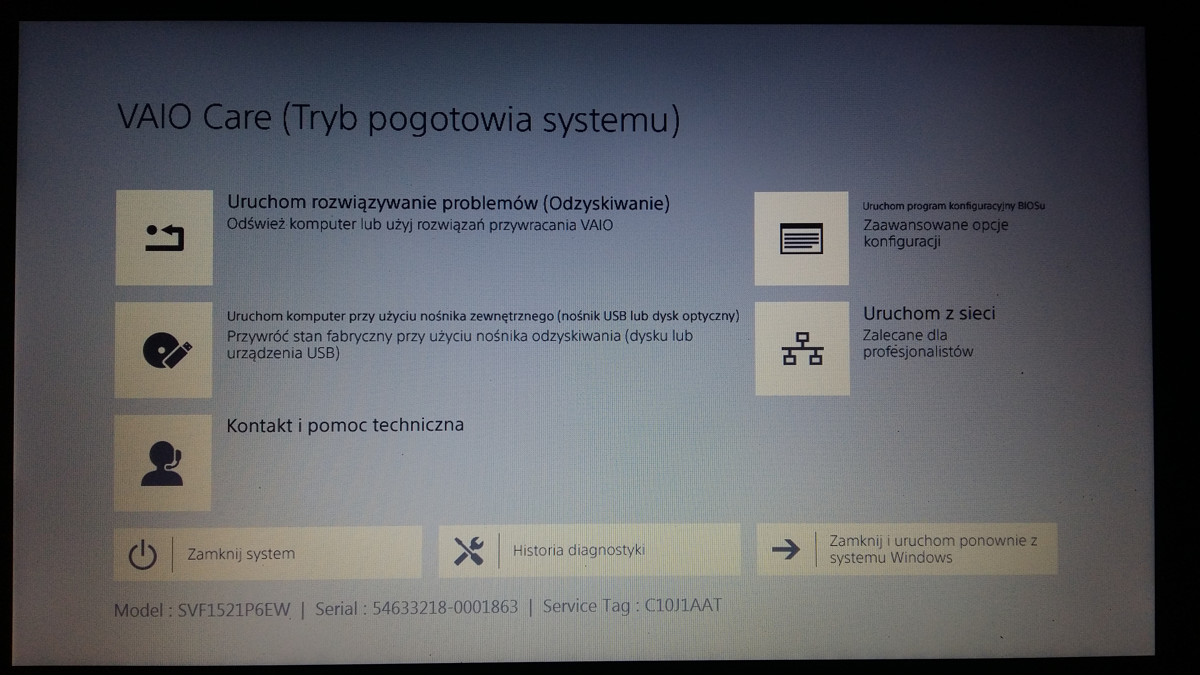

    I went through all the possible options but still the same. The computer is unable to proceed with the system reset.
    Reusing the "Assist" button is also not possible - it does not respond!
    Any ideas?

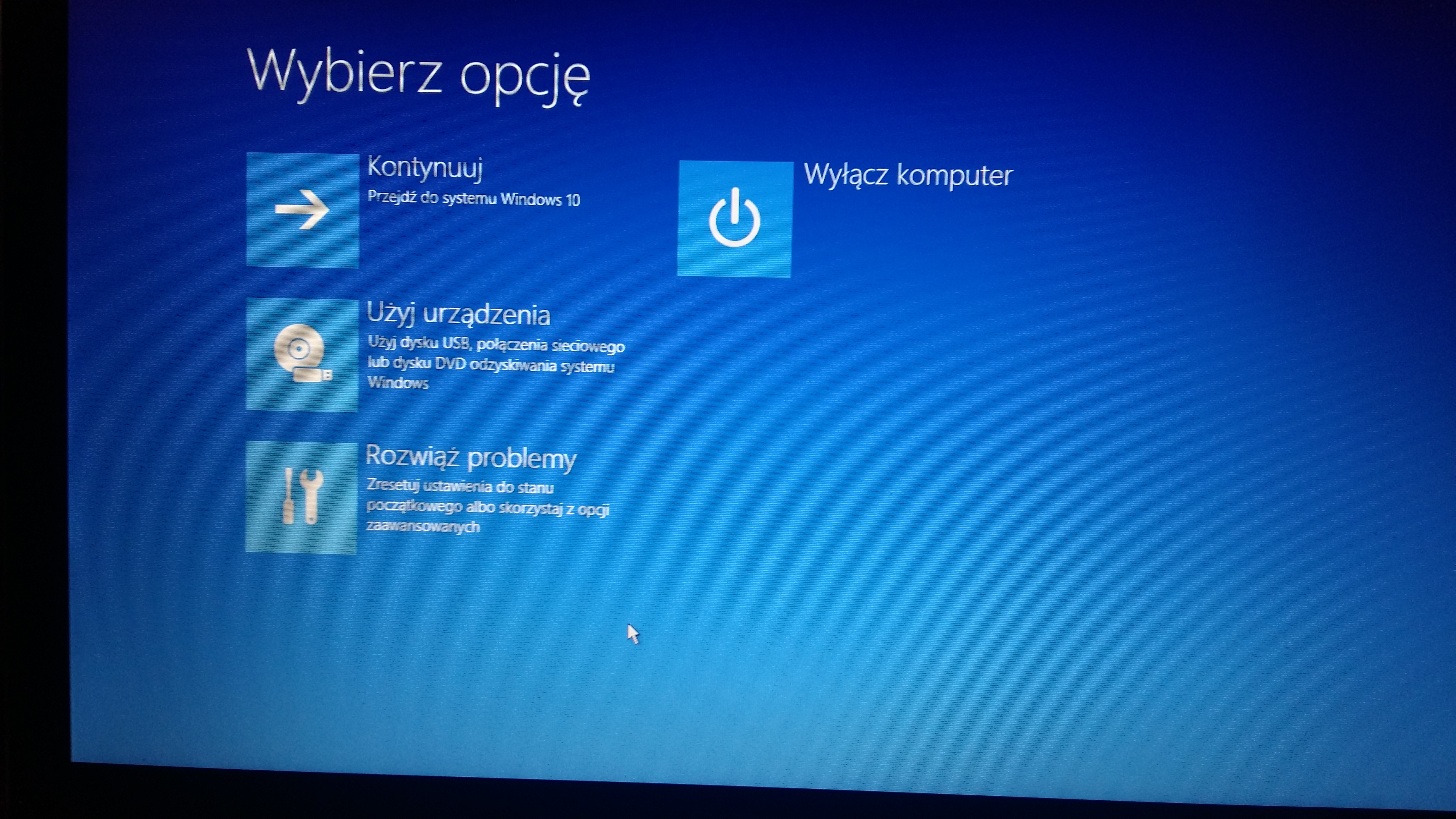

    The error you posted looks like windows 10, but I'm not sure.
    Try to go through the stages of starting the system 3 times in a row: error, finding solutions and attempting to repair, most likely after 2-3 unsuccessful attempts, windows will display additional options by itself, including just factory reset.

    So I got home and started on that unfortunate Vaio :)

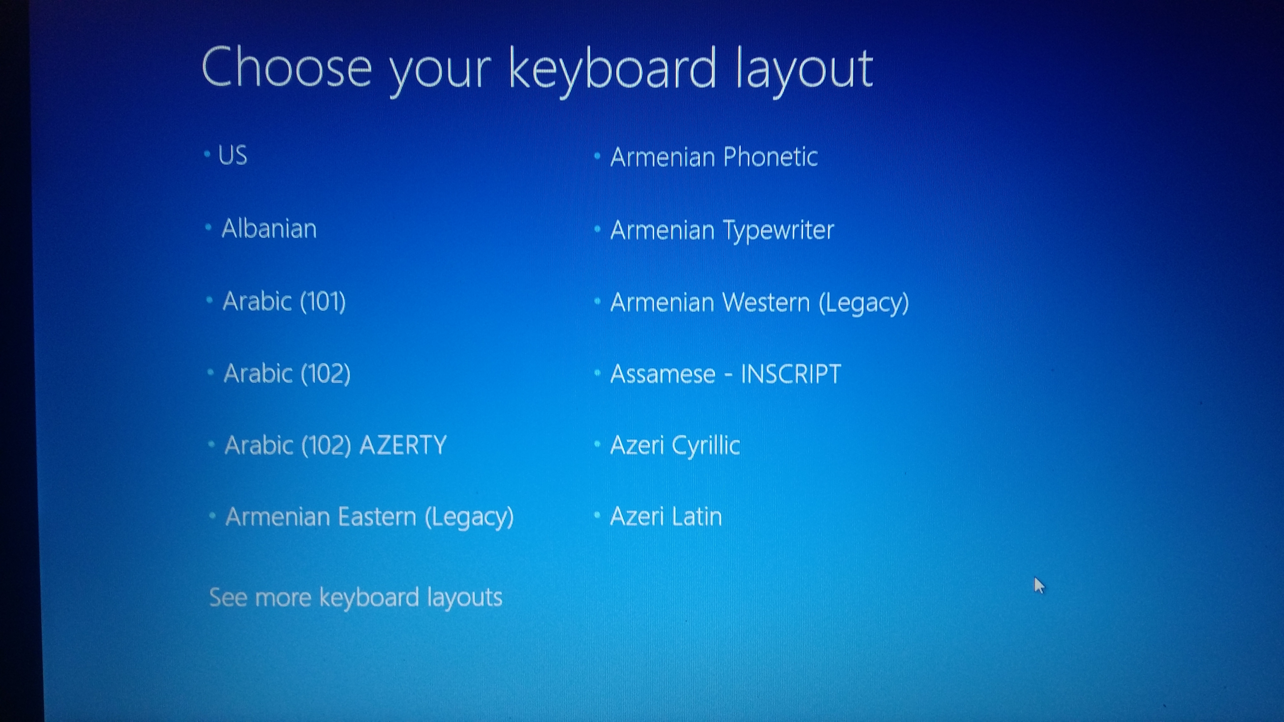

    I connected the Wi-Fi keyboard but unfortunately the system does not detect it and does not work :(
    I also did as you said and even went through a repair a few times but the system keeps going back to the same point, ie reboots and shows the same blue screen again. From this point, I have the option to go to additional options as below:
    Sony Vaio SVF152A29M: System Installer Fails After Attempted Reset - Possible Fixes? Sony Vaio SVF152A29M: System Installer Fails After Attempted Reset - Possible Fixes? Sony Vaio SVF152A29M: System Installer Fails After Attempted Reset - Possible Fixes?
    I have gone through every option of restore, reset to initial state etc. and each selection ends with the message that the system could not fix the problem.

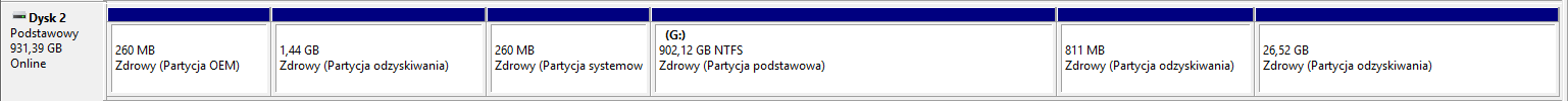

    So I took the disk out to see if I would be able to check its contents at all. I can see only one partition with system files / folders (the system did not wake up after the last attempt to restore it to the initial state by using the "assist" button). The foled structure looks like below, there is also a folder with the upgrade to Win10, but I don't know how to check if it was installed (I confirmed with my girlfriend, she says that there was no 10 installed, that the system after starting showed the so-called "tiles", i.e. it did not fire up to view desktop - this indicates Windows 8 / 8.1). However, it probably was because in the screen below there is an option 'Continue' -> Go to Windows 10 ;)
    I created a flash drive with a system image, I will try to fire it on this unfortunate computer and we'll see!
    In addition, this is the disk structure of this Vaio (main partition and all hidden - not visible from Windows)

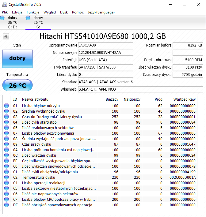

    Please take a look at the following report that I got after scanning the disk, what does that tell us?

    The hard drive is functional.

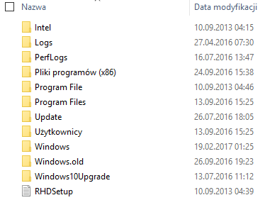

    bronxik wrote:
    There is no such file in the given location
    G: \ windows \ exploer.exe? Not to be confused with windows.old And what files do you have there?

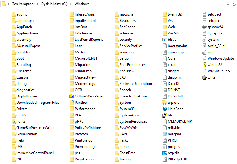

    Well, that's what we already know :)
    The files and folders that are in the Windows folder of this disk are like the screenshot below:

  • Test USB installation without disk, then remove partitions
    #10 16294508
    masterten
    Posts: 1470
    Help: 268
    Rate: 284
    You have "explorer" there - you can't see the file extensions, so you don't see it as "explorer.exe".
    He sneezes a bit with the keyboard, but we'll figure something out. Formatting the disk itself will not help, because the system will try to boot anyway.
    For the test, remove the disk and check if the installation from the flash drive starts correctly and the disk is selected. If so, only then can the disk be 'prepared'.
    The remaining partitions would be needed if you wanted to factory reset - from this hidden 26GB partition.
    If you do not want to save any data or the factory system, and the pendrive starts without a disk, you just need to remove all partitions from the disk, then the pendrive should start with the disk inserted.
    The system reads the key from the BIOS during installation, the key cannot be removed and does not expire, the license is lifetime. That is, for the rest of the laptop's life ;)
    If the key is windows 8, you will only install windows 8 or 10. If the key is windows 8.1, you will only install windows 8.1 or 10.
    As for the 'latest discovery', what drives do you have plugged in? Repair starts from the disk or from a pendrive?

    So yes, I started cleaning the disk myself, deleted all partitions and created new ones from scratch. The installer has started and the system is set up. I threw Windows 8.1, the installer did not ask for a key, so I assume that the license is still valid and it was loaded from the machine.
    Installed drivers, basic programs and applications as well :)
