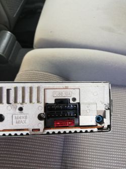

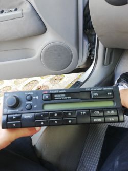

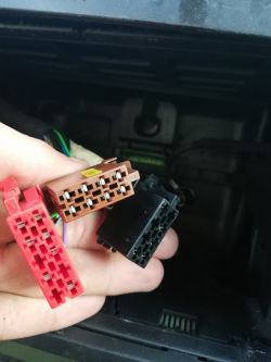

    Hello, I wanted to replace the original Gamma radio in VW Golf 4 with another one from Sony. The problem is that after removing the radio, there are 3 cubes and in this one with sony there is one input. Could someone write me what connector I need? I add photos of this radio and cubes . Thanks

    Hello. And this SONY radio does not have an original plug with an adapter for ISO plugs?

    Hello. The cube is missing for Sony.

    Well, unfortunately, there is none because this radio has already been connected to other cars and has disappeared somewhere; p
    Is it about this cube? I found a radio for this model
    https://allegro.pl/zlacze-sony-cdx-gt40u-cdx-...-gt560ui-i7518020903.html?.html?source=google Telmedium=cpc&ev_campaign=_ELKTRK_PLA_RTV+i+AGD&ev_adgr=Sprz%C4%99 PRODUCT + GROUP & utm_content = & gclid = EAIaIQobChMIj-Gjmb6e3QIV0-J3Ch3hSQFhEAYYASABEgILM_D_BwE & gclsrc = aw.ds & dclid = CMuxpZy-nt0CFdRIGAodPngPiQAodPngPiQ

    The radio model is Sony CDX-Gt40U

    @ stasek131 You have found a cube that will fit you with ISO plugs. You provided it in post # 4.

    ok thanks, and for it to work it's enough to hook these 2 cubes (brown and black) and red what should i do? Thread? :P

    Red free, was needed for the original VW radio.
