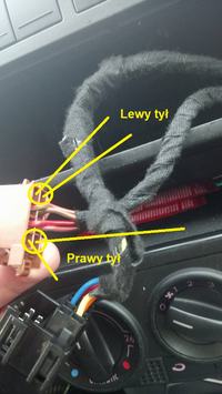

    I bought a VW Polo 2004 car, Pioneer TS-G1011i speakers are mounted on the rear shelf. Only the loudspeakers in the front doors are connected in the car. I have a Sony CDX-GT28 radio. In the attachment I sent pictures of the speakers, radio and the speaker connector. I am asking for help on how to connect it correctly.

    You need to pull the cables backwards and connect according to the ISO cube diagram. You'll find it on Google without any problem.

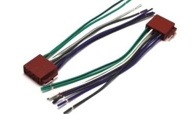

    First you need to replace the ISO plug (the brown one) with 8 wires.
    Connecting Pioneer TS-G1011i Speakers to Sony CDX-GT28 Radio in VW Polo 2004: Step-by-Step Guide
    I do not know if the polo has an original harness for connecting the rear speakers, if it is not there, just let the two cables run on the car's pillars and properly connect to the ankle with the correct polarity.

    kamilos ms wrote:
    if it is not there, just run the two cables on the car's pillars and connect them to the ankle properly
    There is no factory rear wiring harness in this car
