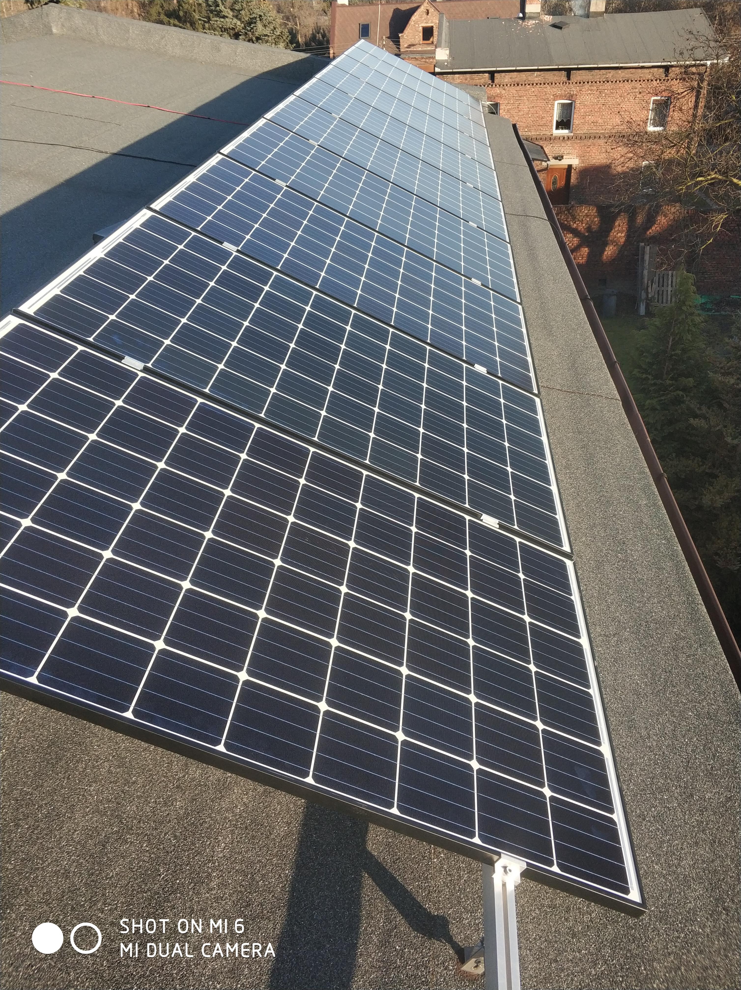

    Hello, I have a solaredge SE 3500 inverter and 8 solar panels mounted on the roof. The panels are without power optimizers. I found out that without them the inverter will not work. The question is whether it is possible to turn on my power plant without optimizers or whether it is possible to turn it off in some other way - a workaround for this problem. I do not need the optimizers too much because there is no option to darken the sun.

    This model does not have MPPT that is built into the SE optimizers. It won't move without them

    And did you connect the panels to the inverter?

    Yes . voltage from 290V DC panels. on the AC 232V side on the display - of course, the mains voltage is connected otherwise so that the inverter would not start. I have overloaded the network and it takes electricity from the network .... on the display where it is to show how much power is sending the inverter ..... unfortunately 0 .... The green LED is on as if everything is OK.

    290V DC is not too low? What range do you have on the plate?

    Nominal inverter voltage is 350V, 290V may be too low

    the manufacturer does not specify the minimum - the data includes the rated DC voltage 380 -max 480, but when I called the company that installs such inverters, they said that 290V is ok without any problems.

    I would advise you to replace the inverter with an inverter with MPPT.
    Added after 5 [minutes]:
    Try in the settings menu, maybe something is wrongly set.

    If it was ok, it would work. 290V is 60V too low for most inverters.
    Added after 3 [minutes]:
    If you have 38V panels, maybe consider buying 2 pcs.

    Solaredge won't work because it doesn't have a power tracker, MPPT. And you can not connect the modules directly because the warranty is void.

    So there is no chance that solaredge inverters will start without power optimizers. I have already connected the voltage of 290V to the inverter a couple of times and hope nothing happened. Due to the fact that it is not possible to solve this problem, I ordered optimizers and when I connect it, I will write whether it started or not. Of course, you have to configure it.

    I bought P 300 optimizers 8 pcs. because I also have so many 300W panels. After connecting, the inverter read in - programmed them, it took maybe 5 minutes and it started. So just like FankyKoval wrote, these kinds of inverters won't do without optimizers. Thank you all .
