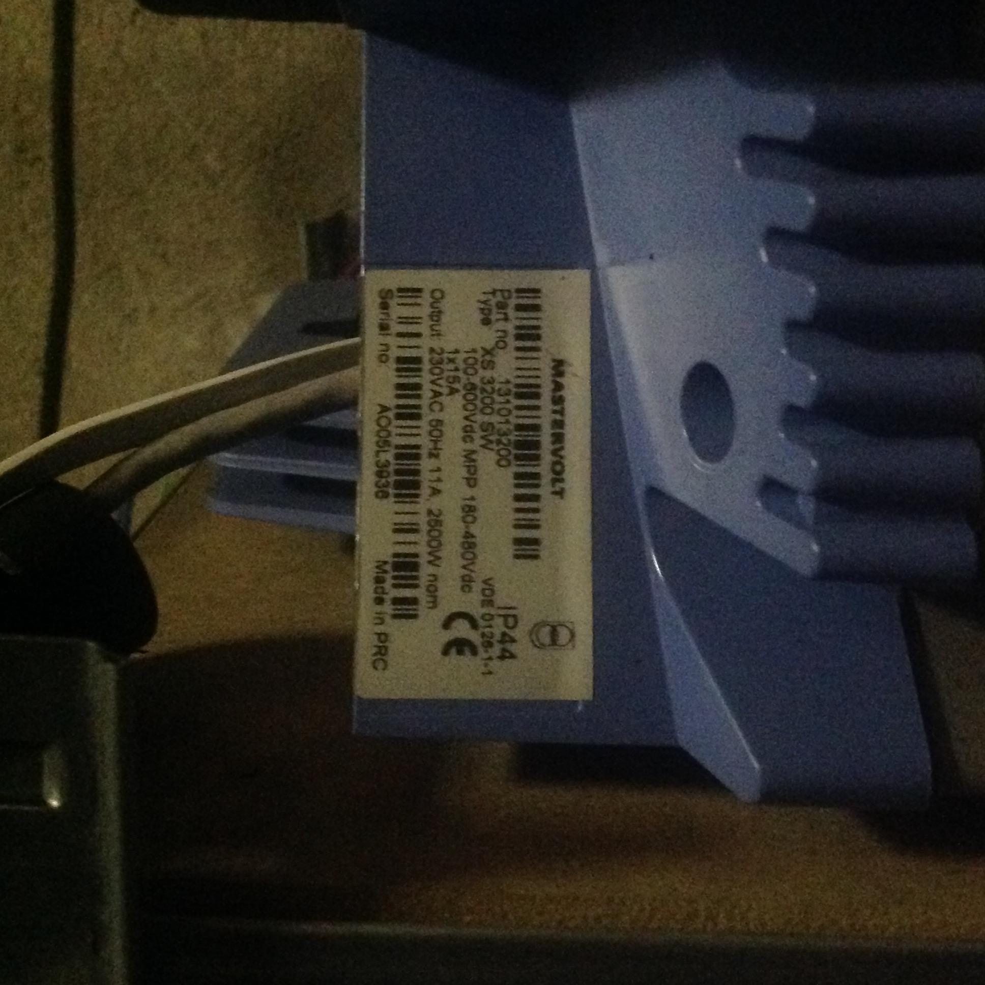

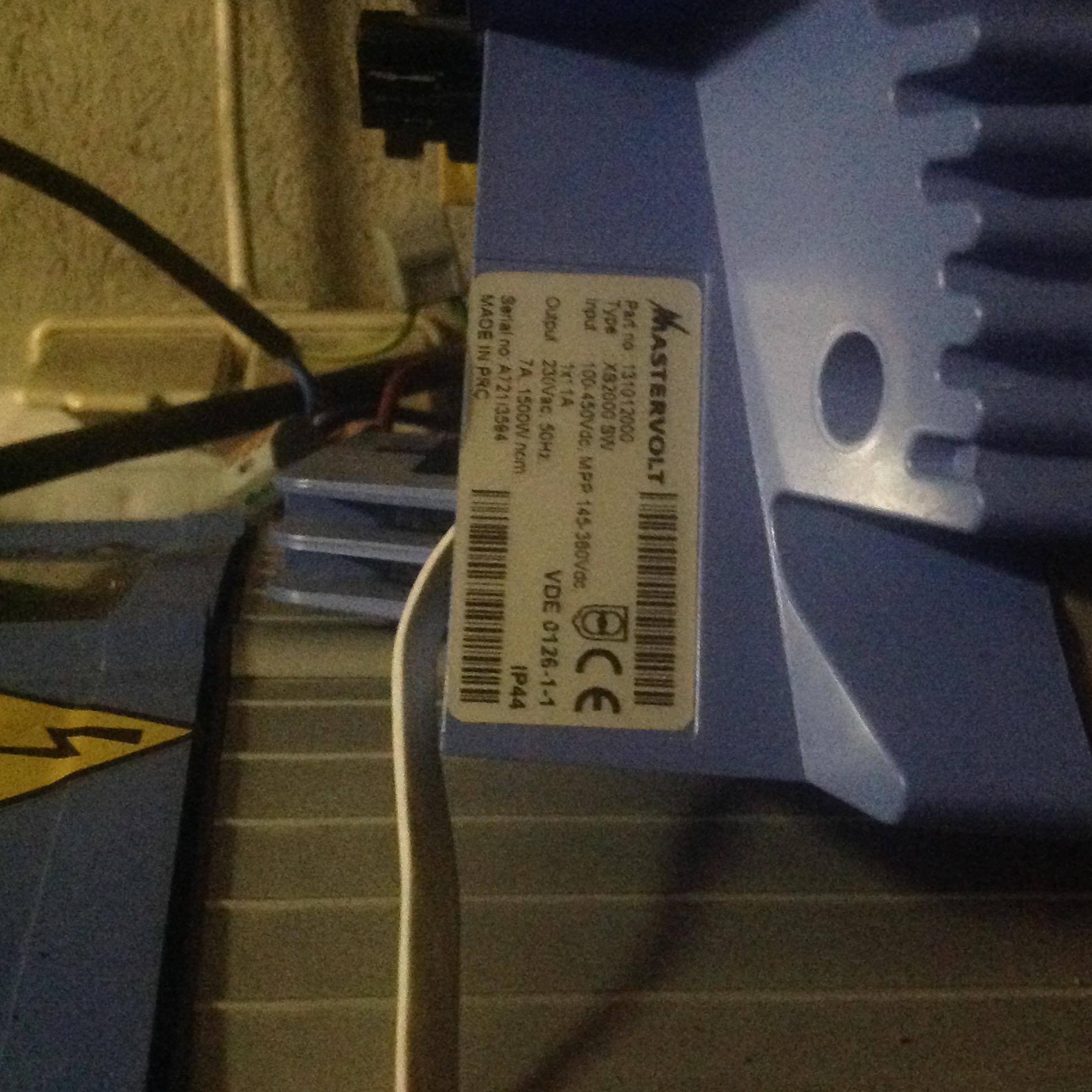

  • #10 16279164
    franekmigas
    Posts: 17
    Rate: 7
    2 examples from my installation. Optimal PV Panel String Connection: Inverter & Panel Parameters for 210-480V MPPT Voltage Range Optimal PV Panel String Connection: Inverter & Panel Parameters for 210-480V MPPT Voltage Range
  • #11 16279295
  • #12 16279385
    franekmigas
    Posts: 17
    Rate: 7
    I have 2 installations.
    1: Mastervolt XS3200 + 40 panels GS-50 (4 strings * 10 panels) max voltage 580V
    2: Mastervolt XS2000 + 4 panels Q.Cell Q.PRO - G4.1 265W (1 string), maximum voltage 140V
  • #13 16279452
    3301
    Posts: 2100
    Help: 224
    Rate: 869
    And don't you think that in the case of 2 installations you have a little too low voltage, in this MPP inverter the range is from 145V and you have 140 and maybe that is why the efficiency of the 2nd installation. is lower by approx. 1% than the installation. 1.
    Tomorrow I have to receive such an inverter only XS 6500, I will start testing it.

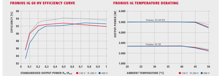

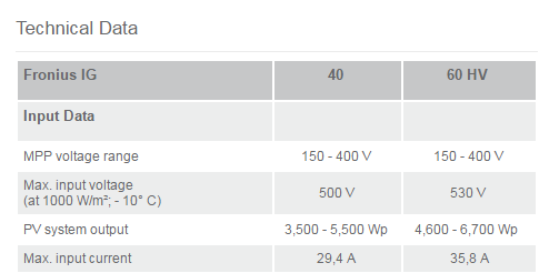

    #16 16279505
    prose
    Level 36  
    Posts: 3037
    Help: 173
    Rate: 850
    Here is a simple diagram that MPPT will not do everything on the example of the Fronius IG 60 HV inverter, giving the DC input max voltage is lost on production. Optimal PV Panel String Connection: Inverter & Panel Parameters for 210-480V MPPT Voltage Range
    Here is the inverter data.

    #20 16279548
    prose
    Level 36  
    Posts: 3037
    Help: 173
    Rate: 850
    I tried on high, low and medium and 280V as in the chart I got the best results, each inverter has its best working point at MPPT point.
