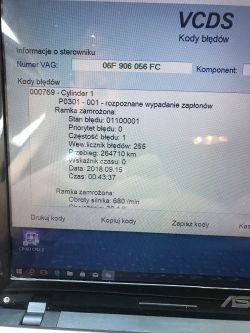

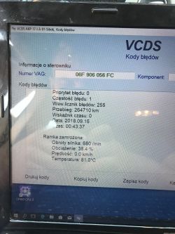

    Hello, I have a passat b6 with 2.0FSI code BVY 150KM. The car reached me with a non-smoking engine. Vag showed an error with egr ... after disconnecting it, the engine lights up normally and the suction works nicely :) while when the speed drops, the kennel works as if it were going to 3 cylinders ... on lightly pressed gas about 1300 turns it works perfectly. Currently, the error is from the mentioned EGR because it is disconnected (water got into the valve and everything rotten in it) can the engine go like this because of the disconnected valve? Physically the EGR is closed and tight. In the course of everyone feel nothing, power is.
    Unfortunately, I do not know how the car went before the fault ... maybe someone was already driving with such a jerk until he stopped smoking through this egr.
    - Compression pressure of 12 bar on each cyl.
    - A spark on every candle
    - Somebody has already cleaned the valves and carbon deposit
    - new pneumothorax tubes
    - I used a Pole on the suction manifold in search of leaks and nothing ...
    Sometimes an ignition fall out of 1 cyl. I changed places with coils and candles and still falling out of 1cyl. But this error only appears sometimes
    Have any ideas ?

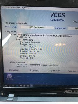

    Gentlemen, now I have ignition loss all the time. 1 I changed coils, I replaced candles on this Cyl. and nothing further: / VW Passat B6 2.0 FSI BVY Engine: Uneven Idle, EGR Error, Possible 3-Cylinder Operation VW Passat B6 2.0 FSI BVY Engine: Uneven Idle, EGR Error, Possible 3-Cylinder Operation VW Passat B6 2.0 FSI BVY Engine: Uneven Idle, EGR Error, Possible 3-Cylinder Operation

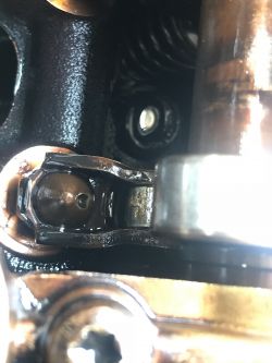

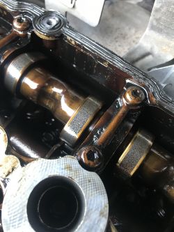

    Gentlemen, today I had some time and I dismantled the injectors and valve cover ... I saw such a view: / VW Passat B6 2.0 FSI BVY Engine: Uneven Idle, EGR Error, Possible 3-Cylinder Operation VW Passat B6 2.0 FSI BVY Engine: Uneven Idle, EGR Error, Possible 3-Cylinder Operation
    I understand that this is the reason for unequal work? :) the fights are also torn on the boxes ... a bit strange that the engine was running quite quietly etc. The roller from the pusher is rough but not oval, and the cam on 1 cylinder is in better condition than the one in the photo. The photo cam looks very worn, but as if the contact surface with the roller has no level difference with the places where the roller does not touch (golden edges of the cam)
    Is this a direct cause of unequal work ?? Why is all this worn down? Oil pressure is supposed to be ... no messages about its absence: / unfortunately I have nothing to measure it physically.
  • #13 17472453
    Don de Leon
    Posts: 837
    Help: 51
    Rate: 458
    I met with something like this, the engine was rescheduled and previously lay under a cloud. But I've also heard of cases where oil was to blame.
  • #14 17472615
    lukasz12345678910
    Level 30  
    Posts: 1321
    Help: 173
    Rate: 489
    Nothing special in newer VW, especially if someone observed the factory oil change intervals. But that's not the reason. Give these injectors to check.
  • #15 17472706
    niedzwiadek18
    Posts: 239
    Rate: 51

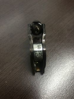

    Pusher from the first cylinder VW Passat B6 2.0 FSI BVY Engine: Uneven Idle, EGR Error, Possible 3-Cylinder Operation VW Passat B6 2.0 FSI BVY Engine: Uneven Idle, EGR Error, Possible 3-Cylinder Operation
    However, it is round :) so it probably fulfills its function ...
    As for the injections, I already have them on the table and tomorrow I will try to check them by home methods (compressed air with the addition of fuel + 12v to open the coil), maybe you can find out more about their condition :) you can see that someone has fought hard with this engine: / because everything is stuck with silicone :) ) lid gasket + silicone, intake manifold gasket + silicone, INJECTIONS stuck onto silicone!

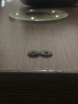

    Toy car repaired! It's perfect :) it didn't leave me alone :) I dismantled the fights, the chain and played a variator out of curiosity to see how it looks inside :) it turned out that there is something like a washer with a notch and a spring :) for me, the washer was wiped practically evenly and wedged in the hole in which it should work loosely (I compared the appearance of the center with the film on youtube) :) I bought a damaged variator, translated the washer and the engine works perfectly :) additionally, I cleaned the strainer which is between the head and the timing chain housing :)
    Comparison of washers VW Passat B6 2.0 FSI BVY Engine: Uneven Idle, EGR Error, Possible 3-Cylinder Operation
