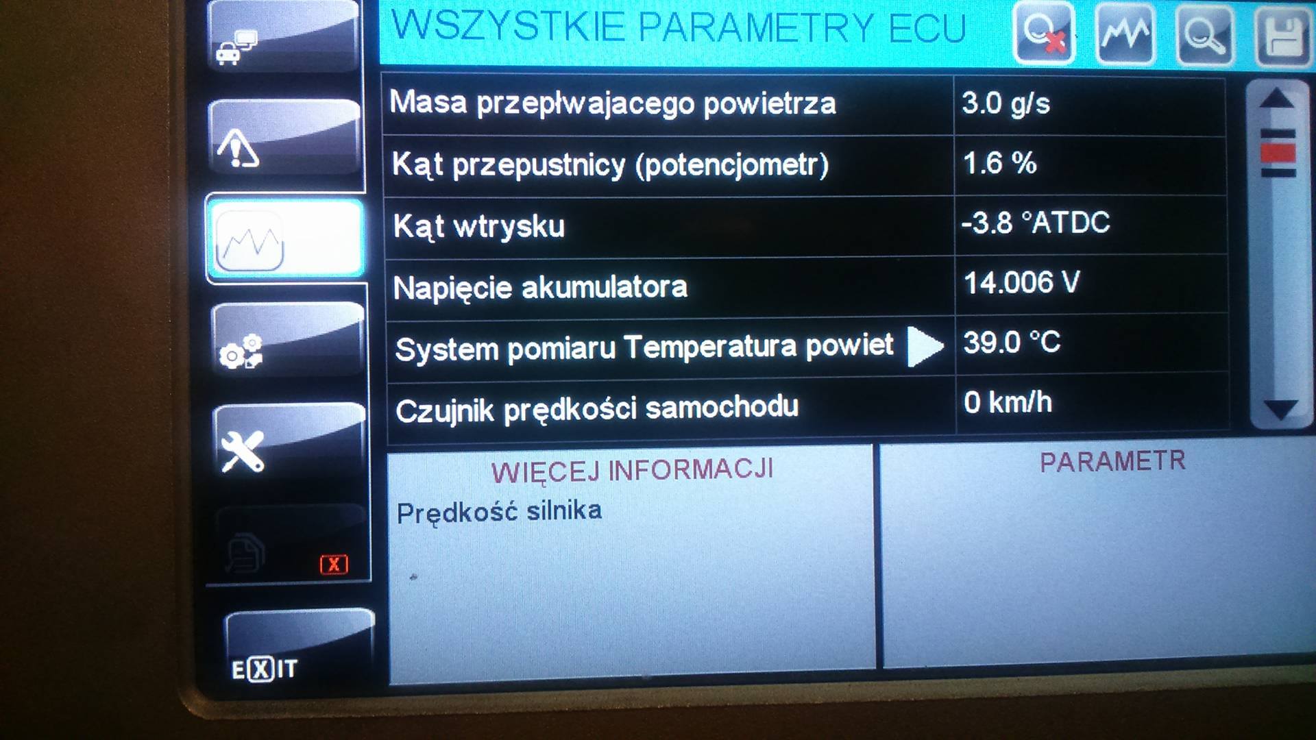

    As in the title, the car is at ease, it jerks / vibrates from time to time, the dual mass was replaced so it is not her fault.
    In addition, the car smokes, let's say, such a gray color, no matter if it is hot or cold.
    Well, and in my opinion somehow it collects so late from 4,000 rpm

    Was the fuel pressure measured? Pressure gauge and tester level?
    Then the tightness of the inlet to be checked.
    Errors are canceling? Are they back right away or after a while?

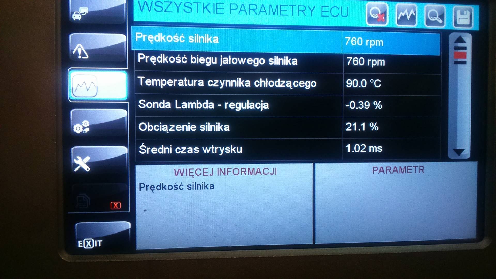

    Fuel pressure measurement has not been done - it will be done
    the mistakes come back after a while, i.e. when I drive the car.
    I still have something like that;
    Passat B6 2.0 TFSI 200KM: Experiencing Jerks, Vibrations, and Gray Smoke Emissions Passat B6 2.0 TFSI 200KM: Experiencing Jerks, Vibrations, and Gray Smoke Emissions Passat B6 2.0 TFSI 200KM: Experiencing Jerks, Vibrations, and Gray Smoke Emissions

    Parameters in the norm.
    It is possible that the timing chain is pulled out, as the car has more than 50kkm.
    Enter the engine code.
    Take a diagnosis to someone who has equipment dedicated to this car.
    VCDS, VAS.
