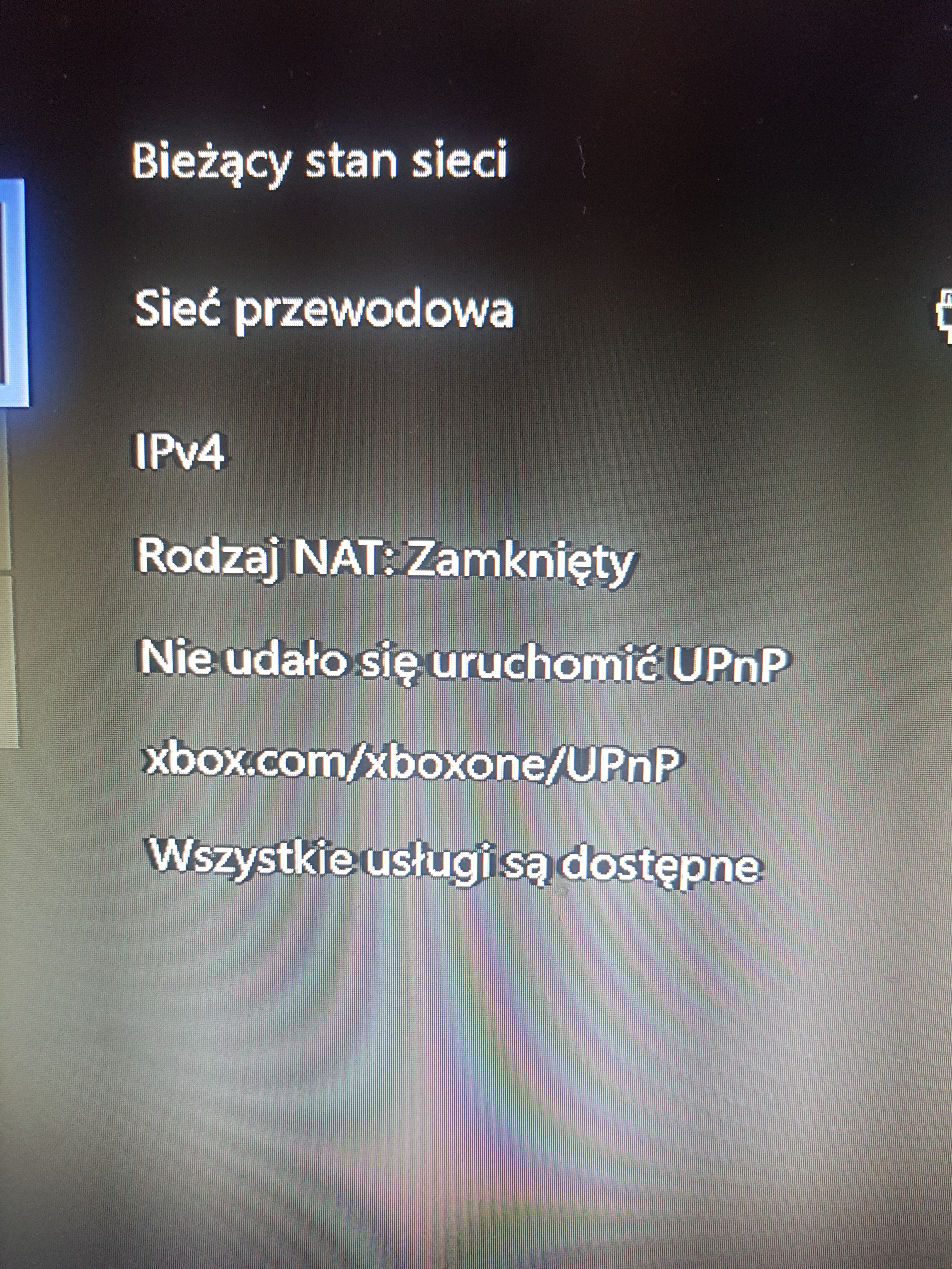

    I have a problem with the internet on xbox one s. The internet was working normally for a month, I could play online normally, but for two days I can't because, it pops up that I have closed NAT. How to open it? I have a Cisco modem and a TPLink WR740N router. I would like to add that at the beginning of buying the console (slightly more than a month ago) I had the same problem, but after logging in to the router, there was some NAT option and I turned it off, now I can not find such an option and I have already searched for a million times. Thanks in advance for your help.

    There is a UPnP service in the router under the Forwarding tab, enable it if it is disabled. Cisco is also NAT in your network or is it transparent?

    Status enabled. As for Cisco, I do not know, can I check it somehow? Closed NAT, Double NAT on Xbox One S: Open NAT on Cisco Modem & TPLink WR740N Router?

    I don't know if it's in anything Closed NAT, Double NAT on Xbox One S: Open NAT on Cisco Modem & TPLink WR740N Router? will help, but if I connect via cable, I have this info

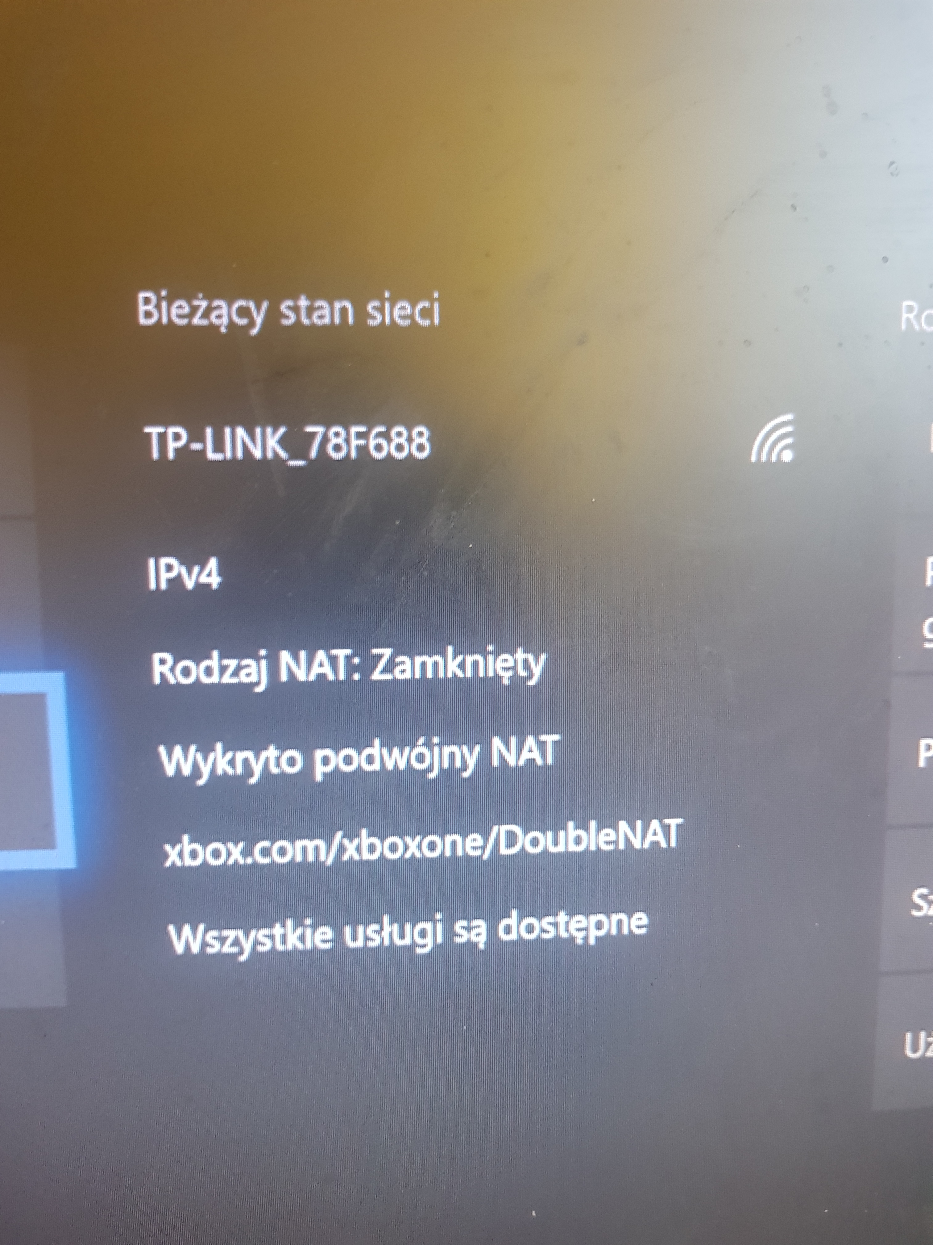

    And when it connects wirelessly Closed NAT, Double NAT on Xbox One S: Open NAT on Cisco Modem & TPLink WR740N Router?

    There are several ways to troubleshoot a double nat, but there are solutions that always work and those that only might help.
    Double nat arises when on the way from us to the Internet there are, for example, two routers, i.e. at our home and another at the Internet provider, i.e. at the other end of the cable (or radio link) that enters our home.
    A solution that always works is the setting of the public (external) IP for us by the provider and setting the so-called demilitarized zone on our home router, i.e. DMZ on the IP address permanently assigned to our Console (address reservation).
    And here are some important comments:
    If our provider sets a public IP for us, it does not automatically mean that on our router at the WAN input, the public IP will be downloaded from the provider. Our router will still be able to get internal IP within the provider's internal subnet. For us, public IP means that this public IP leads only to us, i.e. whatever appears on this public IP will go to us, i.e. as if all ports were redirected to our router. Of course, there may be a network where our router will immediately download the same public IP that is visible on the IP checking pages, but this is not a necessary condition and in many cable networks all users get the local IP internal to their router and still have public IP outside and This is fine.

    It is best at the beginning to believe our provider that we have external and assigned only to our IP to run DMZ and check NAT.
    Having a public IP and setting the DMZ for the IP that our router assigns to the Console via DHCP or that we have set hard for this console 100% solves the problem with double NAT which is then 'NAT Open'
    Any other combinations like port forwarding, DMZ setup with us but no public IP etc. may or may not help. If external IP and DMZ work, you can possibly be interested in these port forwarding and disabling DMZ, but I would not exaggerate with demonizing DMZ. If we open the necessary ports for consoles and games, we will be exposed to the same attack as with DMZ only in theoretically narrower range and no problem. Theoretically, because the console itself has all unnecessary ports closed, so after opening the ports without DMZ, the difference is only in the ports that the console is open for other needs (e.g. service) than games.
