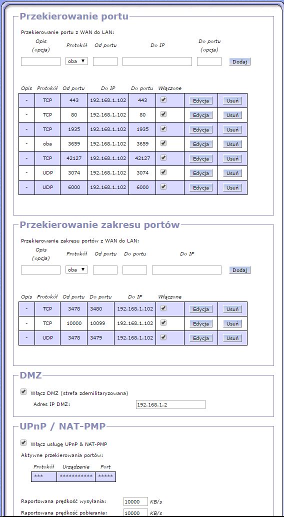

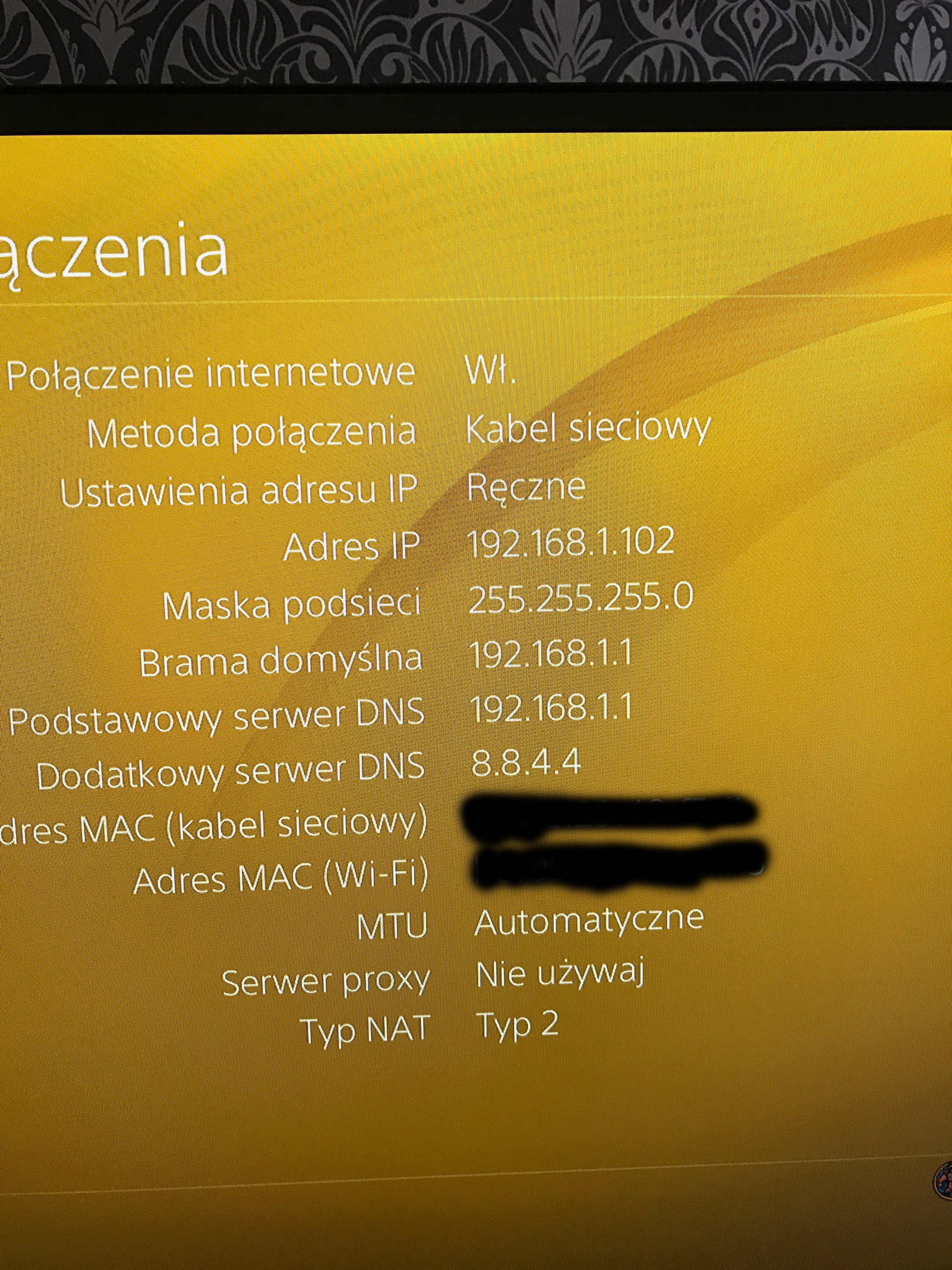

    I have a problem with the setting on the NAT type console / router: 1. All the time I have Type2 despite opening / port forwarding, setting the DMZ zone.
    Settings on the router and console are shown in the attached images.
    The neta provider is vectra, which set the router to bridge mode. What am I doing wrong? What is wrong?
    • Achieving NAT Type 1 on PS4: Port Forwarding, DMZ Setup, Router & Vectra Provider Bridge Mode 2EB2A680-EC0C-43EA-88FC-A2961C2E23FB.JPG (12.78 MB) You must be logged in to download this attachment.
    • Achieving NAT Type 1 on PS4: Port Forwarding, DMZ Setup, Router & Vectra Provider Bridge Mode NAT.JPG (104.87 KB) You must be logged in to download this attachment.

  • #6 16447931
    jimasek
    Posts: 35287
    Help: 3783
    Rate: 2681
    In the pictures you can see the first error in DMZ you have set the address 192.168.1.2 and the console has an IP address 192.168.1.102 which causes that all traffic (all queries from outside) go to 192.168.1.2 - port forwarding does not work if you have DMZ set.
  • #7 16448127
    snake1989
    Posts: 75
    ok, I changed the DMZ. Nevertheless, it does not give anything.
    I tried to enable DMZ and disable based only on port forwarding but then on NAT type 2 console.

    Did you reboot the router? Did you check whether the IP on the console changed?
  • #9 16448437
    snake1989
    Posts: 75
    I just made the reboot a console ip and set it up rigidly by hand

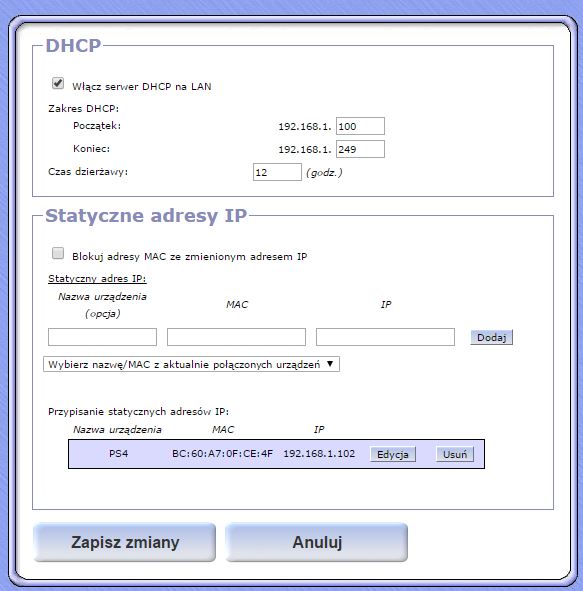

  • #10 16448443
    jimasek
    Posts: 35287
    Help: 3783
    Rate: 2681
    So what happens to this NAT? I understand that you have configured DMZ for the console's IP address?
    snake1989 wrote:
    I set the console reboot a ip rigidly by hand
    A better solution is to book an address in the router's DHCP, because it can sometimes happen that the IP addresses conflict in the local network.
  • #11 16448453
    snake1989
    Posts: 75
    I have something like that.
    That's it?
    • Achieving NAT Type 1 on PS4: Port Forwarding, DMZ Setup, Router & Vectra Provider Bridge Mode Przechwytywanie3.JPG (54.17 KB) You must be logged in to download this attachment.
  • #12 16448552
    Rognor
    Posts: 521
    Help: 78
    Rate: 120
    Here's the answer: http://manuals.playstation.net/document/en/ps4/settings/nw_test.html
    "Type 2: The system is connected to the Internet with a router".
    I have never got better on the Playstation than NAT2 (because I always have routers). Max, what you can do is give your console to DMZ. While forwarding port 80 TCP is nonsense, you do not have a web server on the console, also others are pointless, probably only UDP is necessary: 3478, 3479, but I have not played with it for a long time (straight: DMZ console and observation - traffic log of all packages then you will see that nothing goes to 80 TCP, and it goes out there).
