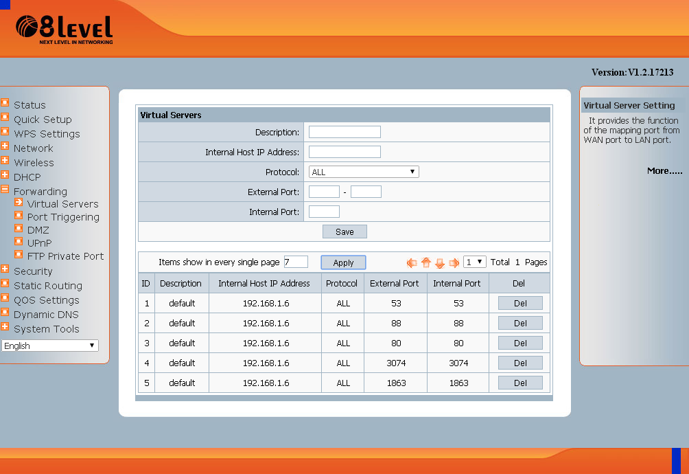

    KOCUREK1970 wrote:
    KOCUREK1970 wrote:
    You need to find out what ports the game needs to be open and enter them into the router.
    And start the UPnP function (if available on the router).
    I did this, typed all the ports and turned on UPnP, but still can't play with some people as if nat is still "closed".
    And in the 1st post I wrote what the UPnP testing program showed me and there were 2 bugs and I don't know how to get rid of them, so it looks like UPnP is not working. I wonder if I should just call the internet provider, because maybe the problem is with the internet itself or the radio receiver.

    You set up a virtual server.
    You redirect ports to Port Triggering.

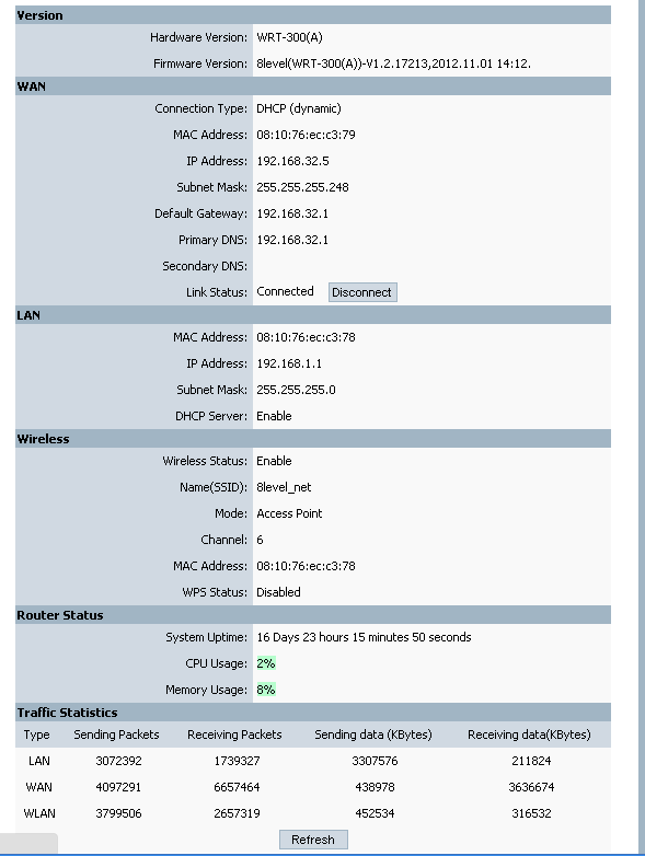

    Router status screen:
    Setting NAT to Open: Guide for Xbox Live, Port Forwarding, and UPnP Test Program Results
    In this guide, what I gave the link was to do just that and my friend did and it works for him, but now I will try port triggering and say if it is ok :)

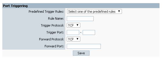

    Before I do that, this question: If I want to eg open port 53, what should I choose in the "Predefined Trigger Rules" field and what should I enter in other fields?

    And port 53 is opened for UDP or TCP?
    You enter here:
    I do not know this equipment ...
    Expand the list of this bar, or choose nothing, skip this paragraph, and enter what you need only where I have circled.

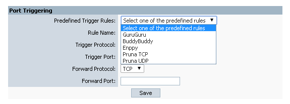

    Ok, after expanding:
    Ports I need to redirect:
    Port 88 (UDP)
    Port 3074 (UDP and TCP)
    Port 53 (UDP and TCP)
    Port 80 (TCP)
    Port 1863 (UDP and TCP)
    So I understand that if there is udp and tcp, I should redirect twice only once with udp and once with tcp?
    Do not enter anything in Trigger Protocol and Trigger Port?

    Okay, I think I know what the problem is, I checked my ip http://whatismyipaddress.com/ on this page and I have another ip in the router status, i.e. I have a private ip, so I guess the only thing I can do now is contact the internet provider at assignment of public ip. Do you know what this allocation of a public address looks like and do they do it at home or come to the client's home?
    Exactly.
    It is a momentary port opening,
    while port forwarding is permanent.
    I thought ... and reset the router, just in case of "W" write down the current configuration and see if it gets the public IP then. If so, set what you need now where we got to where what enter.
    You probably have a radio net ...
    Since the ISP offers a private IP, it "rather" won't give you a public IP - maybe I'm wrong ...
    This is done remotely (IP allocation).

    I have radio internet in a housing association in my city. There is always a problem with ip on radio internet? If I could not reset the router, I will call the cooperative and ask if they would assign this public address. I was looking at their site and they have a permanent ip for free in their services. Does this have anything to do with my problem? If they do not want to grant me a public ip, I can change the supplier, I even thought about it, because the competition has a more profitable offer. But how is it with this internet radio? Better to take cable? Tomorrow I will reset this router and write as it is, although I reset it some time ago and as there were problems with the internet, they still are.

    A fixed IP is not the same as a public IP ... to run the server you need a public IP, and you usually have to pay extra for it (if it is available at all).
    Ports are redirected in Virtual Servers, Port Triggering is used for something else, but UPnP itself consists in the fact that the application can add the necessary redirects itself.
    Port triggering is the redirection of the indicated port to the address of the host that opened the connection to the indicated port (trigger). If it is to be a typical server that does not open anything itself, but listens for connections, then you need to use virtual servers - the computer on which the server is running should have a fixed IP address (it can be associated with MAC on DHCP).
