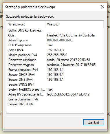

    TP-link TL-WR841N Router Configuration Issue: WiFi Working, No Internet on PC via LAN Port This is it? : p

    I doubt this is a matter for the operator. Rather router configuration. If the net works connected to the lan port and the computer via the cable (router as a switch), the main address is assigned to one device, therefore the net works only on the computer because there are no other addresses to assign. In the WAN configuration (static ip - if the router does not catch the same after the reset with the WAN cable plugged in), enter the address assigned to the main network device, i.e. the antenna, and it should work. The cable from the Internet must be connected to the WAN. In fact, I also had a problem with the Tenda router once. It lost packets on the older model of the router. After buying a new version, it flashes nice (INEA FTTH). There have never been problems with TP-LINKS (just in my case).
    Added after 4 [minutes]:

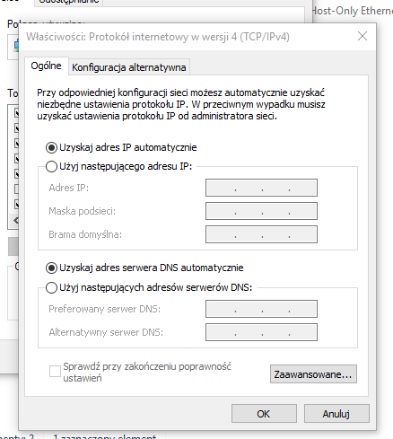

    I don't think it was exactly that. To configure the connection, go to the network card that is connected to the router and go to "Details". What was posted here allows you to manually configure the card. And if there is Internet, the card has correctly detected the connection
    If the IP address is different from 192.168.xx (i.e. DHCP does not work properly or windows used auto-configuration), only inform about it (the main address is not given on the forums)

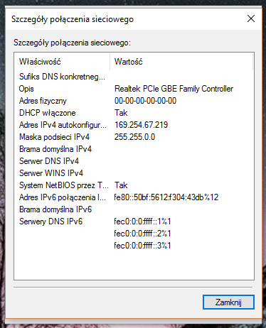

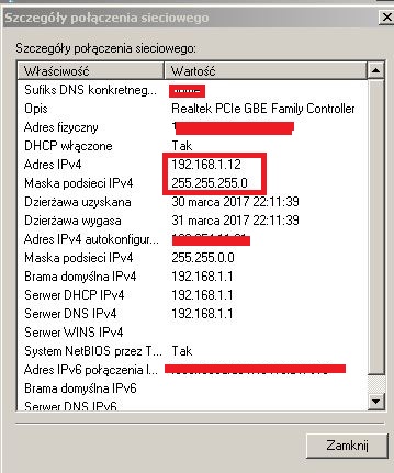

    I had a tendency but it started to crash after reinstalling both Windows and Linux so I figured it was time to switch to TP-Link.
    ^ With an internet cable connected to the LAN port.
    ^ And here is when I plugged into the WAN port. generally, my supplier recommends connecting the cable to the Lan port (that's how it is at my uncle's), but Wifi works without any problems.
