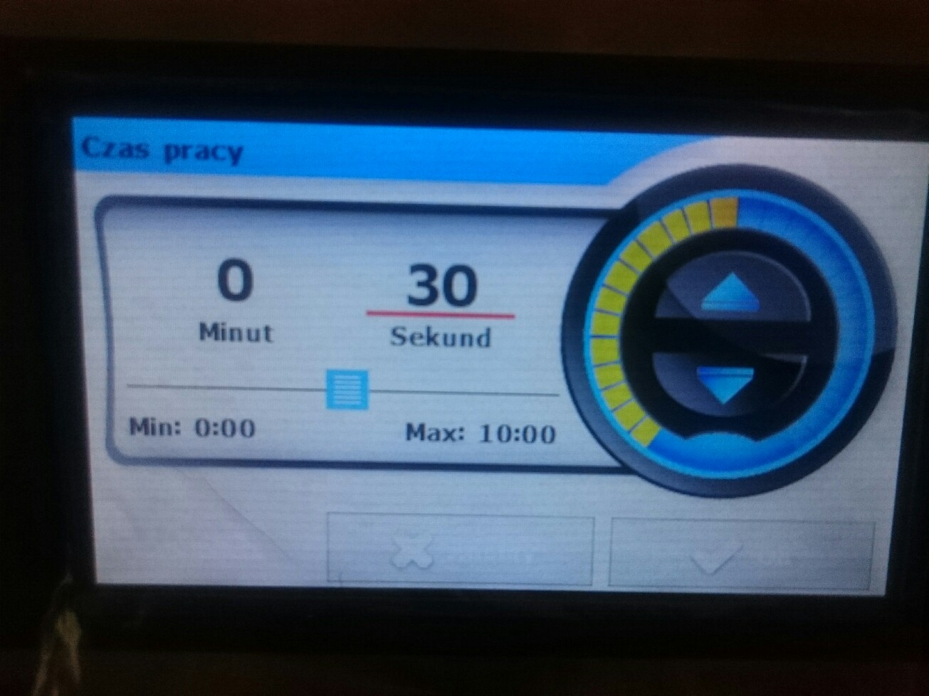

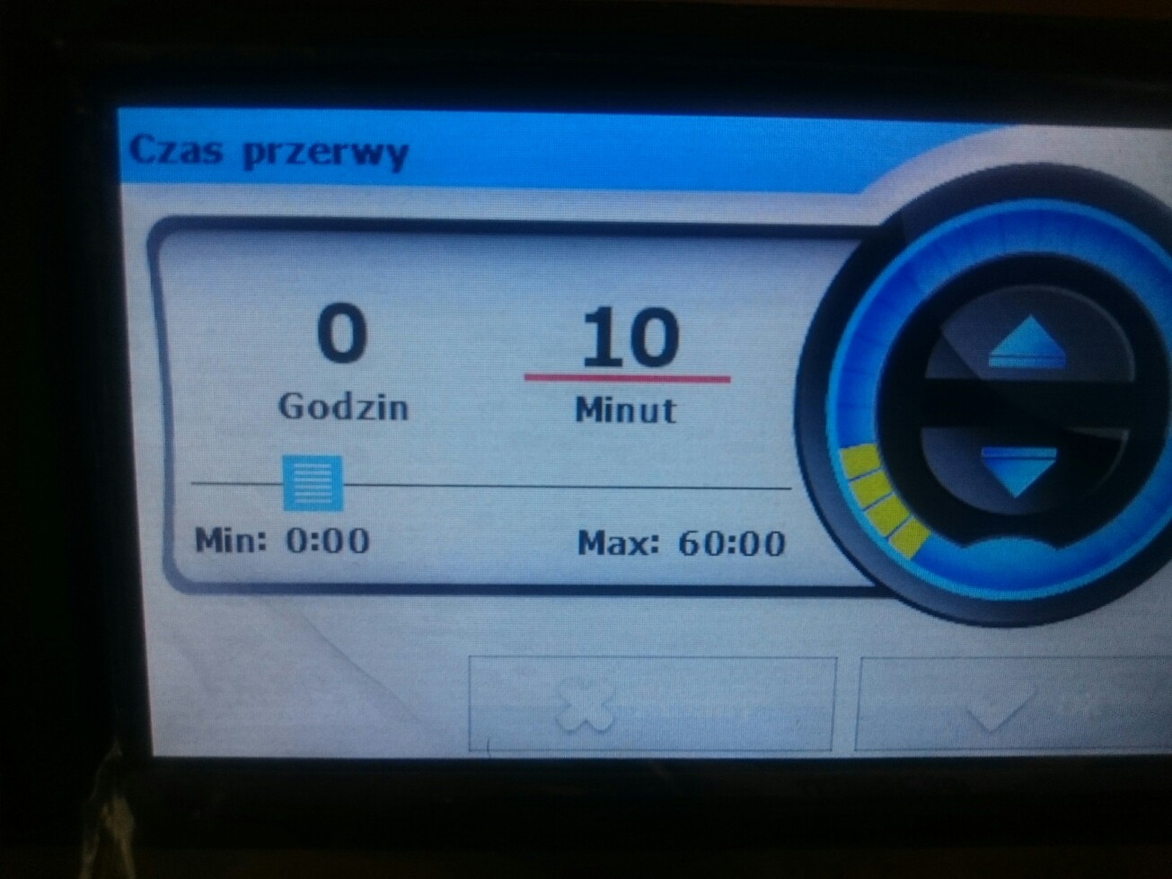

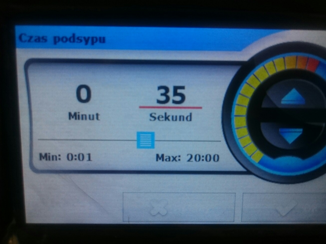

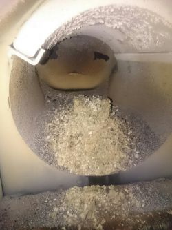

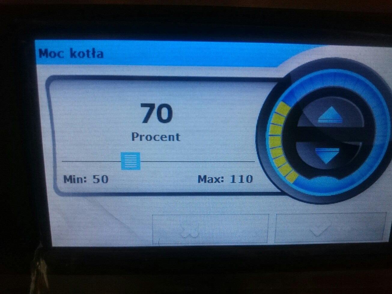

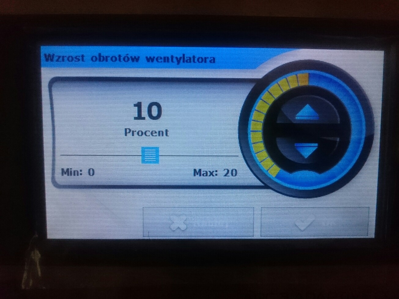

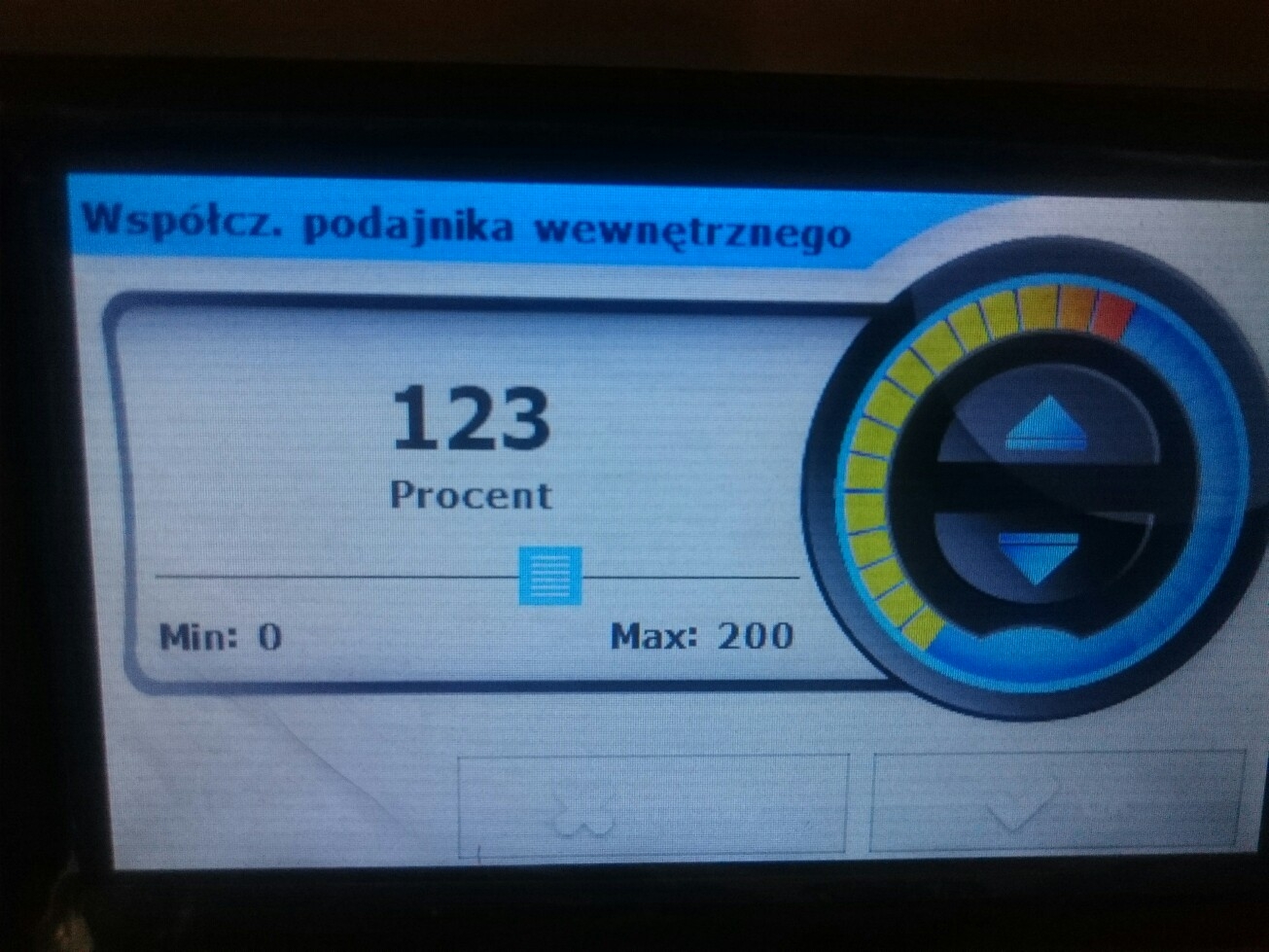

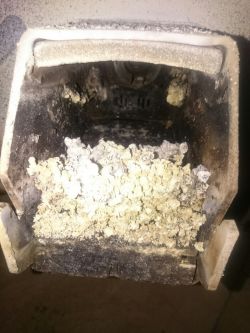

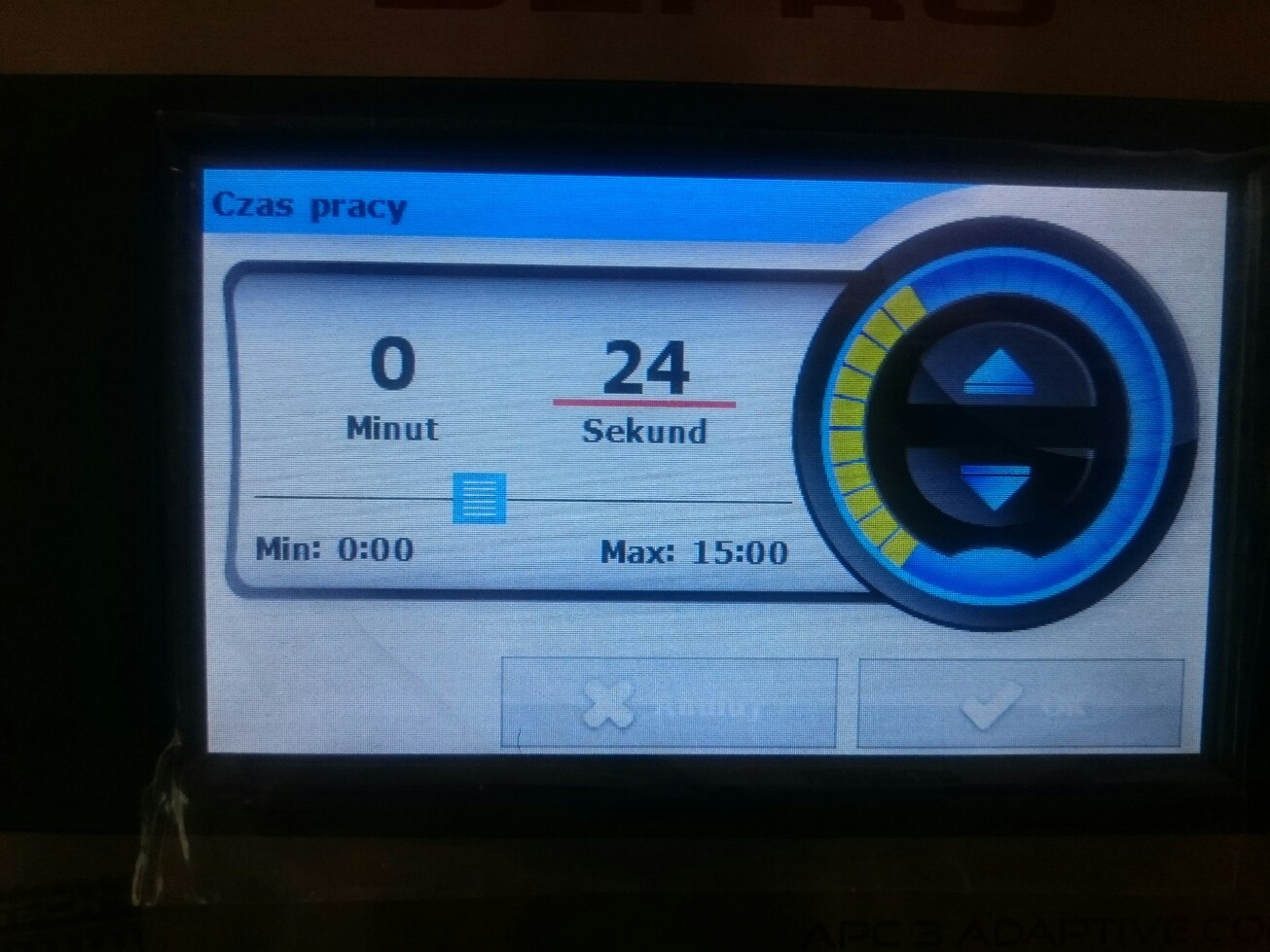

    10kw. Loss of fire during work. Source - burner.
    Installed, just inserted radiators.
    The parents have the same and from them I have the parameter in the pictures below.
    After 2-4 hours, the fire disappears. The instruction claims that there may be pellet wine and it may be worth removing the firewall at the end of the burner, so I did, but it's still the same.
    Here the fire disappearance message,
    In the next photos there is also a firing up error right after I clicked "ok" in the morning after a fire failure error. Defro Bio Slim 10KW: Fire Loss During Operation, Burner Issues & Troubleshooting Tips
    Photos :
    Defro Bio Slim 10KW: Fire Loss During Operation, Burner Issues & Troubleshooting Tips Defro Bio Slim 10KW: Fire Loss During Operation, Burner Issues & Troubleshooting Tips Defro Bio Slim 10KW: Fire Loss During Operation, Burner Issues & Troubleshooting Tips Defro Bio Slim 10KW: Fire Loss During Operation, Burner Issues & Troubleshooting Tips Defro Bio Slim 10KW: Fire Loss During Operation, Burner Issues & Troubleshooting Tips Defro Bio Slim 10KW: Fire Loss During Operation, Burner Issues & Troubleshooting Tips Defro Bio Slim 10KW: Fire Loss During Operation, Burner Issues & Troubleshooting Tips Defro Bio Slim 10KW: Fire Loss During Operation, Burner Issues & Troubleshooting Tips Defro Bio Slim 10KW: Fire Loss During Operation, Burner Issues & Troubleshooting Tips
    Scavenges at work
    Defro Bio Slim 10KW: Fire Loss During Operation, Burner Issues & Troubleshooting Tips [/url] [url=https://obrazki.elektroda.pl/2480895000_1539332834.jpg]

    Haslowygaslo
    Posts: 15
    Rate: 27
    The problem seems to be solved - the ballast was for 35s (larger than standard), I changed to 30s and from that moment there was no fire disappearance. Probably too often ballast pushed burning pellets into the chamber and put out the fire.
