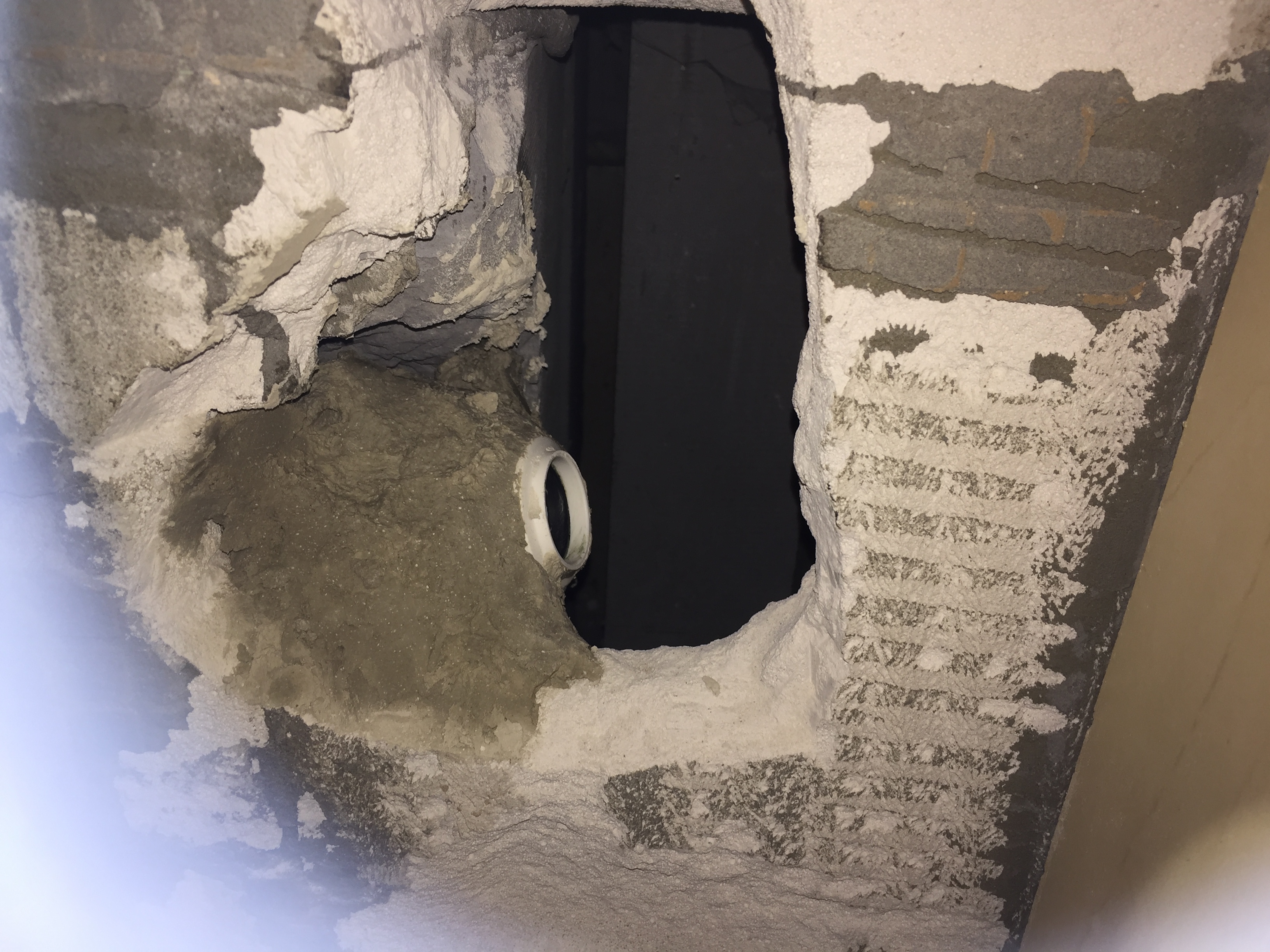

    Scorpion_1982
    Posts: 269
    Rate: 27
    Gentlemen, two days of lying on the tiles and hammering the wall with a screwdriver and I'm at this stage:
    LG F2J6TY1W - Drain from the washing machine to the drain of the bathtub LG F2J6TY1W - Drain from the washing machine to the drain of the bathtub LG F2J6TY1W - Drain from the washing machine to the drain of the bathtub LG F2J6TY1W - Drain from the washing machine to the drain of the bathtub
    Two tiles couldn't survive they held up like hell.
    I made a drain on a 50/50 tee
    Reductions to 32mm and the drain of the washing machine is not finished yet, also 32mm because I had no chance to push another one there.
    I connected the pipe from three pieces of 50 cm, otherwise I would not have put it under the bathtub for inspection.
    The pipe is plastered on one side, I will now have to somehow lead it above the tile and now three questions.
    1: What to seal this damn hole with. Attaching the tube?
    Two how to protect elbows and connectors from accidental disconnection?? - in some places I used wire, in others tritki.
    Quite some elbows slightly go in and out of each other, I lubricated the seals with dishwashing liquid when assembling.
    3. Should the pipe be supported, e.g. so that it does not bend or unseal? There's not much to put your hands in there and I don't know what to rejuvenate.
    The tightness test of the sink and bathtub is ok, the tightness of the washing machine drain has not yet been checked..
    Thanks alot

    Wow, good job, that looks nice :)
    (Now I saw where you are from, give my regards to Krościenko on Dunajcem :D )
    Scorpion_1982 wrote:
    ... lead above the plate ...
    I don't really get it, the cup itself in which you will plug the washing machine drain do you want to put over the tiles?
    Personally, I would come out of this tube with an elbow of about 45 degrees, towards the right corner, slightly raised up. Although it also depends on how much space you have for the washing machine.
    You could also pierce the aerated concrete to the very right corner, add a short piece of pipe and then a 90 degree or 67.5 elbow. So that the back of the washing machine does not take up space for the drain, more than is needed.
    Gypsum, tile adhesive, drywall adhesive, including bending :)
    I don't think they will unfasten/unsealed, but you can fasten them for peace of mind.
    At the siphon, you have already dealt with the matter, the only section that raises doubts is the unsupported part in the building, between the siphon and the hole on the right, here:

    Gentlemen, how to embed a pvc elbow in a wall,
    I have a bigger hole, I have to pre-fix it so that it doesn't stick out too much later on the tile.
    I tried building gypsum but I can't even apply and adjust the elbows and the gypsum is already binding so it falls off.
    Gypsum putty is only 5mm thick.
    Was there still a gypsum cement mass or something like that?
    What do you embed it with, e.g. electrical boxes etc.
    I want to pre-glue it, I'll make the rest with cell blocks and tile glue, unless it's necessary otherwise, tell me that I wouldn't make a cuckoo.
    I also greet the neighbor. (Steam)
    I have a pipe between the bathtub and the wall for the moment
    Thank you very much. LG F2J6TY1W - Drain from the washing machine to the drain of the bathtub and
    I wouldn't care too much about it, mounting foam, hose and wio :)
    The elbow will be in that hole in the upper right corner?
    How would I do it - adjust, cut the tubes, ready elbows, ready to fold, it should hold, but if it is still loose, support it with something, temporarily.
    At the last elbow, first apply a small amount of building gypsum, so as to fix them slightly, even at one point, wait until it hardens. Again, a small amount of plaster to fix it better, little by little until the elbow is stiff enough to brick up the remaining hole
    By fixing with plaster, you make larger and larger portions with each approach.
    P.S
    Personally, I attach things such as cans or elbows and pipes to plaster.
    If you don't manage to make plaster, do it less and thinner, it will bind anyway.
    There may be a way, I don't see any obstacles :)

    Yes, the drain will be in the upper right corner - I already have the tubes released.
    I always placed half of the cans on the construction plaster and the top was already traditional or it depends on what I finished the wall with and this material drinks water like hell.
    I will try to prime it with a deep penetrating soil, maybe then it will not take water from the plaster.
    Gentlemen, should the cup of the tube be flush with the plate or can it protrude 2-3 mm??
    Very good idea.
    Maybe even more, but then it takes up space for a washing machine, if you have the opportunity, make it evenly +/- a few mm.

    Gentlemen, I initially foamed low-pressure foam, not everything but the pipe on the sides, now I will put a hollow brick on the atlas in front and I think it should be.
    Now I'm wondering if I shouldn't drown the entire tube in tile adhesive.
    I removed the excess foam, I wanted it to catch the tubes and the side a bit, I wanted to seal the hole at the top with foam but I would have to wait a lot because it couldn't be done at once.
    I added a cellular brick, or rather a 4 cm strip - in it you cut out places where it blocked me - I folded it on tile glue, I gave quite a lot of it for the foam itself, also for the brick.
    I moistened the block with water so that it wouldn't drink too quickly and the rest was primed twice.
    A bit of glue sucked but I will complete it with the tiles because I will still have to do it to the spirit level, someone made a simple building.
    Gentlemen, I finished thanks a lot for the tips - only the hole I had to cut out because I had nothing.
