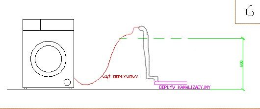

    Hello. I am asking for a hint which of the following methods is correct and which is the best.
    How to install a washing machine drain correctly – which method is best?
    Thank you,
    Damian

    In my opinion method 6 is the best.

    No. 3.
    And what does the washing machine manual say?

    Washing machine occasionally bought - no instructions.
    Sometimes the hose itself does not function as a siphon (fig. 5) and adding a siphon as in fig. 6 is unnecessary?

    From this it follows that fig. 3 is correct. You need a siphon, but there should be air access, which will work by inserting the hose over the edge of the washbasin.

    I recommend method no.3 the most used and effective

    I used method 6/3 - "almost" tight connection. Between the hose and the rubber reduction I pressed a paper clip bent into an elongated U. Thanks to this, it does not smell and it stopped drawing water from the washing machine, as it happened with a completely tight connection.
    Method 3 does not always work. If the siphon flow is too slow, water may leak at the point where the hose is inserted into the drain pipe.
    If the inlet to the sewer pipe is at a height of 50 - 80 cm, you can use a siphon as in the picture above (tight, secure and easily dismantled connection), or a hose directly to the pipe but it must be tight (reduction gaskets 50/32, 50/25 are available) , 32/25 - depends on the diameter of the hose and pipe; the best pipe is 50mm, because then there will be no water suction, and if 32mm, it is a dozen or so cm at most and then thicker).

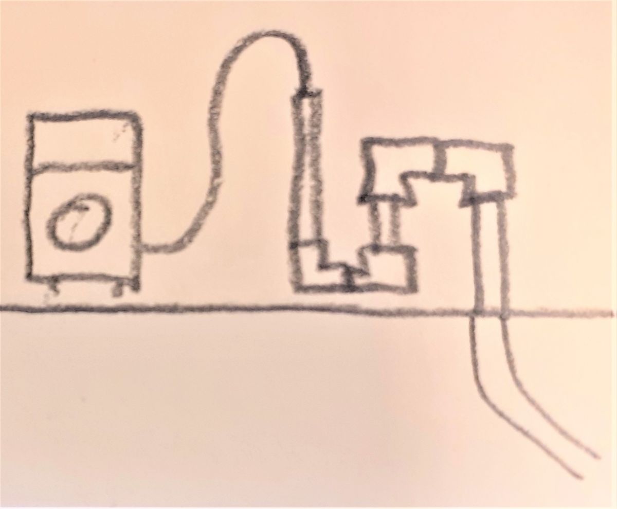

    I have a similar problem - a drain in the floor, but I have the ability to raise it.
    I would like to do it like this - put a 45° elbow in the drain - a horizontal pipe - a 45° elbow - a vertical pipe - a 45° elbow and a washing machine hose in this elbow.
    Will it work?
  • #11 20479059
    Sebastian_M26
    Level 30  
    Posts: 1341
    Help: 130
    Rate: 436
    Pipe-90st-90st-pipe-90st-90st-tube-rubber reducer for washing machine hose.
  • #12 20479078
    bartosz11
    Posts: 30
    that yes?

    For a sewage pipe, if it is a 50mm pipe, it is best to use an elbow: https://m.leroymerlin.pl/hydraulika/kanalizac...e/redukcja-50-x-32-mm-90-biala-equation,p8515, l671.html do kolanka zastosować syfon: https://www.mediaexpert.pl/agd/akcesoria-agd/...KDXm_ogJiBU6Zup1GE3i8VfbY-LXNc4kaAnL3EALw_wcB lub w taki way: https://youtu.be/hyJHRGQAaf4
    If you do not want to use a siphon, it is best to attach a drain hose behind the washing machine to create a U-shape.

    Why all these gimmicks? If I understand the drawing correctly, the exit from the existing sewer is up. So insert 50 cm of vertical pipe of the appropriate diameter. To her:
    - reducing gasket and washing machine hose or
    - 90° elbow, washing machine siphon and washing machine hose.
