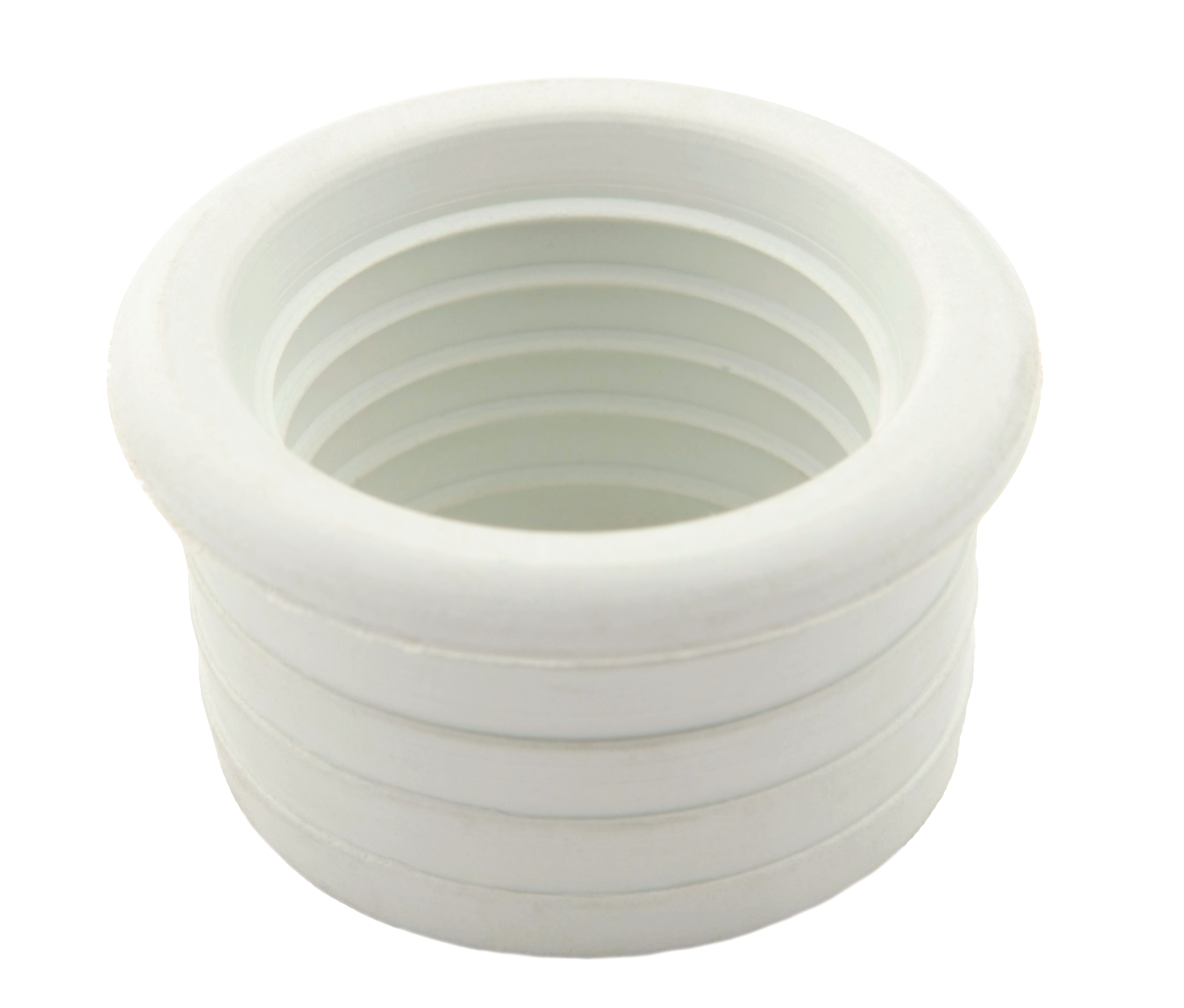

    In the wall at a height of 55 cm I have a PVC pipe with a diameter of ?32 mm. I would like to connect the drain from the washing machine to it.
    Can I do it directly through a 32/25 reduction gasket? About such:

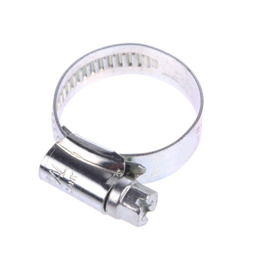

    The seller in the fittings store advised against this solution and recommended a siphon because an additional metal clamp can be attached to the hose:
    Connecting Washing Machine Drain to 32mm PVC Pipe: Evaluating Gasket Reduction vs Siphon Method
    The seller claims that the hose may fall out of the reduction gasket. I find it hard to believe, but I'd rather not have to replace the hardwood floor if that should happen.

    So I would like to connect via a 32/25 reduction - the cable fits perfectly for this approach, only this seller scared me that it might fall out, I bought such a reduction and it seems to sit very tightly on the outlet duct of the washing machine. Come on, be smart here. Do you have any experience with connecting directly via 32/25 reduction?

    In my opinion, it should work without any problems, for greater safety you can remove the gasket from the elbow and press it onto the hose on which you can add a band and then press it into the elbow. Even ordinary ties should prevent the hose from slipping out.

    Fi32 to the pipe from the washing machine, it may be too short. A narrow tube may not discharge the water under pressure and the hose may fly out if it is just pressed into the rubber reducer.

    Connect through a siphon, it will guarantee a proper hose seating, i.e. version 2 or 3 from the picture, as you prefer there.
    For the first option, the pipe diameter in the wall is too small and carries the risk of the hose popping out, as it cannot be inserted well and deeply behind the elbow.

    It is not a question of water pressure, but of the inability to fit the hose properly in such a drain, you will not push it behind the elbow.

    Eventually I connected via way 2 :) I tried method 1 but it was impossible to press it. I talked to someone who works in the service - they recommend removing all balls and springs from the washing machine siphons because they create additional resistance for the pump - I did just that at home.
