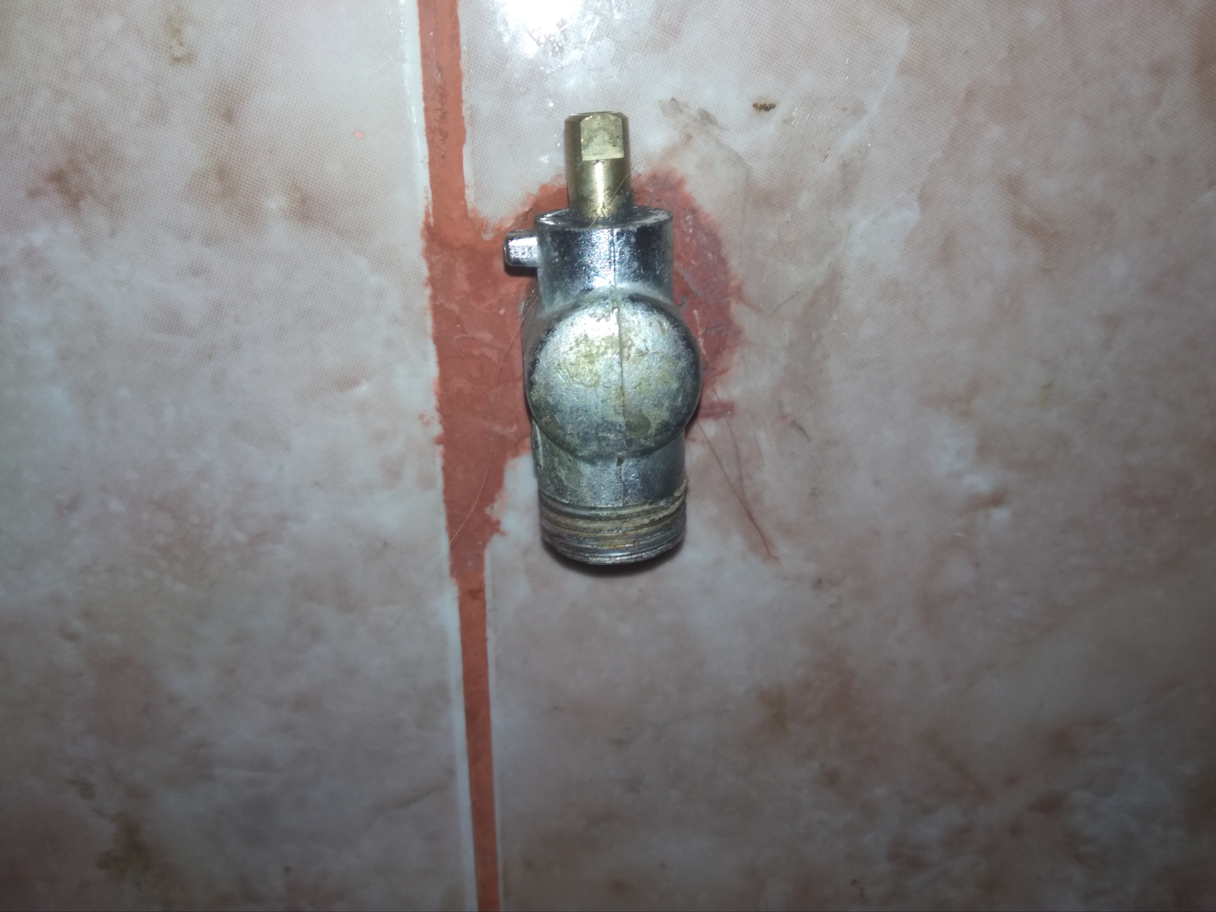

    I have a problem because water is leaking from my elbow, and I do not know how / how to unscrew it to replace it and also not to spoil something more.

    the so-called Frog or adjustable wrench. It is not an elbow, it is a valve. Unless it's an elbow in the wall. You will need two wrenches in total, with one you should hold the stub sticking out of the wall.

    I suggest using even two "frogs" and one to hold the pipe sticking out from the wall.

    Of course it can be unscrewed with an ordinary hydraulic wrench.
    First turn off the water in the apartment because you will have an unpleasant surprise.
    You know, unless we unscrew it to the left. (it's just a reminder)
    ciuqu wrote:
    one to hold the tube sticking out from the wall.
    What?!
    After all, all that is sticking out of the wall is a valve.
    Don't tell stupid things.

    Yeah fact :) it would be worth scratching the grout around the valve a little.

    Or even shoe up to the fitting into which the valve is screwed.
    Exactly.
    Covul wrote:
    Or even shoe it to the fitting into which the valve is screwed.
    To do some work?
    The fitting is probably sitting in the wall and nothing should happen. Worse, I would have to worry that the valve would not break and the thread in the wall would not remain, because these types of valves only look nice and are quite delicate and the durability is tragic.
    Before playing, turn off the cold water on the main valve in the bathroom and turn on the cold tap in the bathtub and let the water run out of the pipes - there will be less wiping. Therefore, in the bathtub, because this tap is usually the lowest.

    And in my opinion, this valve is screwed into the extension, which in turn is screwed into the elbow or the tee in the wall. Therefore, you need to hold the extension with one key to unscrew only the valve itself.

    Just to hammer the wall and tiles again to get to the extension: / I will take the risk and hope that if there is a tee in the wall and it will not unscrew.
    Your opinion is wrong.
    Added after 37 [seconds]:
    blackwolf7 wrote:
    I hope that if there is a tee, it is in the wall and it will not unscrew.
    Nothing is allowed to move in the wall.

    Of course, the wall has the right to move or even break off, it does not have to be a tee and it does not have to be galvanized, it is not known who did it. Unscrew sensitively.

    A typical cast iron fitting would have a flange at the end. And here you can not see it, So that the valve will not be screwed into the elbow or the tee. There is an extension, reduction or a muff, which can be made of steel or brass. So, when unscrewing, I would try to grab the element protruding from the wall and there is not much of it to grasp. And there may be a plastic pipe in the wall.

    I unscrewed this elbow without holding the extension because I would have to knock off the tiles and walls a bit and I think nothing moved because you can't see any leaks, so I think it works and thanks people for your help :) But I have one more question, taking advantage of the opportunity, because now I heard at night how the water was dripping inside the tank all the time, and the frog is not running water in the shell, so I don't know what's going on. Unless it leaks into the shell but so slowly that you can't see it? Anyone know what this might be about?
