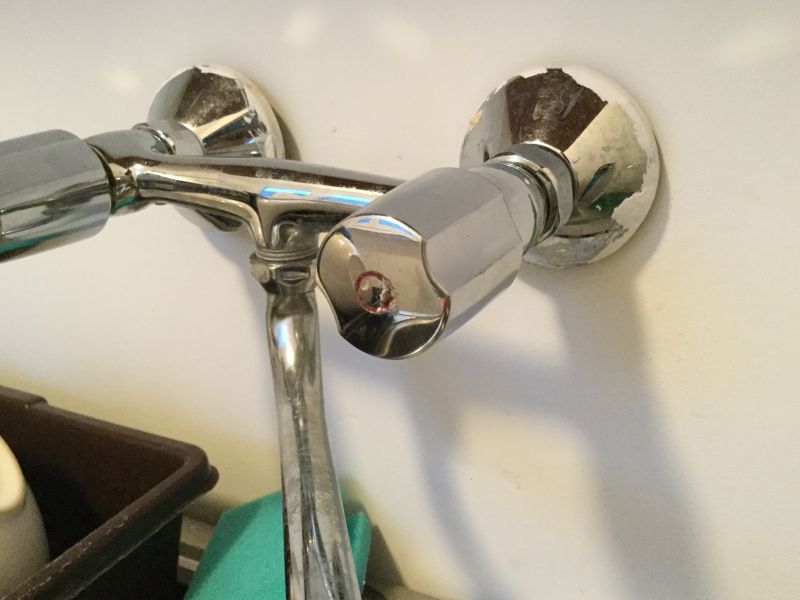

    Hello. The question is probably trivial, but it is leaking from the tap and I would like to replace the gasket. Unfortunately, I do not know how to unscrew the tap (I attach a photo). I tried to pry this metal element around the red ring - to no avail. Someone could lead me on how to dismantle it

    You need to unfasten it and you have a screw under it. After unscrewing it, the whole knob will come off.

    Do not pull this middle element out of the red ring but the ENTIRE red ring with the metal one inside. After unscrewing the screw, if the tap does not want to go down, you need to squeeze some WD penetrating fluid inside, wait some time and it should go down.

    Are you sure this is how to do it? I'm starting to dig there slowly and nothing ... and I would not like to destroy it. How to Unscrew and Replace Leaking Tap Gasket: Step-by-Step Guide for Tap Dismantling

    Unfortunately, you can't take it out. This red ring looks like some plastic filling, not a round element that can be removed.

    Once these "measures" were also screwed into the knob. The other thing is that I probably saw the whole knob just by push. They brought various solutions for scrap metal.

    I really don't have an idea. It does not look like a standard plug that can be undermined and after a problem. It sits too deep, and any attempt to undermine it makes it more and more damaged - if I could somehow remove it after mounting it certainly would not look the same.

    This is the domain of disposables.
    You have a camera, a mirror, look from the back or you won't see the spring. It is worse when nothing is visible, and yet it is pressed, the more I think, the more I think of a plastic latch that will not survive taking off.

    Unfortunately, I have no way to look back from there.
    I can't take it off ...

    The matter cleared up. I pulled with all my strength from side to side and went down, so he was pressed.
