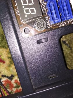

    I have a serious problem.
    I have a broken screw that secures the motherboard to the case. But it's broken and I can't twist it? What to do? I urgently need help as I have sold my motherboard and have to ship it tomorrow. Unscrew Damaged Phillips Screw: Tips for Removing Broken Motherboard Screw - Urgent Help

    Hello. You can use a small wrench to unscrew the threaded sleeve from the bottom or a small drill and drill it.

    A flat screwdriver properly fitted and an attempt to unscrew.

    On the other hand, it looks like this:
    Possibly what size drill will be needed from the smaller ones?

    In such situations, I use small but very sharp front cutters. I put the tip into the treated hole and the other outside and try to unscrew it.

    This screw is definitely a cross? Looks like a torx with a hole

    Drill with the diameter of this screw and drill. You have a screw that has been processed so that even a flat one will not unscrew it.
    The diameter of the screw.

    You have to be a specialist to make a screw like this.
    A 2-2.5mm drill bit and a screwdriver, with a drill you have the risk of damaging the drill bit.
    For a trained hand, it is a few moments of work.

    I had an idea with a soldering iron. What do you think about soldering and then trying to unscrew it? It makes sense?

    And the tin for the screw will grab hold of you and the display next to it and the plate will no longer be for sale.
    Added after 4 [minutes]:
    If you are afraid to drill from the screw side, drill the sleeve from the bottom.

    This has a lot of thermal inertia, you would have to solder with a gutter soldering iron.
    Provided if it can be soldered at all.
    And you risk damaging the PCB very much. In a word, unprofitable.
    Better to try to unscrew the tweezers from the top.
    You can also grab with cutters like pliers and twist. These screws are not hard and the sharp cutters will jam.

    Soldering is not required because the strength of such a connection is equal only to the strength of the tin, the more so as the tin solder will be loaded to torsion.

    Special bits for loosening. They are shaped in such a way that they do not even pop out of the formed screws when turned left.

    Just use the pincers with a side cut, squeeze well and twist in the direction you want. None has resisted yet -)

    There is also something like a "Russian key", that is, a gentle hitting of a hammer on the shaft of a screwdriver or a sharp chisel applied diagonally to the head of the screw. Of course, put the bolts on the edge and hit in the direction of unscrewing.
    All this, in line with the old saying of locksmiths, "nothing by force but a hammer" always works.

    use a small drill with a left twist, while reaming it will heat up the screw a bit, it should jam in it and unscrew it

    As someone wrote, I unscrew with pliers with a side cut, only sharp must be.
