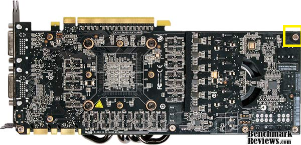

    I have a problem with my graphics card.
    One screw did not want to unscrew and was unfortunately knocked out. Now the square looks more like ... and not a cross.
    How to unscrew it now?
    Will I find someone in Warsaw who will undertake it?
    As it is electronics, I do not see any way to use more forceful means here - so as not to destroy anything.

  • #5 9238934
    kad2
    Posts: 22
    The screw sits directly on the PCB of the card.
    Nothing could be unscrewed, it sits tight.
    Preview photo, the screw is yellow.
    Its grooves are broken.
    It is GTX480.

    From what I can see, it is possible to either grab the screw head with new sharp side pliers and try to unscrew it, or even try to get under it from underneath to undercut it. It seems to me that even if we would partially damage the CD, if there were no tracks and elements (in this area) in it, it would still work.

  • #9 9239713
    Stary1952
    Level 32  
    Posts: 1829
    Help: 164
    Rate: 242
    Hello .
    I personally have two screws for these screws:
    - a suitable wide, very sharp flat screwdriver, press it into the broken cross socket of the screw
    - gentle boring (preferably with a screwdriver) of the screw head
    Good luck .

    Just drill down, the copper print at this point is the mass of the chip.
    After removing the head, you can twist it out with pliers.

    A colleague is right, the only thing that is a screwdriver, a drill, and after the case, after drilling, the card will come out normally and you will unscrew the rest of the pin from the screw by hand, this is the fastest and sure way, that's how I did in the laptop and I recommend it

    I recommend using the left drill bit to countersink the head of the screw. Often, when drilling, the screw is unscrewed.

    -there is no way to approach this screw with anything, you would have to pick the PCB in order to approach it.
    The screwdriver ... does not have this.
    Should I really drill into a delicate PCB with a screwdriver?
    The idea is to take it out WITHOUT damaging the PCB.
    I cut the screw on one side with hacksaws deep, but it doesn't go.
    If there is someone brave from Warsaw, I will pay for the service of twisting it.
