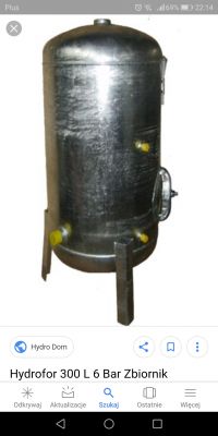

    I have a galvanized tank 300l 0.5MPa. How much air to fill when it should turn on and off...

    I have a hydrophore in the basement, water will be taken to the first floor
    I have a hydrophore and a tank in the basement and the water will be collected on the first and second floor
    Added after 35 [minutes]:
    I have such a tank Galvanized Tank 300L 0.5MPa: Air Fill Quantity & On/Off Cycle Guidance

    You can do this:
    Turn off the pump
    Run water until you hear air escaping.
    Close the water outlet
    Inflate air to approximately 150-170 kPa
    Turn on the pump.

    The justification is quite simple.
    To ensure that we use the maximum capacity of the hydrophore
    we need to set the pump to turn on when the mirror is already quite low, but not against the background low so that the air escapes from it.
    You can pump it up to the stick, but either we will get a small amount of water between starts, or for some time after pumping, before switching on the pump, it will shoot air from the taps, and by the way all the crap torn off the walls of the pipes.
    If we give half a bar of reserve until the air starts to escape, we are sure that the pump will be able to turn on and replenish the water before the outflow pipe is uncovered.

    two floors of approx. 3m each plus ground floor and basement.
    Together you have 12m or 1.2bar
    If you want 1.5 bar at the top tap, the pump must start at 270 kPa
