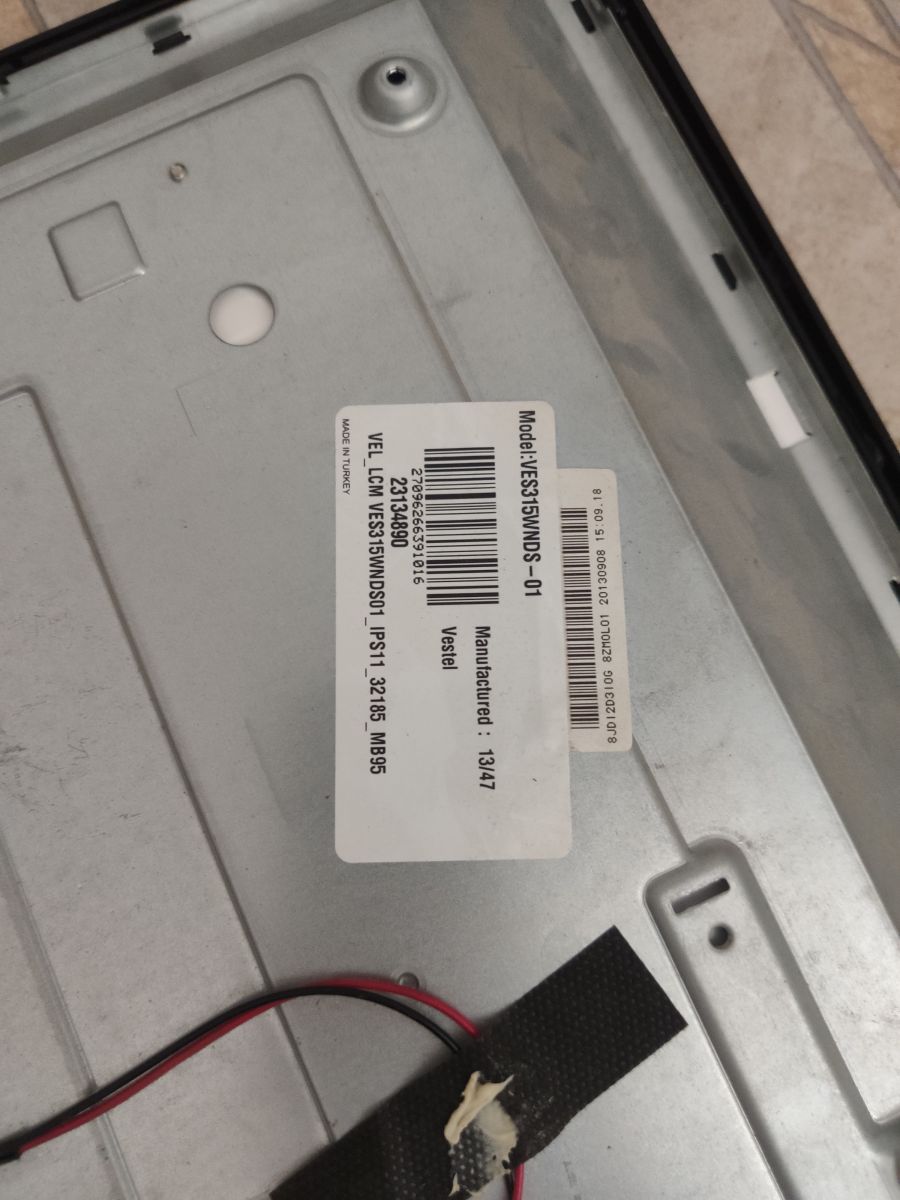

    MarinF wrote:
    Quadro
    LED32HN40
    23127043
    23134890
    it's a Vestel: mainboard 17MB..? panel VES315WNDS-01?
  • #28 18820774
    MarinF
    billobirillo wrote:
    MarinF wrote:
    Grundig 32VLE7322BH
    VXP190R-4
    3L320052030A
    AML32HN003SSF
    40602781
    label photo on the back is required
    MarinF wrote:
    Quadro
    LED32HN40
    23127043
    23134890
    Yes, for Quadro it is that board and panel. Do you have dump? Quadro is my priority, for Grundig I will send photo.
  • #29 18821051
    billobirillo
    Posts: 1141
    Help: 338
    Rate: 794
    ok, but which mainboard?
    there are at least 20 types of mainboards (for ex 17MB60, MB61, MB62, MB60-4.1, MB82S, .......)
