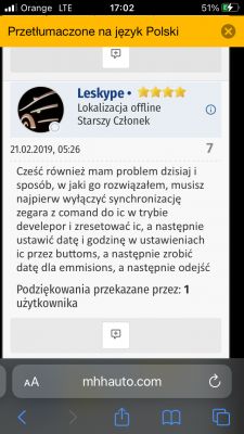

    Mercedes W211, 2004 on the counter screams to do an exhaust inspection and the main one as in topic. I deleted the tester, basically changed the date, moved manually from the meter, approved the services and inspection, and the inspection continues to display on the meter. How to beat it once, previously it was deleted without a problem.

    Hello, I have exactly the same problem. In many ways I tried to remove these messages and nothing. A friend of electrician told me that the problem lies on the side of the meter. Also the date I have in the navigation next to the watch, 1976, which is not going to change is strange. you a similar problem? Regards.

    Error in the navigation software. The system misinterprets the date taken from the GPS. We must wait for software updates.
  • #6 17612002
    Lu79
    Hello. I managed to get rid of annoying review messages. It may not be a complete success, but I am no longer annoyed by the sound of messages calling for a review and now the display has a beautiful inscription "No Malfunction" The problem was in my case that in navigation, it is not known why the date 1976 was recorded, I changed the date in the clocks (counter) to 1978 and after that. Regards.
