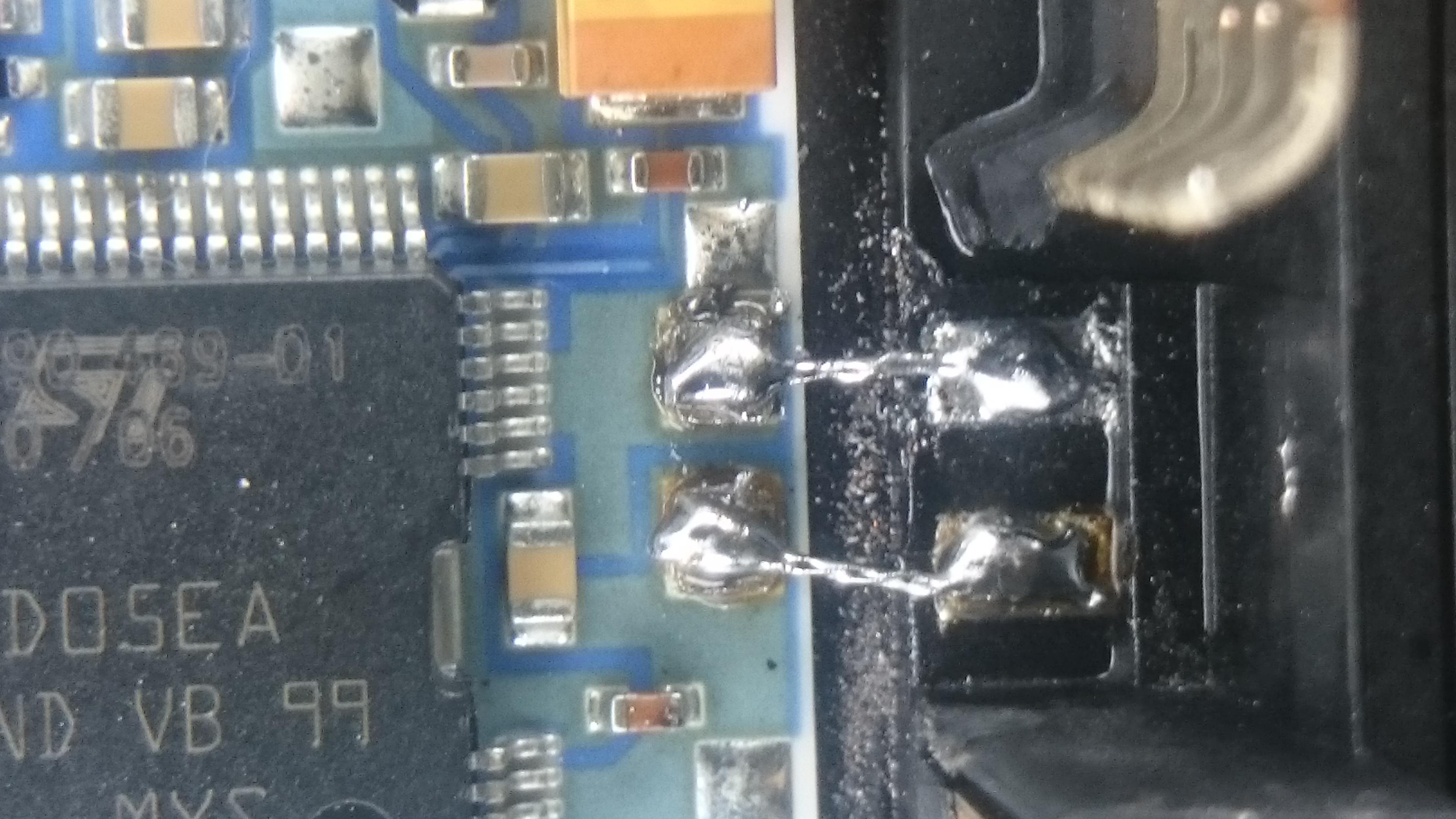

    For me the chain ended at 200tkm, the tensioner was not able to tension it anymore (duplex chain) OM642.
    From what I observed in my, and everything falls in this engine in turn (Folded in the USA),
    this engine jerking during acceleration only causes incorrect boost pressure.
    The first time it was a collapsed dpf, and the second it was cracked wires in the turbo adjuster.
    And here you can see through the oil filler plug the tensioner extended to the max (200tkm)
    Mercedes C320 CDI (W203 2006 - Error P2616 - temporary lack of engine powerDSC_05..JPG (2.83 MB)You must be logged in to download this attachment.
    • Mercedes C320 CDI (W203 2006 - Error P2616 - temporary lack of engine power DSC_0229.JPG (2.02 MB) You must be logged in to download this attachment.
