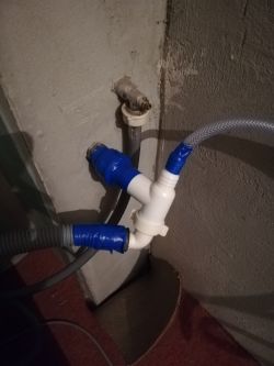

    Hello, does anyone have a patent on how to connect a condenser dryer and a washing machine with only one sewer inlet in the wall?
    Diameter in the wall 32mm
    Hose dryer 11 / 8mm
    25mm washing machine
    Below is a photo of my makeshift. I am afraid that the water from the washing machine will go to the dryer and vice versa ... How to make a connection for both having one inlet in the wall.

    One-way valves could be used to prevent water backflow.

    Or maybe something like that, one PLN 29 another 100
