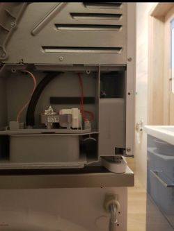

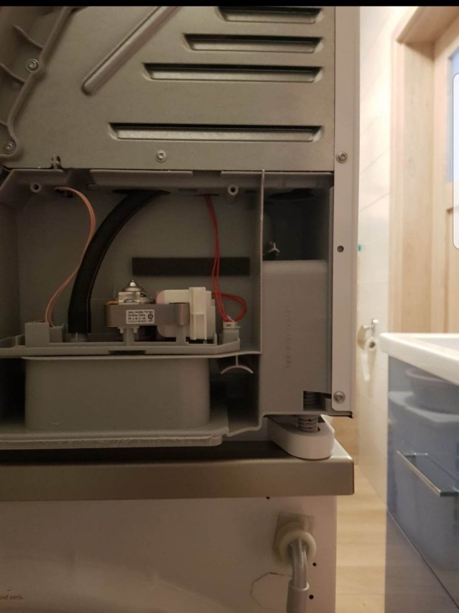

    #13 19097709
    GruchaKG
    Posts: 6
    Hi,
    Today I called the service, because in my case the back of the dryer (WTX87K40PL) did not agree with the instructions and I did not know how to connect it, but I found out that this hose, which goes from the bottom of the pump up to the drawer, should be disconnected from drawers and hit the drain. The dryer first fills the drawer internally, uses this water to rinse the condenser and then pumps it out to the drain / our channel.
    So the version written by Rivee is generally confirmed.

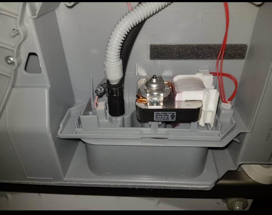

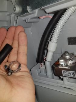

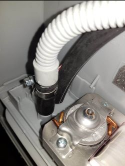

    #24 20504982
    bht
    I purchased a Bosch WTM852MSPL dryer and managed to connect the drain to the sewage system without damaging the housing. I checked when the pump is working. It turned out that after turning it on, it pumps out the water that is in the tank. The water coming from the clothes goes to the tank at the bottom with a pump, which from time to time is designed to pump excess water into the upper tank (removable) in order to clean the condenser. I did so that I connected the pump to the drain, and every few dryings I add demi water to the upper tank so that the condenser is cleaned from time to time. I prefer to add this demi water from time to time than to empty the water container every time after drying.

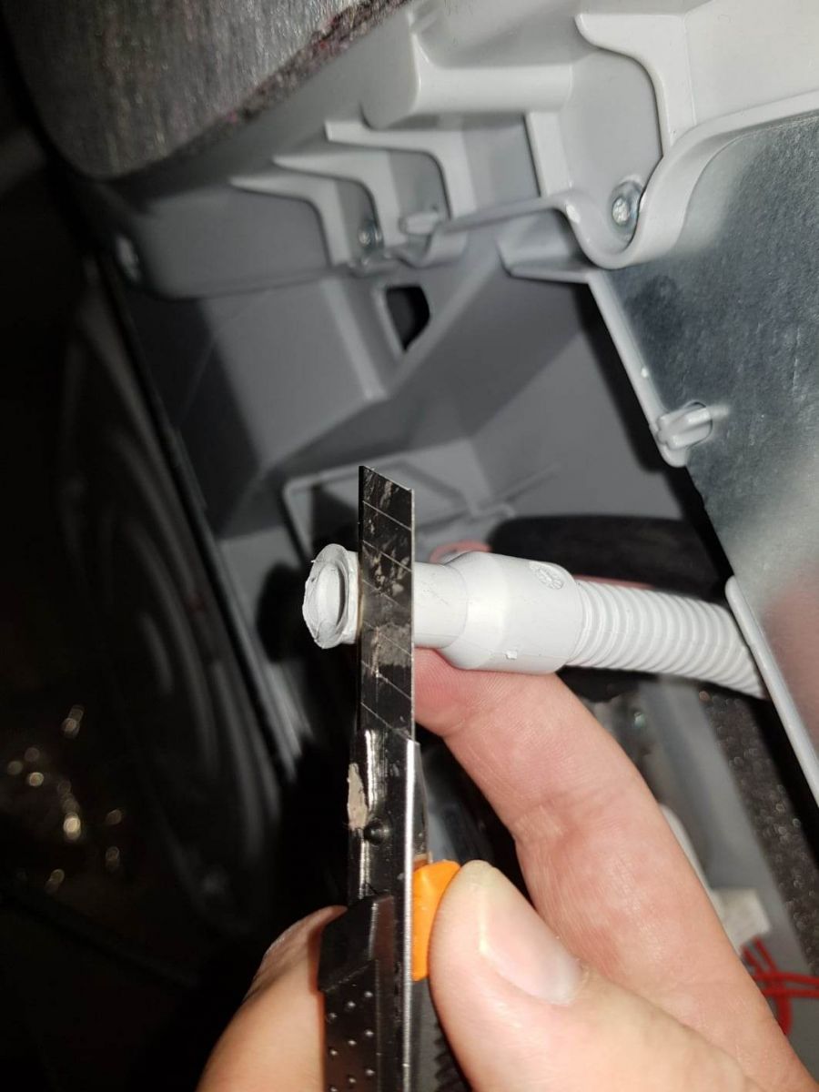

    #25 20786895
    Jan_z_Czarnolasu
    Posts: 6
    Rate: 8
    I've had the dryer since yesterday, and there was a premiere this morning.
    Of course, I connected the hose to the sewage system and placed the cap at the bottom upwards. The water tank is full.
    And what about this filter next to the triangular hole? Do I need to do anything with it? I didn't see it in the manual. But on the tank, above the place for the cap, there is a second place that perfectly fits this filter (flat). Should I put it there?
